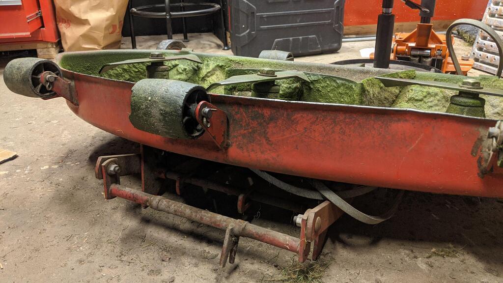

BigDaddyO 11 #1 Posted June 20, 2022 (edited) Hello, I'm wondering if the blades on the mower deck are supposed to be flush with the bottom of the mower deck lip, I assumed they should be recessed about 1/2 way up. I just tried my mower for the first time yesterday and it was scalping my lawn pretty bad even with the mower deck height adjustment set to the highest level. I ended up finishing the lawn by raising the entire mower deck using that lifting arm on the left of the tractor. Thanks for any insight. Mike Edited June 21, 2022 by BigDaddyO Photos Added Share this post Link to post Share on other sites

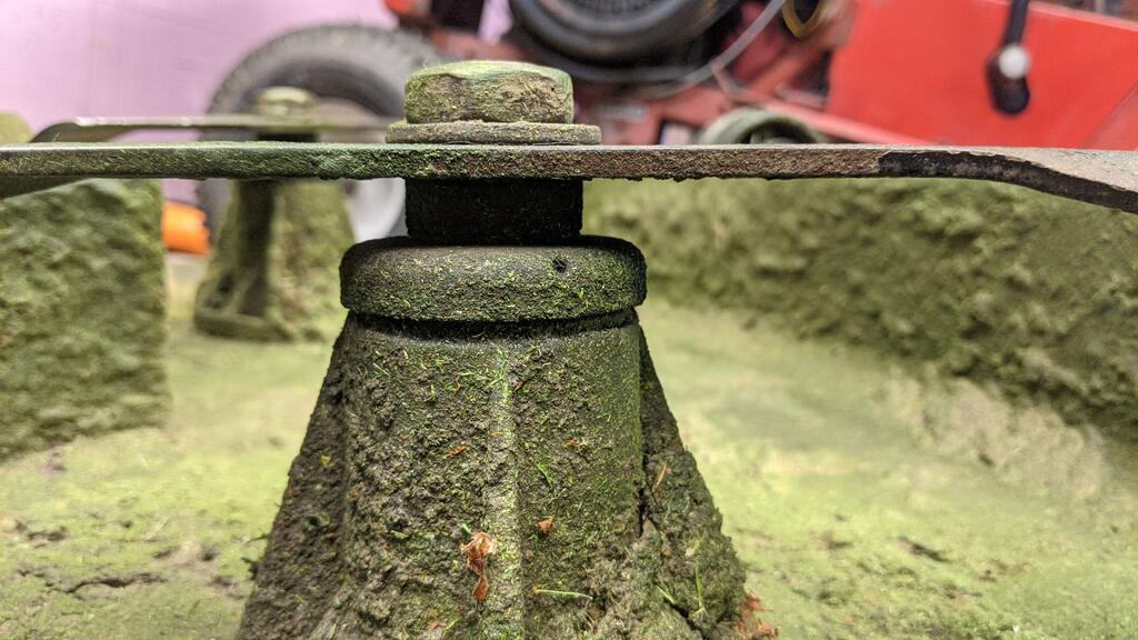

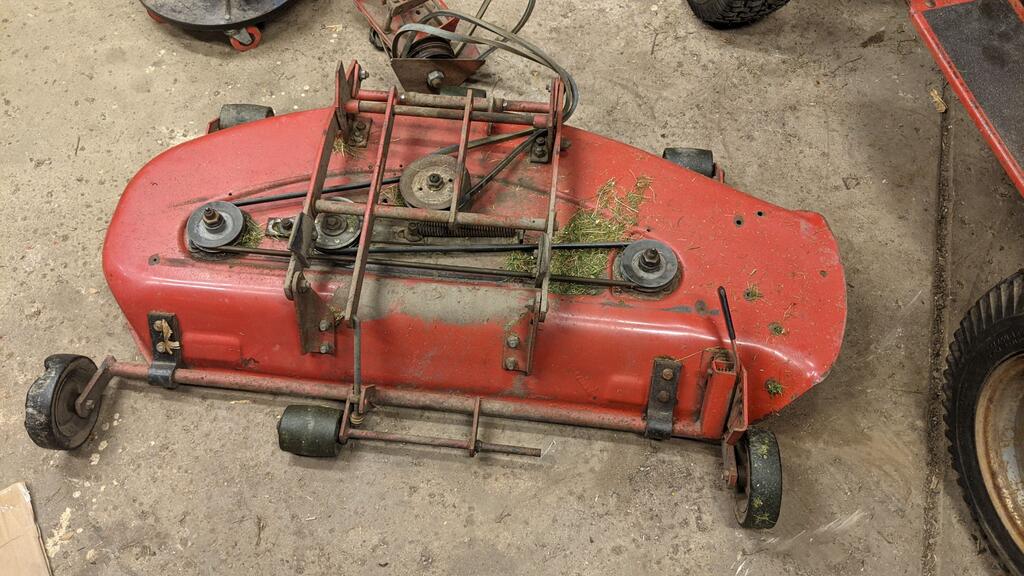

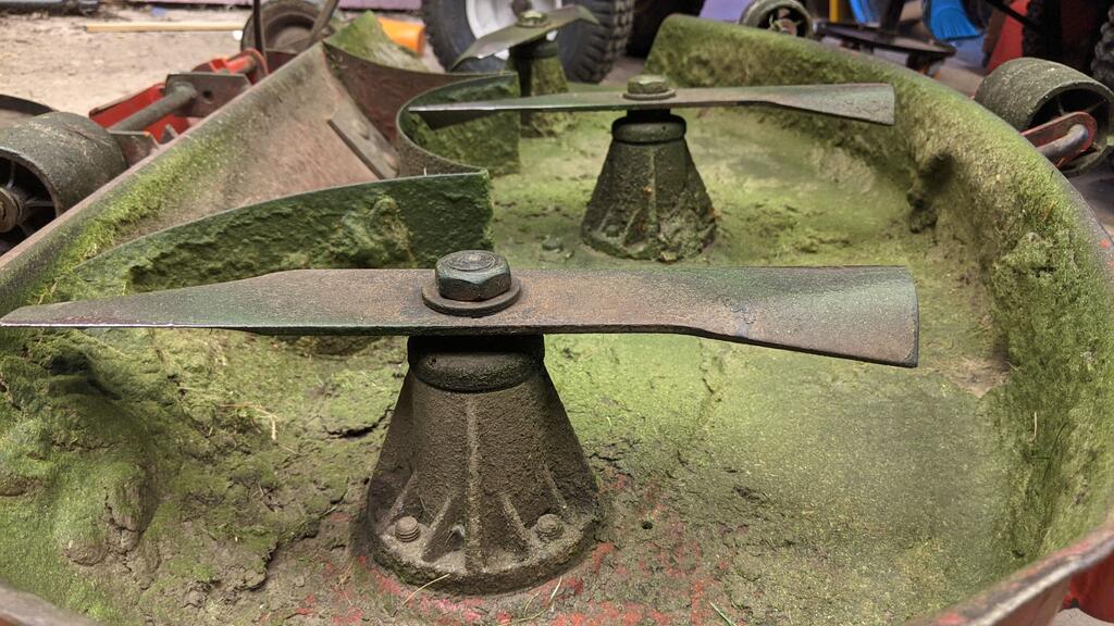

BigDaddyO 11 #7 Posted June 21, 2022 I've added photos to the first post. Looks like i'm missing a wide wheel on the back of the deck and i'm not seeing any way to raise the blades. it's really weird how they are so far from the deck top. Share this post Link to post Share on other sites
Jeff-C175 7,211 #8 Posted June 21, 2022 (edited) 15 minutes ago, BigDaddyO said: weird how they are so far from the deck top It is... I wonder if someone installed the wrong spindles... they 'look' like WH spindles. Just measured the spindles on my 42" rear discharge and my 48" side discharge and they are both 4" from the bottom of the blade to the deck. What do yours measure? I'm sure you're going to clean all that globbed up grass ... and that you know leaving those globs on there is sure to rot that deck out in short order. Edited June 21, 2022 by Jeff-C175 Share this post Link to post Share on other sites
8ntruck 9,338 #9 Posted June 21, 2022 Yup. The blades are mounted correctly. The distance from the top of the deck to the blade does look odd. Share this post Link to post Share on other sites
BigDaddyO 11 #10 Posted June 21, 2022 just measured, it's 4-1/8" from deck to the blade Share this post Link to post Share on other sites
Jeff-C175 7,211 #11 Posted June 21, 2022 17 minutes ago, BigDaddyO said: just measured, it's 4-1/8" from deck to the blade Close enough for horse shoes... Any idea how old that deck might be? I was just looking through spindle charts and such to see if there was any indication that there may be shorter spindles on some decks. No measurements shown. How about from the deck to the lip of the deck? I'm going out to look at my 42" now... I'll measure that. Can't do the 48 cuz it's under a machine. Share this post Link to post Share on other sites
BigDaddyO 11 #12 Posted June 21, 2022 here is another question, is a 42" deck the width of the blade cut? because I measured from the outside of the left wheel to the right most portion of the shoot and it's 48" the guy I bought it from said it was a 42" deck so I was a bit annoyed that it was actually 48" total width which didn't fit through my existing gate. Share this post Link to post Share on other sites
BigDaddyO 11 #13 Posted June 21, 2022 the total height of the deck = 5" I re-measured from the inside of the deck to the blade and it's 4-1/2" There is a bump that the spindle is attached to which is what the previous measurement was from. Share this post Link to post Share on other sites
Jeff-C175 7,211 #14 Posted June 21, 2022 6 minutes ago, BigDaddyO said: is a 42" deck the width of the blade cut? Cutting width. I believe yours is a 42" because the height adjustment is on the right side. 48" has that on the left. I measured both my decks and the height of the side walls is between 4" on the FRONT of the 42" REAR discharge, and 5" on the SIDE walls. The 48" as near as I can tell is about the same. I don't think yours is actually wrong. As long as the blades are 'recessed' by about 1/2" to 1" it's correct. Your problem may be here: You know that lever on the right is the 'height of cut' lever, right? It's shown all the way down at the lowest setting. The wheels appear to be worn way down, that's going to get you that much closer to the turf. When installed, this 'fork' needs to be on the bar on the attach-a-matic, was it ? This adjustment is for the front / back leveling of the deck when in the cutting position you use the most. The manual says to adjust with it in the middle setting, but if you typically mow higher or lower I would adjust it so the front tip of the blades is about 1/8 to 1/4 inch lower than the rear. And yeah, that missing wheel needs to be there too. The deck rides on those when in the cutting position. The front ones not so much. They typically 'float' above the ground and are really there only to keep the front of the deck from 'digging in'. You could move the center front one to the rear until you can get a replacement. Do you have any idea at all how old your deck is? Any labels on it anywhere? (I don't see any!) Share this post Link to post Share on other sites
