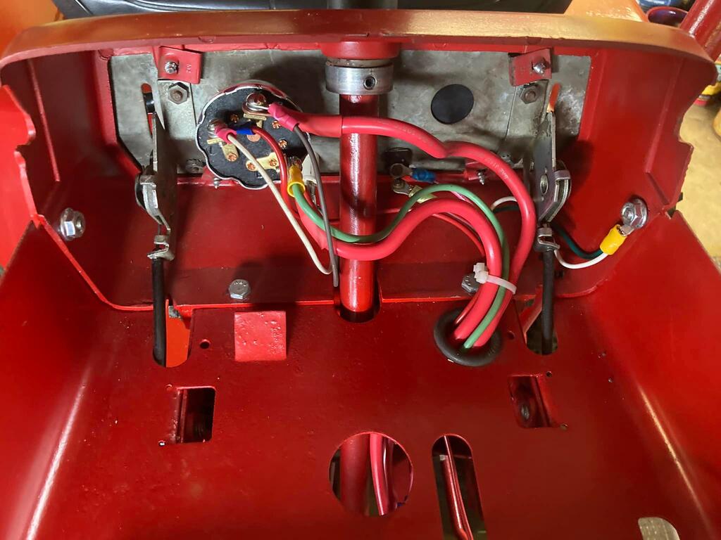

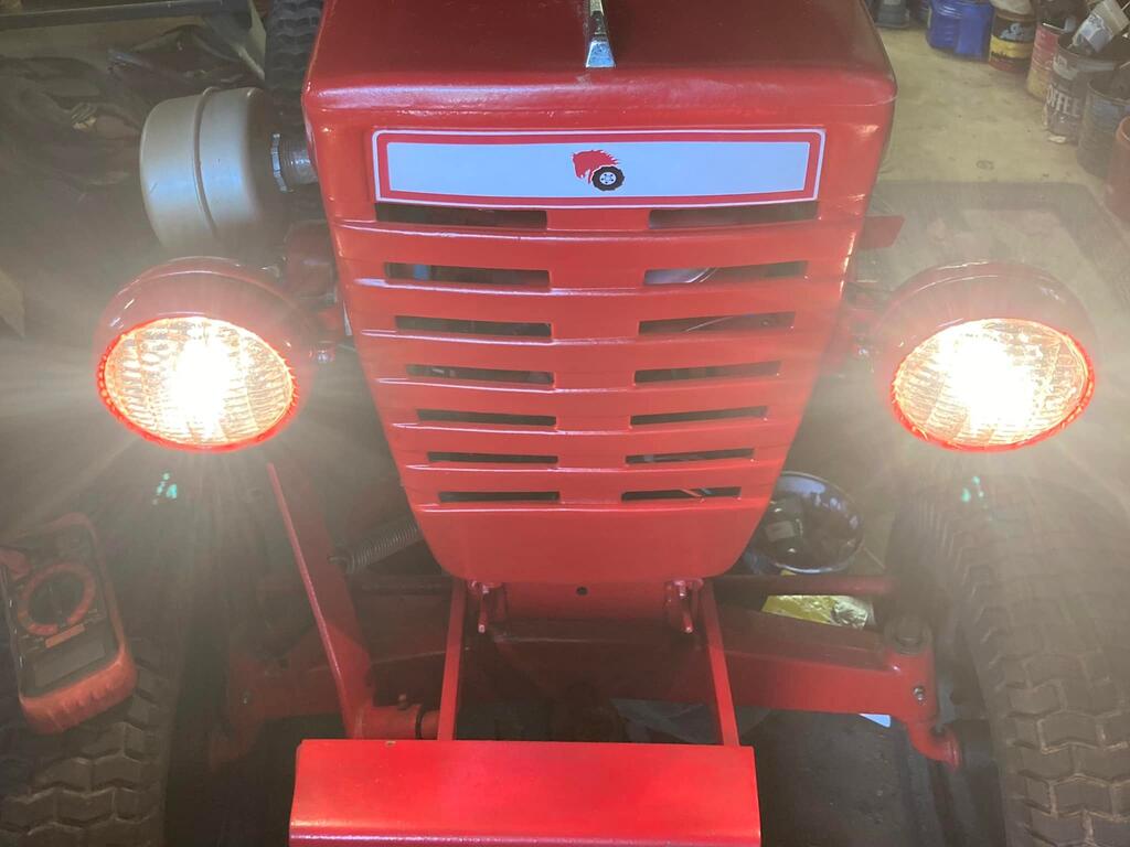

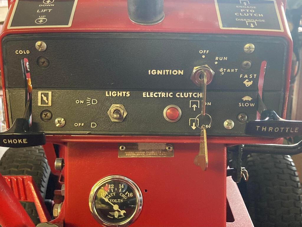

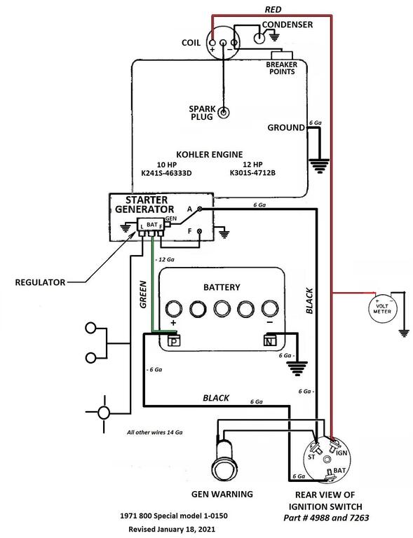

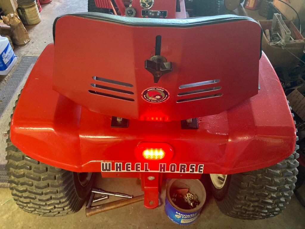

"Manic-Mechanic" 1,486 #1 Posted June 20, 2022 (edited) I had an impulse to post the retro circuit for this build The # 6 were made of starter grade so they retained the bends nicely The taillight on and bright The generator light is occupying the clutch switch location The headlights, good and bright! Edited June 21, 2022 by "Manic-Mechanic" 3 Share this post Link to post Share on other sites
