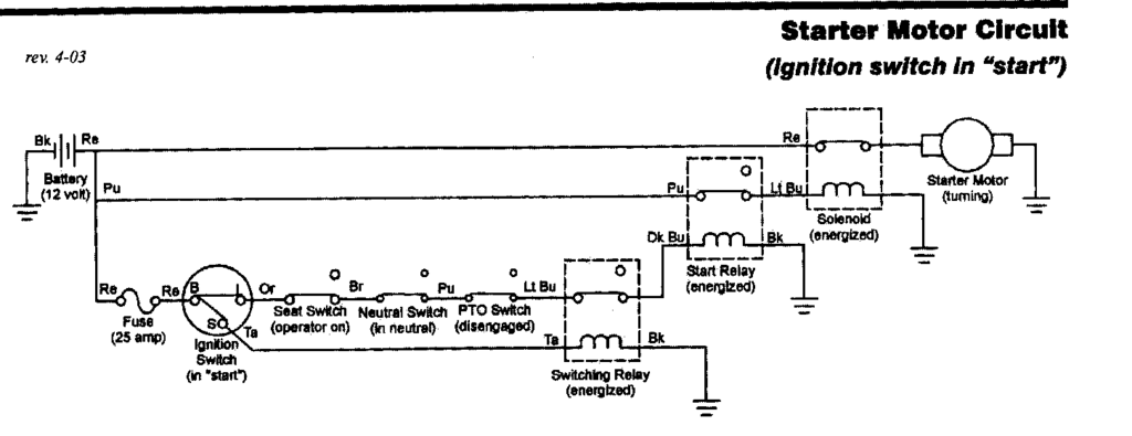

lynnmor 9,073 #2 Posted June 19, 2022 Depending on the year, a dash light should illuminate when turned to start indicating the fault, look for that first. As you can see, the fuse, ignition switch, seat switch, neutral switch, PTO switch, switching relay, start relay and the solenold on the starter all need to be in working order. I would start at the PTO switch and check for voltage there when the key is turned to start. If no voltage, work backwards till you find where it is lost. If you did find voltage in the first test, then check wiring and relays going towards the starter. 1 Share this post Link to post Share on other sites
