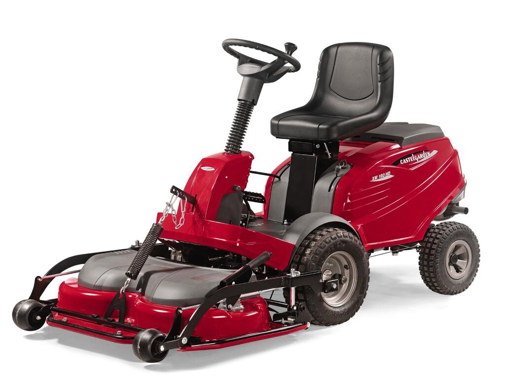

sjoemie himself 3,176 #33 Posted June 27, 2022 Looking good so far. Also like the extra reinforcement, mo' steel mo' betta if you ask me. Was thinking about the POR stuff and other methods. Have you considered powdercoating the deck? My dad did that with his 'throwaway' Castelgarden mower and that deck is flawless. Mower and deck are about 15 to 20 years old.. Only problem with that thing is steering, works with steel cables, steers fine but it eats up cables.. 2 Share this post Link to post Share on other sites
