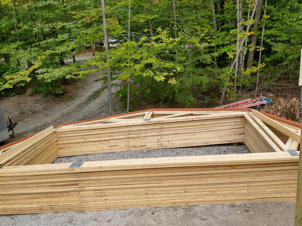

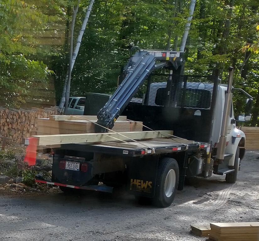

ebinmaine 81,183 #204 Posted September 30, 2022 Got another lumber delivery today. One of those two posts is now the back wall overhead beam. The smaller piece of PT on top of the sheet goods (Advantech) is a diagonal for the back wall. Zoomed in I believe the Advantech is for the 2nd floor. 1 3 Share this post Link to post Share on other sites

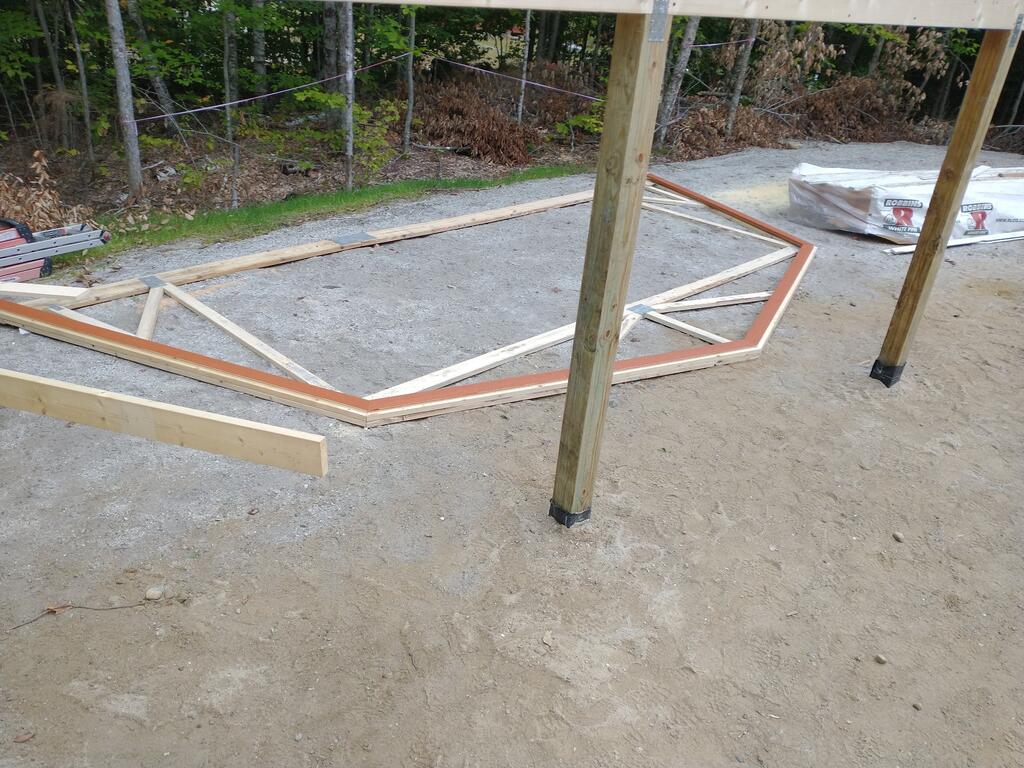

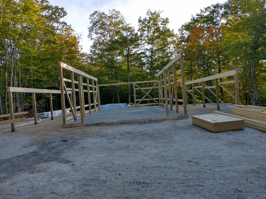

ebinmaine 81,183 #212 Posted October 1, 2022 The builders doing the main part of the work here have been great to get along with. They're trying to help out when possible about getting certain parts pre painted that'll be high off the ground. They built the gables a couple days early so Trina would have a chance to paint the trim. That happened this morning. We're scheduled for the crane Tuesday. 3 4 1 Share this post Link to post Share on other sites

rjg854 13,427 #215 Posted October 2, 2022 19 hours ago, ebinmaine said: The builders doing the main part of the work here have been great to get along with. They're trying to help out when possible about getting certain parts pre painted that'll be high off the ground. They built the gables a couple days early so Trina would have a chance to paint the trim. That happened this morning. We're scheduled for the crane Tuesday. I'm not seeing nailers built into the trusses for siding. 1 Share this post Link to post Share on other sites
ebinmaine 81,183 #216 Posted October 2, 2022 5 minutes ago, rjg854 said: I'm not seeing nailers built into the trusses for siding. They don't have the sizes or quantity of the windows yet, or the accurate spacing. First floor ceiling height varies on all his buildings because they don't always do the site excavation. Also depth of poles varies. These things will dictate the position of the stairway later which in turn will dictate the position of the windows on the back wall in particular. 2 Share this post Link to post Share on other sites
rjg854 13,427 #217 Posted October 2, 2022 I'm talking about the trusses themselves, where the painting was done. there's nothing below the fascia boards to fasten siding to. 1 Share this post Link to post Share on other sites
ebinmaine 81,183 #218 Posted October 2, 2022 1 minute ago, rjg854 said: I'm talking about the trusses themselves, where the painting was done. there's nothing below the fascia boards to fasten siding to. Oh oh oh. I imagine that'll get added on from the inside or they'll flip the trusses Monday to finish the build. They were left this way specifically so we could paint. I'll be curious to see what happens too. 1 Share this post Link to post Share on other sites

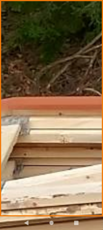

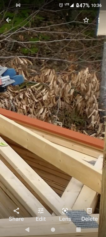

Oldskool 6,678 #219 Posted October 2, 2022 In the last 2 pics. Is the trim nailed to the trusses already or just placed for painting. 1 Share this post Link to post Share on other sites
ebinmaine 81,183 #220 Posted October 2, 2022 5 minutes ago, Oldskool said: In the last 2 pics. Is the trim nailed to the trusses already or just placed for painting. Nailed screwed glued duct taped... fastened somehow 1 Share this post Link to post Share on other sites
Oldskool 6,678 #221 Posted October 2, 2022 3 minutes ago, ebinmaine said: Nailed screwed glued duct taped... fastened somehow I just looked the pics over again. Is the trim set off from the face of the truss by a second piece? Share this post Link to post Share on other sites
ebinmaine 81,183 #222 Posted October 2, 2022 6 minutes ago, Oldskool said: I just looked the pics over again. Is the trim set off from the face of the truss by a second piece? They are. Here's a couple of close-ups. 1 Share this post Link to post Share on other sites
rjg854 13,427 #223 Posted October 2, 2022 I can see the pocket now, that just might suffice in giving the siding a place to rest. I forget now are you using wood or steel as your siding? I'm thinking you mentioned wood though. 2 Share this post Link to post Share on other sites
ebinmaine 81,183 #224 Posted October 2, 2022 5 minutes ago, rjg854 said: I can see the pocket now, that just might suffice in giving the siding a place to rest. I forget now are you using wood or steel as your siding? I'm thinking you mentioned wood though. Wood siding. Steel roof. The image below you can see two tarps. The one on the left is covering the half unit that isn't painted. The one on the right or straightforward is a half unit that's already painted green. 1 Share this post Link to post Share on other sites
rjg854 13,427 #225 Posted October 2, 2022 We would build a pocket like that for steel siding, much the same for wood also. So I approve 1 Share this post Link to post Share on other sites
