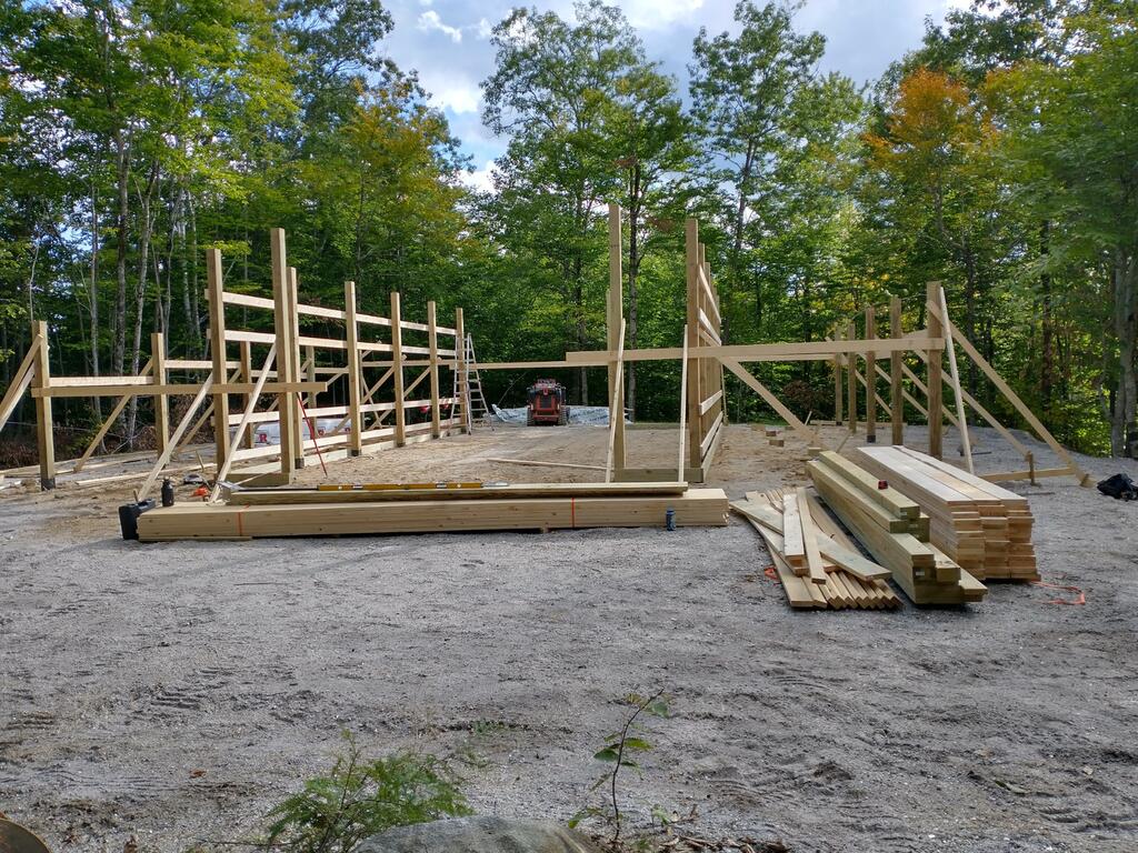

ebinmaine 79,181 #156 Posted September 26, 2022 The crew put in some good work today. All the 26 holes were backfilled. Floor leveled. Concrete forms mostly in place. (The forms stay forever). They also put up quite a few purlins between the poles. Me n a friend helped the 3 of them move the trusses across the yard so they're out of the way of the concrete trucks and also within reach of the crane. We should have concrete floor by Friday or Monday. Trusses up within 2 weeks. They're aiming for 11'-6" to 12' Interior ceiling height first floor. That's much higher than the 8 to 9 feet I thought we were getting and a VERY welcome surprise. 2 1 Share this post Link to post Share on other sites

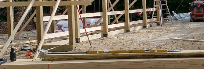

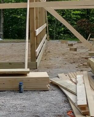

ebinmaine 79,181 #166 Posted September 27, 2022 Here's a pic from yesterday that Trina snapped and I didn't know it.... @WHX?? If you zoom in at the bottom of the walls you'll see the PT boards (2 x 10??) Used to hold the concrete. Rather than apply and remove forms that can only be reused so many times this builder makes the forms part of the structure. The concrete will sit about 2" below the top of the forms. Those boards are left in place and will be what amounts to sill plates. The next board above those is a horizontal piece of 1 x 10 pine, then the vertical pine siding. The concrete wraps the bases of the posts which helps hold them in place. 2 2 1 Share this post Link to post Share on other sites
rjg854 13,093 #167 Posted September 27, 2022 Is the concrete only being used in the center section? Share this post Link to post Share on other sites
Jeff-C175 7,209 #168 Posted September 27, 2022 4 hours ago, ebinmaine said: concrete wraps the bases of the posts Will they put down a 'vapor barrier' under the concrete pour? Share this post Link to post Share on other sites
ebinmaine 79,181 #169 Posted September 27, 2022 5 minutes ago, Jeff-C175 said: Will they put down a 'vapor barrier' under the concrete pour? Yepp. 2 1 Share this post Link to post Share on other sites

WHX?? 56,862 #173 Posted September 27, 2022 6 hours ago, ebinmaine said: zoom in at the bottom of the walls you'll see the PT boards Oh .. OK we call them grade boards here. 1 Share this post Link to post Share on other sites
lynnmor 8,853 #174 Posted September 27, 2022 7 hours ago, ebinmaine said: @WHX?? If you zoom in at the bottom of the walls you'll see the PT boards (2 x 10??) Used to hold the concrete. Rather than apply and remove forms that can only be reused so many times this builder makes the forms part of the structure. The concrete will sit about 2" below the top of the forms. Will the floor be tilted a couple of inches so the water runs out? I tilted mine 2" in 30 feet and another inch would have been better. Share this post Link to post Share on other sites
ebinmaine 79,181 #175 Posted September 27, 2022 31 minutes ago, lynnmor said: Will the floor be tilted a couple of inches so the water runs out? I tilted mine 2" in 30 feet and another inch would have been better. Absolutely. Code requires it in the front portion where the vehicles will be parked but not the back because that's a shop space. Likely they'll drop 1" to 2" towards each large door with a crown in the center. 2 Share this post Link to post Share on other sites
