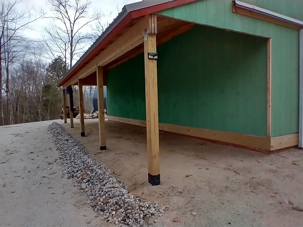

ebinmaine 81,183 #531 Posted April 21, 2024 (edited) We spent the day moving all the ehhh... "Stuff" out from undah the last side shed roof. We're now ready for concrete. And the waiting begins..... Bonus dog pic!!! Edited April 21, 2024 by ebinmaine 5 Share this post Link to post Share on other sites

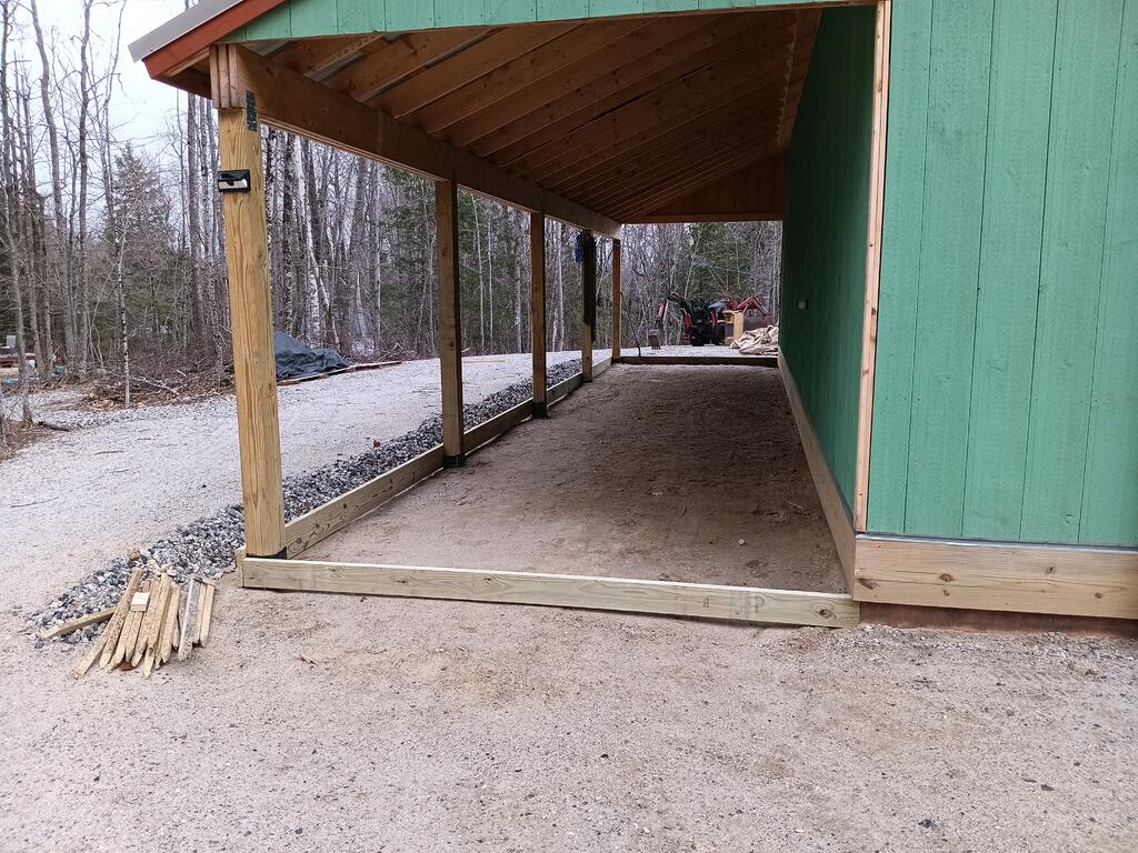

ebinmaine 81,183 #532 Posted April 24, 2024 Forms are on. 5 Share this post Link to post Share on other sites

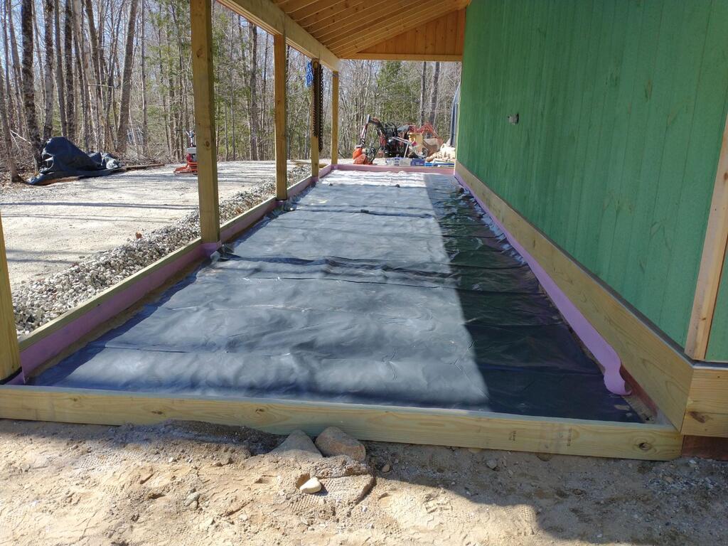

Handy Don 17,693 #533 Posted April 26, 2024 On 4/24/2024 at 5:26 PM, ebinmaine said: Forms are on. Do you put gravel or bank run under the slab? How do you isolate the wood (posts, skirtboard, etc) from the concrete? 1 Share this post Link to post Share on other sites
ebinmaine 81,183 #534 Posted April 26, 2024 18 minutes ago, Handy Don said: Do you put gravel or bank run under the slab? How do you isolate the wood (posts, skirtboard, etc) from the concrete? What you see in the picture is a combination aggregate of Bank Run gravel & 1.5" stone. That will be leveled out and compacted again. The wood is going to be wrapped with sill seal which is about 1/8 thick. That gives the slab enough room to move around. 1 1 Share this post Link to post Share on other sites
lynnmor 9,073 #535 Posted April 26, 2024 35 minutes ago, ebinmaine said: The wood is going to be wrapped with sill seal which is about 1/8 thick. That gives the slab enough room to move around. Won't the concrete smash the sill seal to almost nothing? My thought is that you should at least double layer it, especially living in the arctic tundra. 2 Share this post Link to post Share on other sites
ebinmaine 81,183 #536 Posted April 26, 2024 19 minutes ago, lynnmor said: Won't the concrete smash the sill seal to almost nothing? My thought is that you should at least double layer it, especially living in the arctic tundra. I'm sure it gives it some good squeeze but it doesn't need much room to move around. Here's a picture of it not quite completely installed but you get the idea. 3 Share this post Link to post Share on other sites

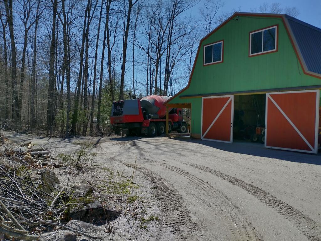

87 416-8 horse 430 #538 Posted April 26, 2024 Getting concrete delivered is always exciting. It’s a big step in a project. 1 1 Share this post Link to post Share on other sites
ebinmaine 81,183 #539 Posted April 26, 2024 6 minutes ago, 87 416-8 horse said: Getting concrete delivered is always exciting. It’s a big step in a project. 6 5 1 Share this post Link to post Share on other sites

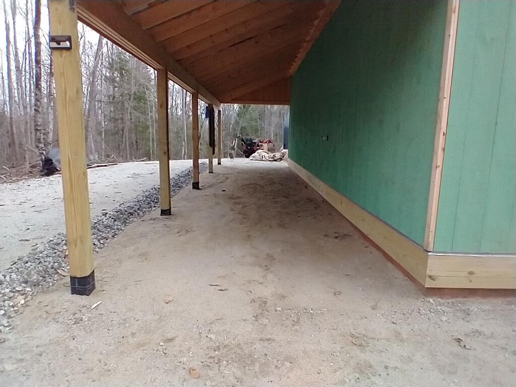

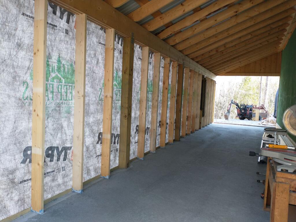

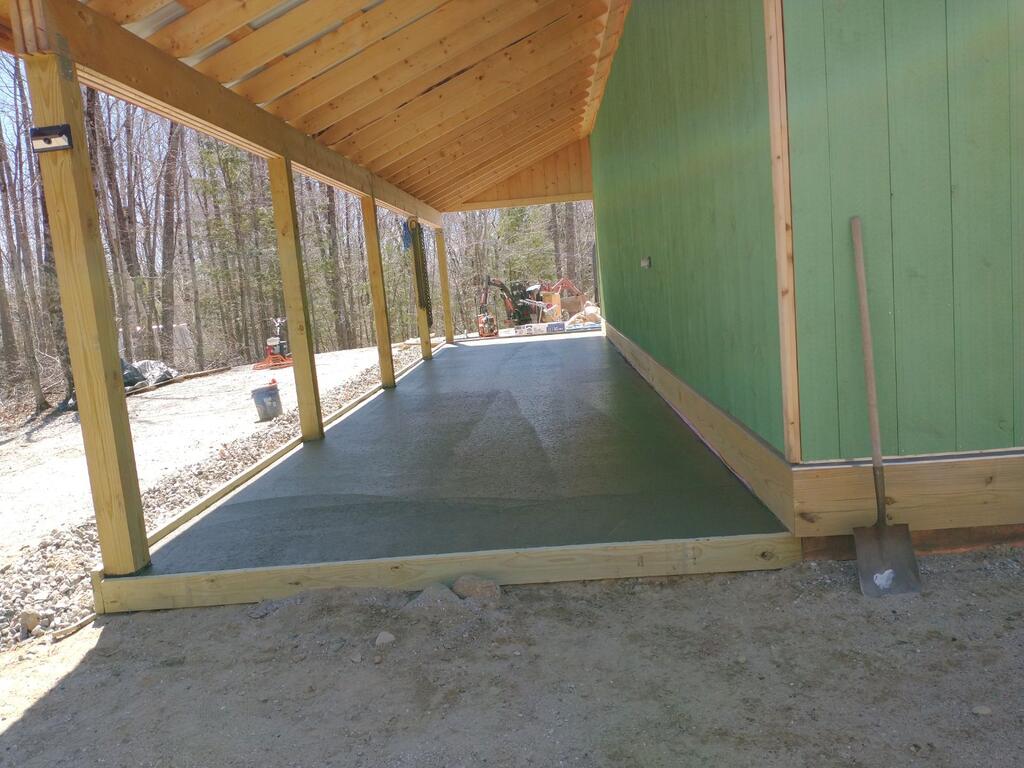

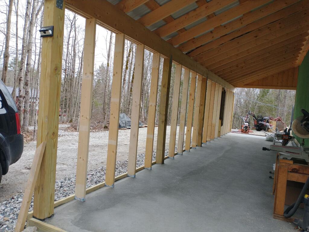

ebinmaine 81,183 #542 Posted April 28, 2024 Starting a little yesterday and more today, We moved some tools and supplies to the new workshop space. Figured out what we wanted to do. Installed the 16 wall studs. Next is to wrap with typar and start on the siding. Trina ordered some high-mount tilt in shed windows. They'll be here in a few days. Should be ordering the back door and more materials soon. We need to figure a plan for the front door(s). 5 Share this post Link to post Share on other sites
Handy Don 17,693 #543 Posted April 28, 2024 Factor in whether or not you ever want to have an awning or roof above the door keep the rain away. I’ve grown to really like the swing out doors on the garage I’m borrowing as a workshop. No obstruction for overhead lighting or other hanging stuff. Solid wood and no weather seal, though, so insulating value is nil. I’ll take/post a picture tomorrow. Overhead doors are terrific for electric openers, though! 2 1 Share this post Link to post Share on other sites

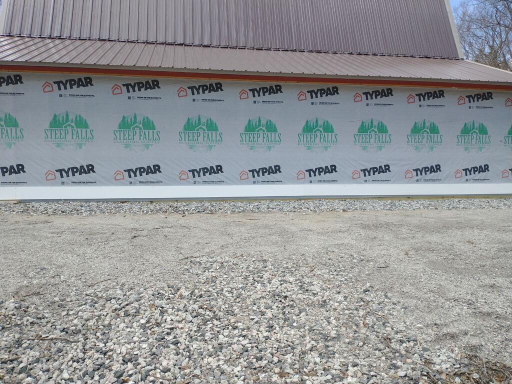

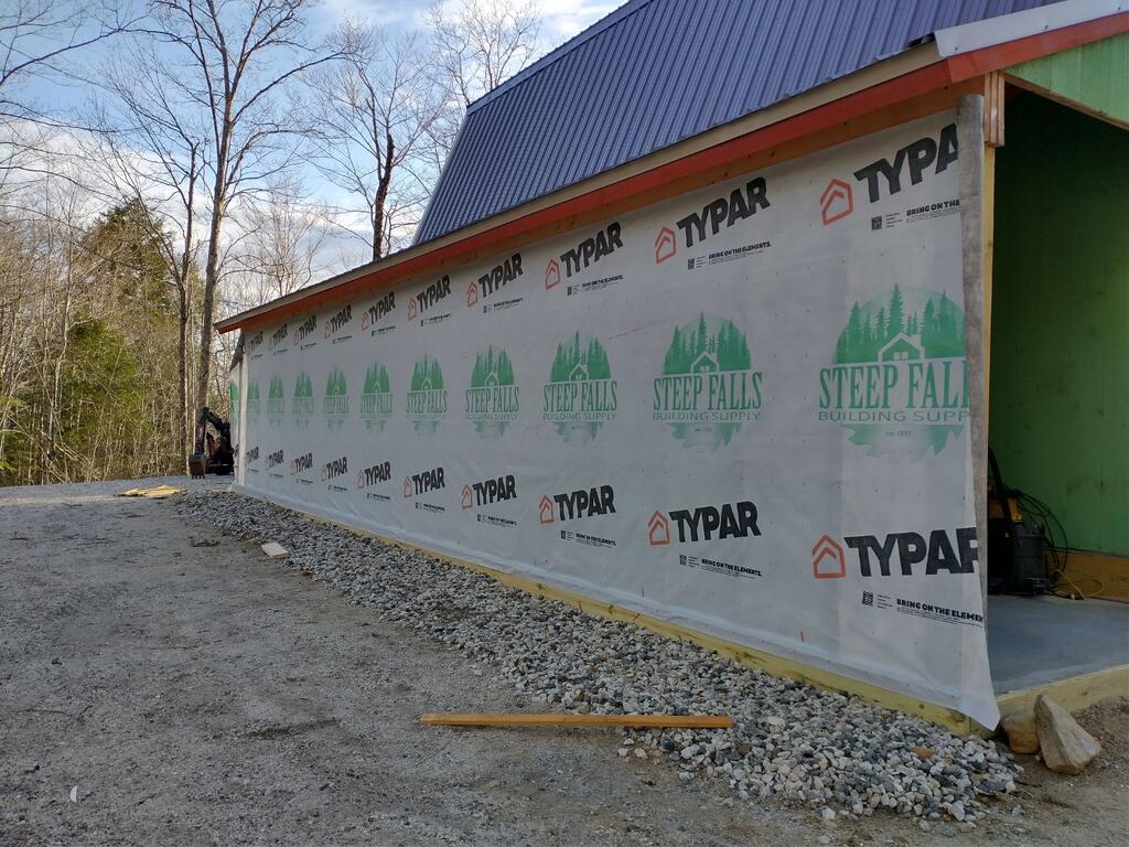

ebinmaine 81,183 #545 Posted April 29, 2024 We got the Typar all cut and stapled on the long wall this evening. 2 Share this post Link to post Share on other sites

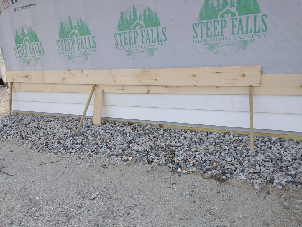

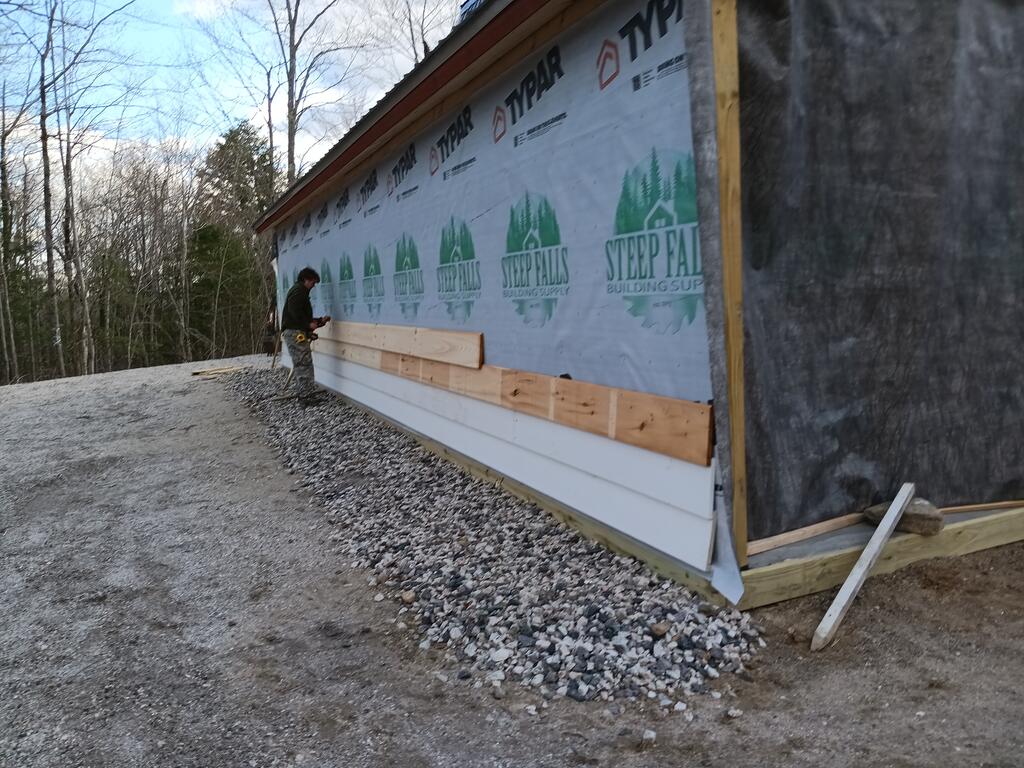

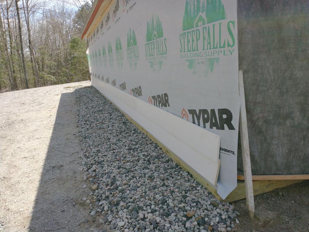

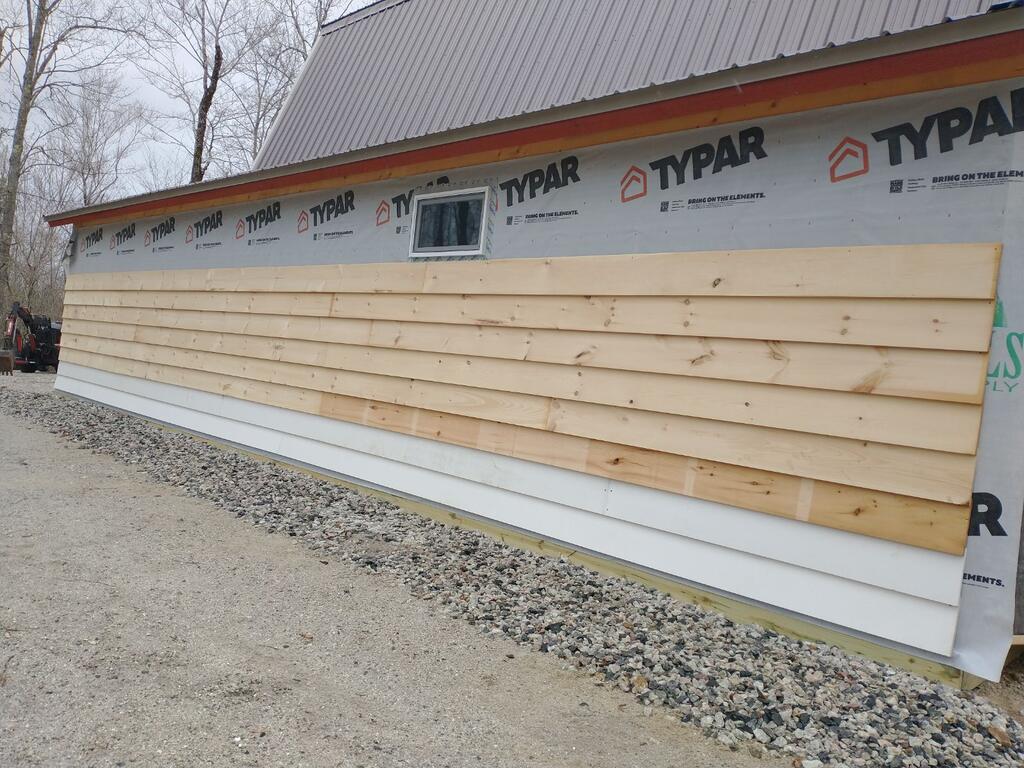

ebinmaine 81,183 #546 Posted May 3, 2024 Trina by herself and then with the help of her momma started setting the siding in place. 5 2 Share this post Link to post Share on other sites

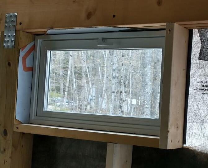

ebinmaine 81,183 #548 Posted May 5, 2024 More siding set on the last 3 days along with the first of four windows being installed. These are a tip in & down "hopper" window. 18 x 32. We'll be able to set a small double window fan in place for added air movement. Biggest bonus is that they give good natural light but I don't have to look over at the neighbor's yard. 3 Share this post Link to post Share on other sites
