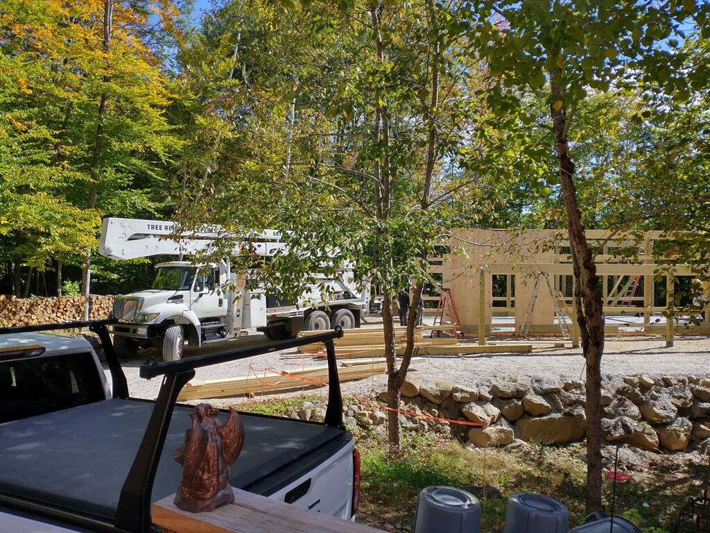

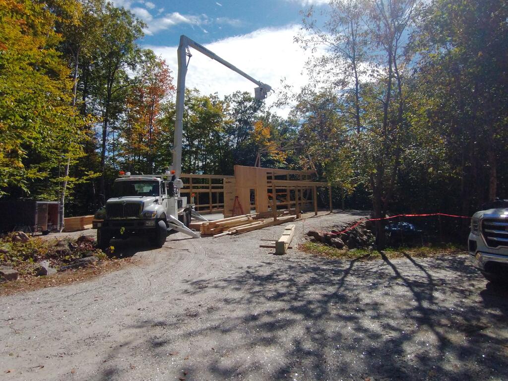

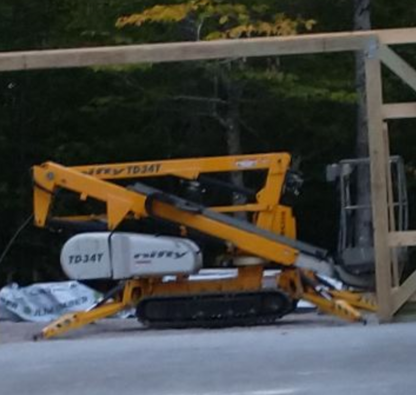

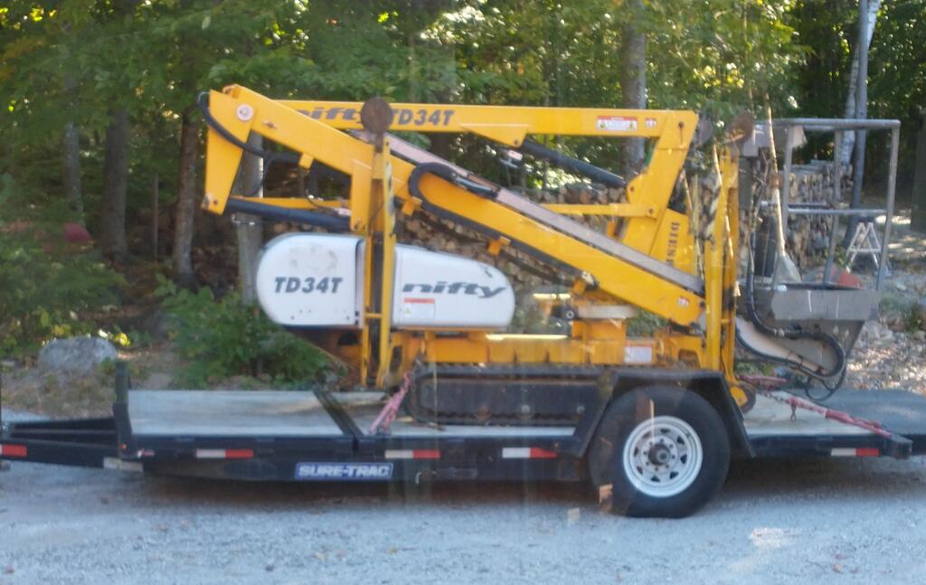

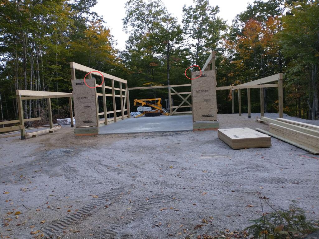

ebinmaine 81,183 #228 Posted October 3, 2022 Neato new toy showed up today and the Ditch Witch was taken to another site. This is a tracked type man lift. On level ground it'll reach 32 feet. Here it is all set up ready for the setting of the first truss. The guys finished building the front walls beside the 16' doorway. Also put copper flashing all the way around the foundation and added the PT sill plates. The brackets (circled in red) are what holds the header beam. That beam will be put in place by the crane just before or after the last truss. 6 Share this post Link to post Share on other sites

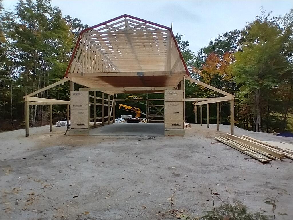

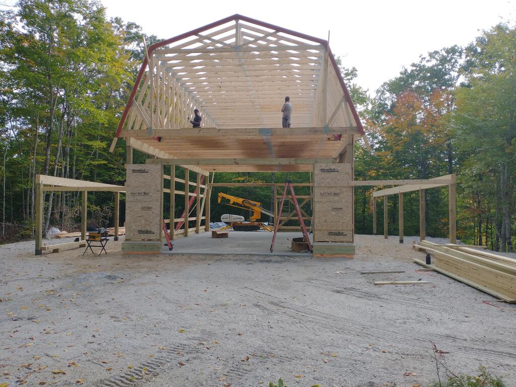

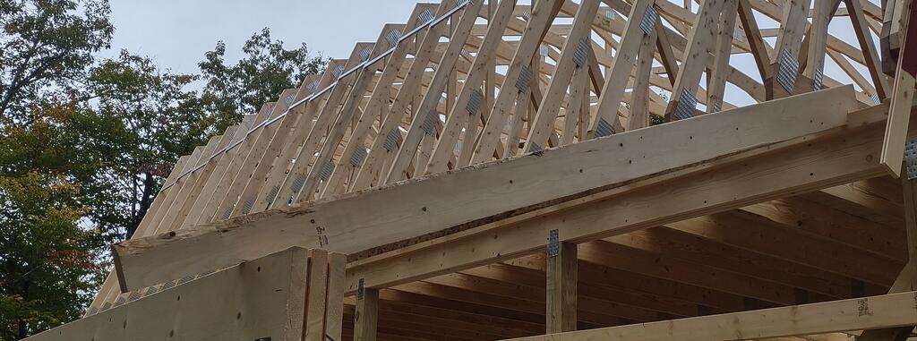

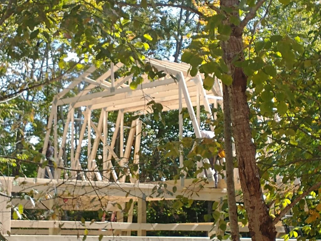

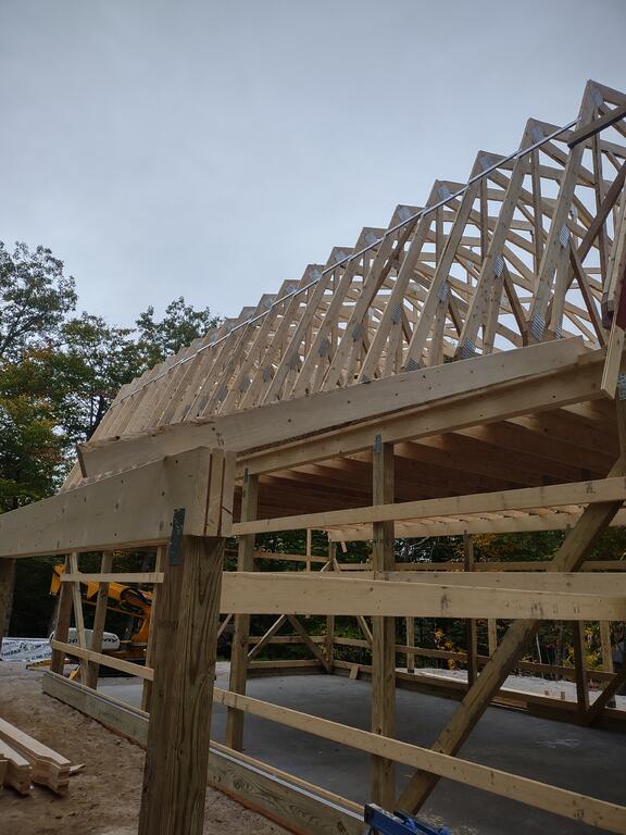

ebinmaine 81,183 #229 Posted October 4, 2022 Ladies and gentlemen we have trusses!!!!! Just to give you a bit of scale. The bottom of the trusses are about 12 ft 6 off the ground. 8 8 1 Share this post Link to post Share on other sites
WHX?? 58,347 #230 Posted October 4, 2022 Jeeperts cats have a dance up there!!! 2 2 Share this post Link to post Share on other sites
Horse Newbie 7,405 #231 Posted October 4, 2022 What’s the size of the concrete floor again ? 1 Share this post Link to post Share on other sites
ebinmaine 81,183 #232 Posted October 4, 2022 10 minutes ago, Horse Newbie said: What’s the size of the concrete floor again ? 24x40 sir 1 1 1 Share this post Link to post Share on other sites
SylvanLakeWH 32,837 #233 Posted October 4, 2022 Man… That is nice!!! 1 Share this post Link to post Share on other sites
Handy Don 17,693 #234 Posted October 4, 2022 Maybe offer ballroom dancing lessons on the second floor! Really taking shape nicely. 3 2 Share this post Link to post Share on other sites

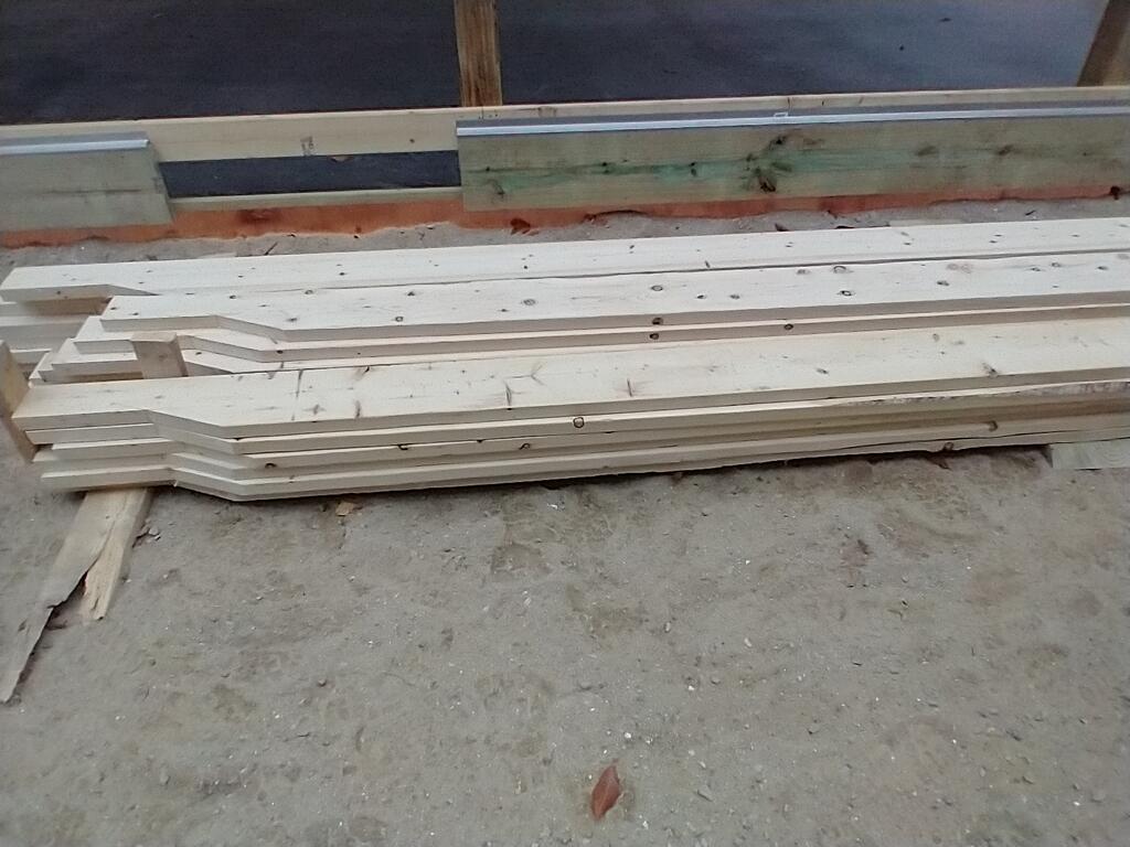

ebinmaine 81,183 #247 Posted October 5, 2022 Today only one fella was here. He spent some time making all the side shed roof rafters. 44 of them ?? One each side for pattern and fit. Two of these piles. 6 3 Share this post Link to post Share on other sites
