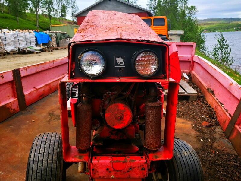

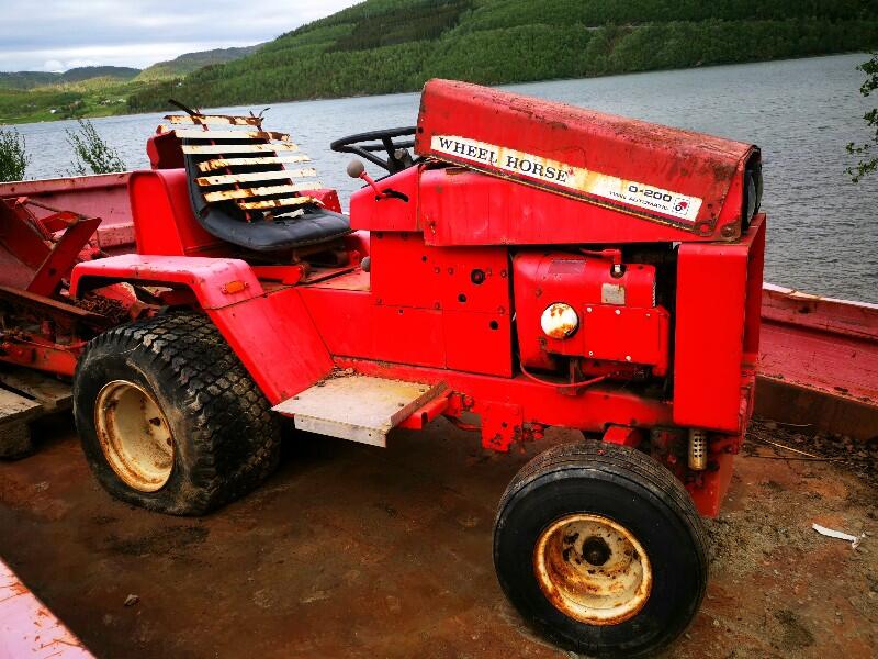

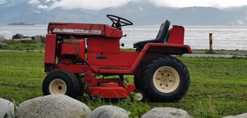

zlimmy 78 #8 Posted June 21, 2022 Same as my find here in Norway a few years ago. But it had a broken steering gear, been neglected and stood still a long time. But after some TLC it works like a charm. Love it, but i miss diff lock in wintertime. Little sloppy in front wheel bearings witch is impossible to get cause not produced anymore. Also needed to replace all tires..😍 2 Share this post Link to post Share on other sites
