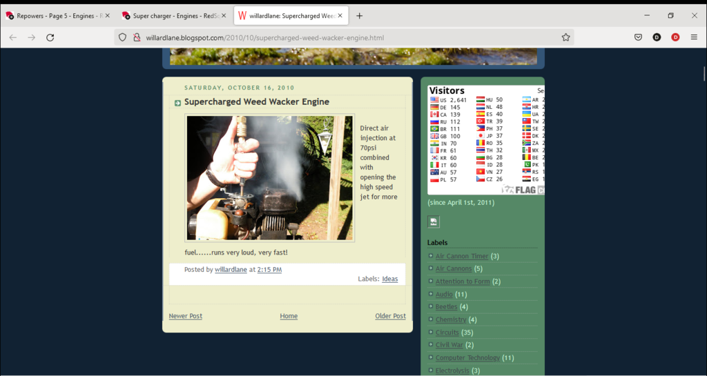

Snoopy11 5,731 #11 Posted June 16, 2022 (edited) @Jeff-C175... shhh... I'm busy trying to research how to supercharge my push-mower... AND MY WEED-EATER!!! Matter of fact... while I'm at it... I might just supercharge my air compressor in the shop and maybe even the air conditioning in the Ranger.... Don Edited June 16, 2022 by Snoopy11 3 Share this post Link to post Share on other sites
Snoopy11 5,731 #12 Posted June 16, 2022 (edited) AND... to trim my fruit trees... And to move the big piles of leaves I have in Fall... And to pick up groceries with... Don Edited June 16, 2022 by Snoopy11 4 Share this post Link to post Share on other sites
