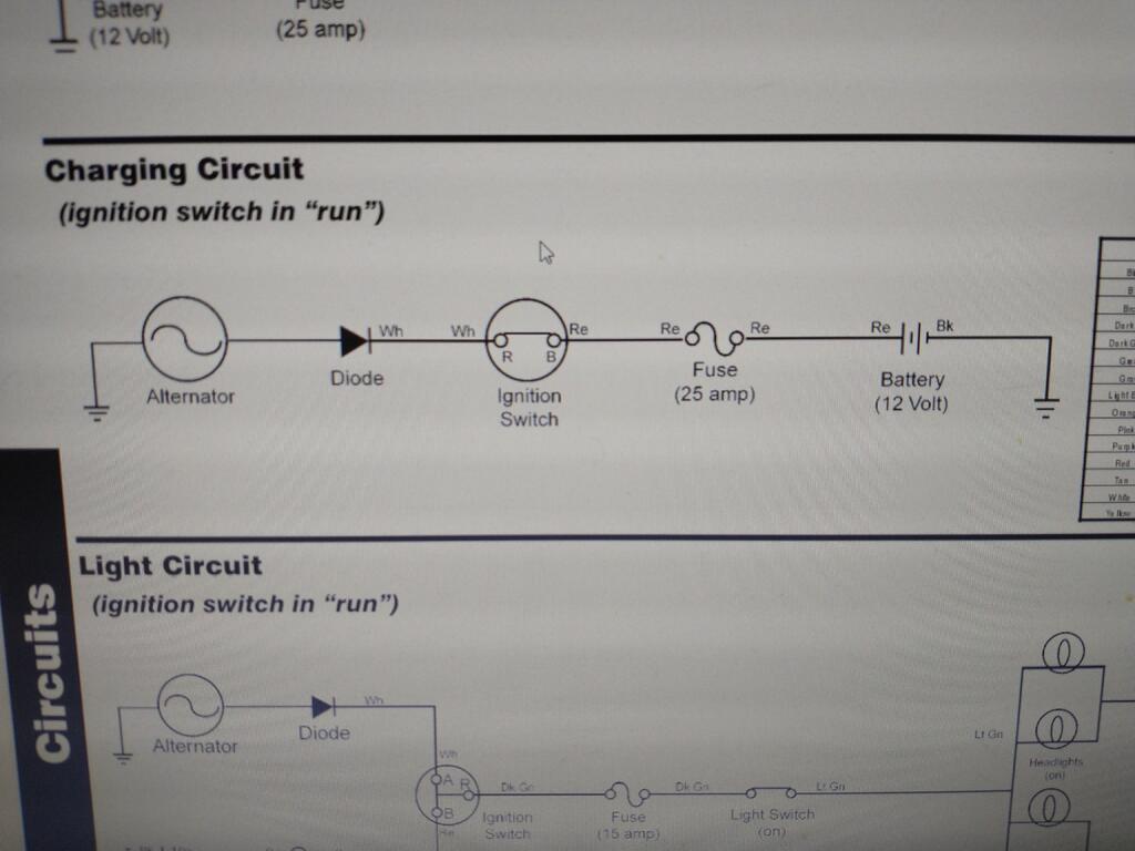

squonk 45,809 #9 Posted June 16, 2022 (edited) Hold all your bets! 89 312-8 uses the single wire diode charging system. Another kettle of fish! Edited June 16, 2022 by squonk 1 1 Share this post Link to post Share on other sites
Achto 31,310 #10 Posted June 16, 2022 (edited) 39 minutes ago, squonk said: Hold all your bets! 89 312-8 uses the single wire diode charging system. Another kettle of fish! Stators rarely go bad. Biggest issue I've come across with the single wire system is a bad diode. Simple fix usually. Start the tractor, disconnect the charging wire & see if it is producing AC or DC voltage. Test leads from the wire to the block. If you have AC voltage then just replace the diode. No voltage, bad stator or magnets on the fly wheel. Edited June 16, 2022 by Achto 1 1 Share this post Link to post Share on other sites
clueless 3,360 #11 Posted June 17, 2022 8 hours ago, squonk said: Hold all your bets! 89 312-8 uses the single wire diode charging system. Another kettle of fish! Guess he will have to figure out what year the 312-8 is my '88 has a 15 amp reg bolted to the front of the flywheel tin. 2 1 Share this post Link to post Share on other sites
