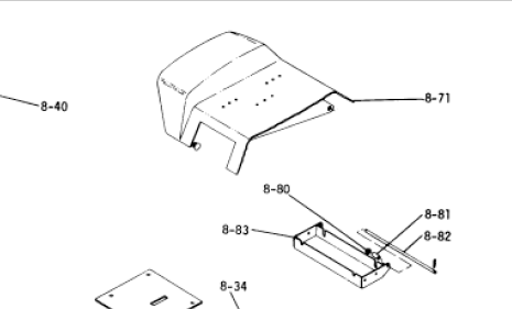

"Manic-Mechanic" 1,485 #1 Posted June 15, 2022 I cannot identify these parts and have not had them as they were missing. 8-80 8111 Bushing Spacer 8-81 919142-A Spacer Any help greatly appreciated Tractor 1974 A-90 Special 2-4300 TIPL.pdf Share this post Link to post Share on other sites

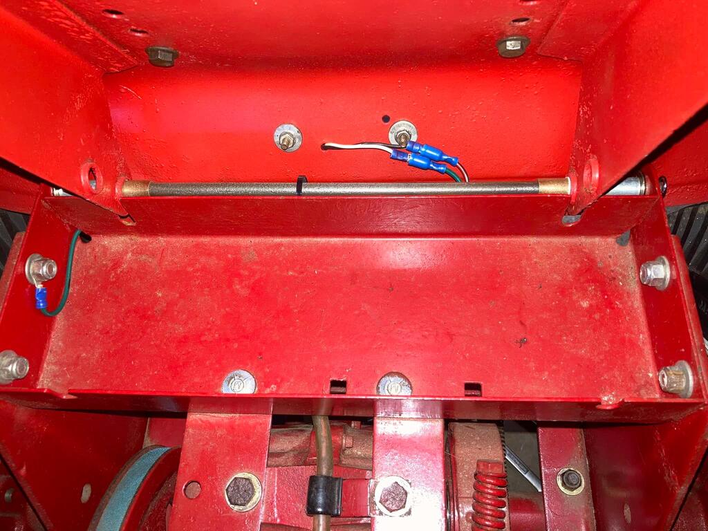

pfrederi 20,249 #2 Posted June 15, 2022 I use flanged sleeve bearings from McMaster 2 Share this post Link to post Share on other sites
"Manic-Mechanic" 1,485 #3 Posted June 15, 2022 (edited) On 6/15/2022 at 8:17 AM, pfrederi said: I use flanged sleeve bearings from McMaster How are they prevented from moving? Did you use 1" spacers to keep them in place? Pressed in or both? Ok, I found the 3/8 x 1/2 flanged bushings , 3/8 x 1/2 x 1-1/4 spacers and the 2 nyliner bushings 5666. Fished off with 4 3/8 flat washers. Seems to be very secure. Edited June 19, 2022 by "Manic-Mechanic" Share this post Link to post Share on other sites
