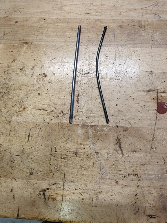

Marv 996 #1 Posted June 15, 2022 Compression check revealed about 30. Removed head and found both valve pushrods on the affected cylinder are bent. I have never seen an engine that was built with bent rods. So, the question becomes what caused them to bend. Stuck valves comes to mind. but these are nice and free. Help me out here. I am reluctant to just replace the rods and hope for the best. Marv Share this post Link to post Share on other sites

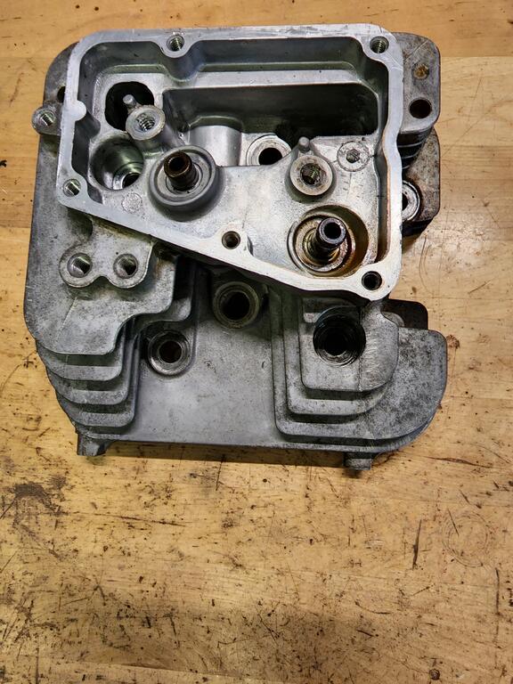

Marv 996 #21 Posted August 7, 2022 Update: The exhaust valve guide had moved. Apparently when the engine was hot, then when it cooled it stuck in place. So, the next time the engine started the valve did not have enough travel room. The movement of the rocker arm was stopped by the valve guide so the pushrod bent. There were no specifications on valve guides because they are not replaceable on that engine. Purchased a new head. Comparing the old and new I found the new guide extends 9/32 inch and the old one was 19/32. See picture. While replacing the head, three of the head bolts stripped, that is the threads in the block. Torque is 34 lbs. The threads gave away at 24. Wound up having to helicoil them. After reassembly it started and ran. After shutdown it did not want to start. Short cooling period and it started ok. Turned out that the ignition coil on that cylinder was intermittent. Marv Ps: Don't know what happened here but the pictures would not upload. Never had that problem before. Share this post Link to post Share on other sites
