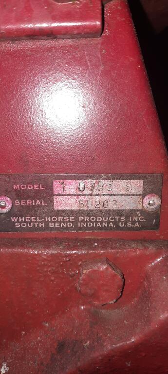

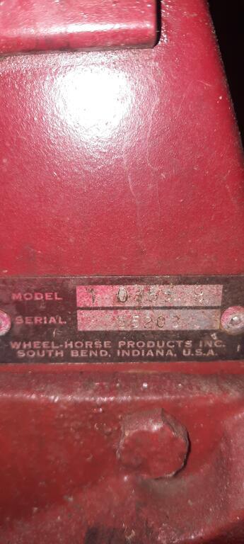

Docwheelhorse 2,792 #8 Posted June 15, 2022 5 minutes ago, ebinmaine said: IIFF it was... And IIFF you don't want the tag... Lemme know. The one I bought has no tag. Here's a pic of tag... de-code it and let me know , I'll drill the rivets and bring to show if it's legit. Neither I nor my friend would care if the tag was gone 1 Share this post Link to post Share on other sites
ebinmaine 75,727 #10 Posted June 15, 2022 Looks like that's a 1 0385 9 That IS a Tecumseh engine tractor. I won't be at the Big Show.... If you'd kindly mail that to me I'd be happy to send a bit of compensation. 3 Share this post Link to post Share on other sites
ebinmaine 75,727 #11 Posted June 15, 2022 I find it interesting that you'd get your hands on TWO of those Tecumsehorse as uncommon as they're claimed to be. 1 1 Share this post Link to post Share on other sites
