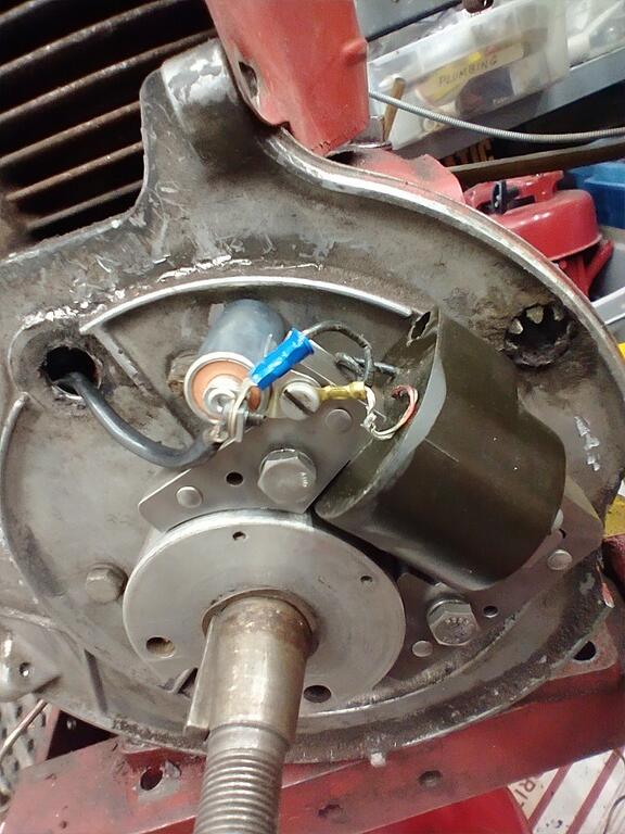

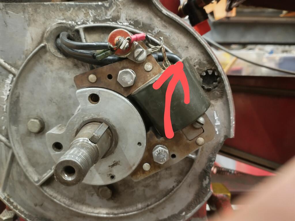

rmaynard 16,992 #3 Posted June 14, 2022 (edited) 17 minutes ago, peter lena said: @rmaynard what does the initial wire mount spot look like ? not familiar with it , pete The spark plug wire goes behind the bearing plate and exits at the hole shown (breaker wire is shown coming out). Then it goes over to the coil and into the coil over the internal pin. The hole is 11/16" deep. At this point, there is nothing to hold the wire to keep it from pulling back out or vibrating lose. Edited June 14, 2022 by rmaynard Share this post Link to post Share on other sites

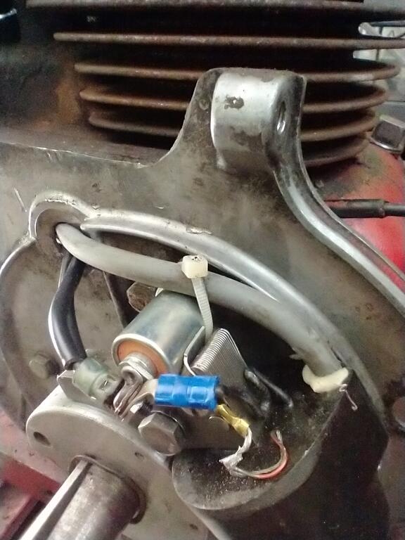

rmaynard 16,992 #16 Posted June 19, 2022 (edited) RESOLVED Epoxy and a zip tie. Edited June 20, 2022 by rmaynard 5 Share this post Link to post Share on other sites
