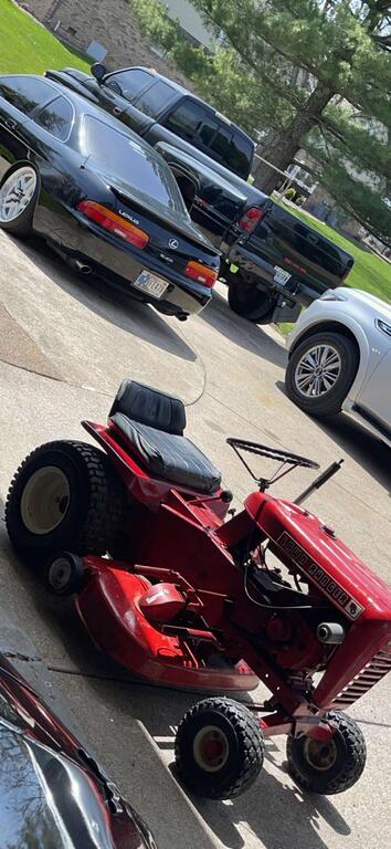

briley 5 #1 Posted June 14, 2022 I was mowing my lawn and I was about to put it into reverse and I look down and the shifter is just kind of dangling there and moving freely about, can’t find any gears. Does anyone know how to install or repair the shifter? thanks, briley. Share this post Link to post Share on other sites
Maxwell-8 4,371 #2 Posted June 14, 2022 (edited) Probably the shift screw backed out. Got instruction how to fix it in Dutch lol, Needed to help someone with the same issue, He did fix it thanks to the document Begin eerst met uw handel proper te maken.docx BTW: sweet Lexus Edited June 14, 2022 by Maxwell-8 2 1 Share this post Link to post Share on other sites
953 nut 69,482 #3 Posted June 14, 2022 This thread will get you going again. You are not the first person this has happened to. 2 Share this post Link to post Share on other sites

WHX?? 58,197 #7 Posted June 14, 2022 Lol....You just took the fun out of me trying to do it on translate! This is gonna help out an issue that does happen alot. I run the dog point 'till fairly snug then back it off a burly one. Nice LR BTW briley 1 2 Share this post Link to post Share on other sites
gwest_ca-(File Mod) 12,489 #8 Posted June 14, 2022 If the set screw is OK check to see if the donut is secure on the shifter. Some donuts are retained by a roll pin and if it shears the shifter gets sloppy. Others are welded. 3 Share this post Link to post Share on other sites
