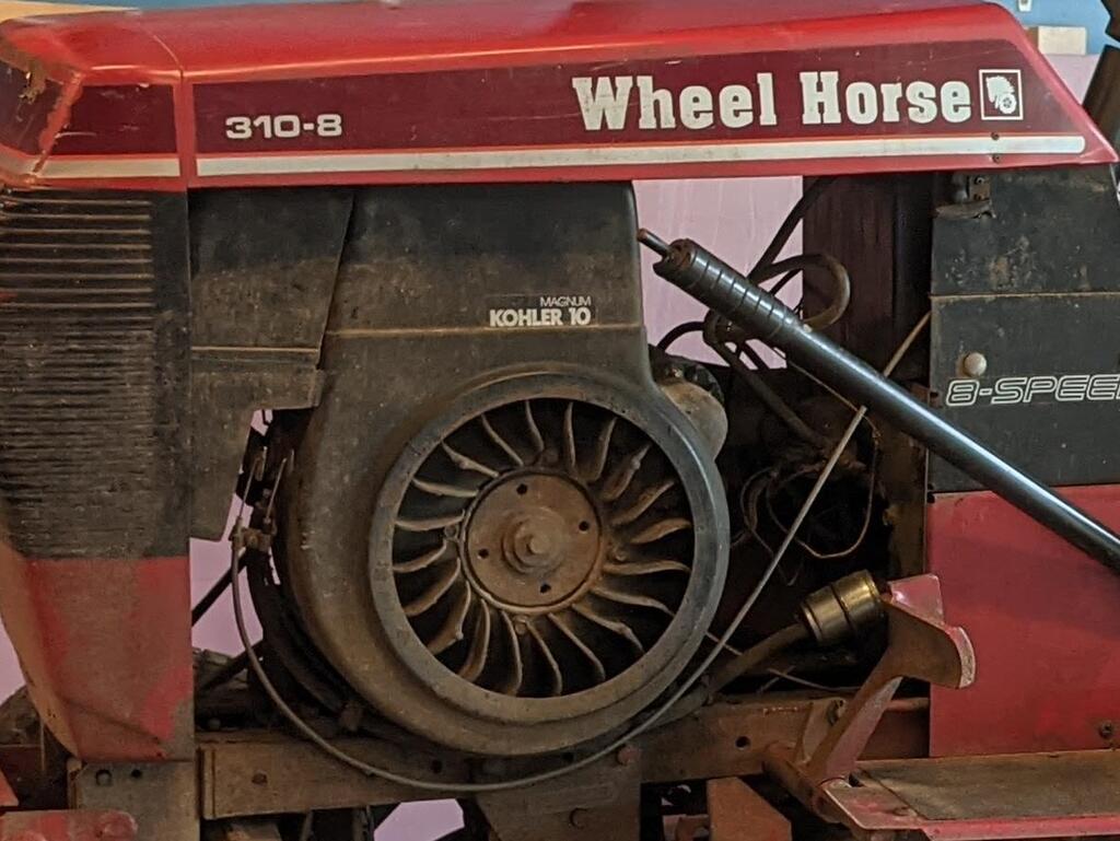

BigDaddyO 11 #1 Posted June 14, 2022 hello, i'm wondering if someone can confirm or suggest a correct part for me. my 310-8 wheelhorse didn't come with any cover over the flywheel and since it's about 2" from my toe I'd really like to have one on there. Is this the right part I'm looking for? if so, how does it attach? I don't see any screw holes or anything on how it attaches. https://www.jackssmallengines.com/jacks-parts-lookup/part/kohler/2516201s Thanks, Mike 1 Share this post Link to post Share on other sites
roadapples 6,987 #2 Posted June 14, 2022 (edited) It just snaps on those 4 little buttons on the flywheel. Outside diameter is probably all you need... incase anyone else has run into this, one of those buttons was broken off of my 16magnum. I drilled a tiny hole where the button was and used a small screw, about a #4 and a washer about four years ago. Still holding.... Edited June 14, 2022 by roadapples 5 Share this post Link to post Share on other sites
gwest_ca-(File Mod) 12,370 #3 Posted June 14, 2022 Will guess it is item #9 https://www.partstree.com/models/m10-461521-kohler-magnum-engine-made-for-wheel-horse-10hp-7-5kw/flywheel-13-10-507-rev-3-15-2006-to-show-group-description-10/ 2 1 Share this post Link to post Share on other sites
Maxwell-8 4,371 #4 Posted June 14, 2022 5 hours ago, BigDaddyO said: my 310-8 wheelhorse didn't come with any cover over the flywheel and since it's about 2" from my toe I'd really like to have one on there. Previous owner of My M16 just slapped a metal cover over it. note it's mounted on the fan shroud and not the fan/flywheel itself. This way the cover doesn't turn. Maybe not the most beautiful option, but I prefer it. 4 2 Share this post Link to post Share on other sites

BigDaddyO 11 #6 Posted June 14, 2022 10 hours ago, gwest_ca said: Will guess it is item #9 https://www.partstree.com/models/m10-461521-kohler-magnum-engine-made-for-wheel-horse-10hp-7-5kw/flywheel-13-10-507-rev-3-15-2006-to-show-group-description-10/ Thanks, just placed my order! Share this post Link to post Share on other sites
roadapples 6,987 #7 Posted June 14, 2022 12 hours ago, Maxwell-8 said: Previous owner of My M16 just slapped a metal cover over it. note it's mounted on the fan shroud and not the fan/flywheel itself. This way the cover doesn't turn. Maybe not the most beautiful option, but I prefer it. I tried it that way. Without the screen spinning grass stuck to it like the 520... 2 Share this post Link to post Share on other sites
Maxwell-8 4,371 #8 Posted June 14, 2022 27 minutes ago, roadapples said: I tried it that way. Without the screen spinning grass stuck to it like the 520... My niche has the same issue with her 312, shield turns with the flywheel That being said, I don't mow much at all. Maybe a windshieldwiper is an option haha 1 Share this post Link to post Share on other sites
