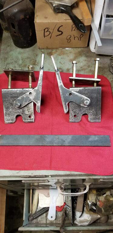

gt14rider 1,242 #4 Posted June 13, 2022 Like these? Share this post Link to post Share on other sites

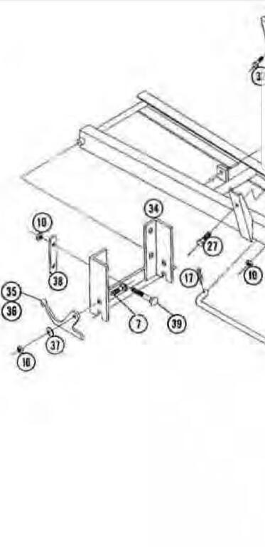

gwest_ca-(File Mod) 12,354 #5 Posted June 13, 2022 Those are the later style that mount under the axle housing. Look at BD-4264A here for the older style ahead of the axle housing. https://www.partstree.com/models/bd-4264a-toro-42-snow-dozer-blade-1965/ Share this post Link to post Share on other sites
