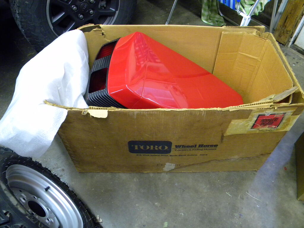

ebinmaine 79,105 #3 Posted June 12, 2022 Be interested in seeing the pics of the OE paint and what you came up with. Share this post Link to post Share on other sites
jeepdan 337 #4 Posted June 13, 2022 (edited) On 6/12/2022 at 4:59 PM, ebinmaine said: Be interested in seeing the pics of the OE paint and what you came up with. As soon as I get it rolling on four tires, I will take it outside and take a few photos. The fluorescent lights in my shop confuse my digital camera sometimes. Here is a photo that I had taken the other day, but the hood isn't shown with it. Edited June 13, 2022 by jeepdan Share this post Link to post Share on other sites

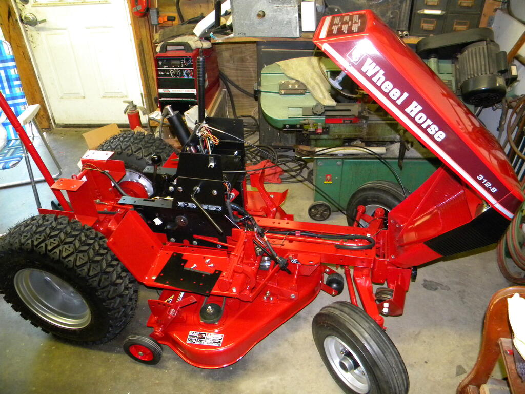

jeepdan 337 #5 Posted June 24, 2022 (edited) It rolls, and I'm gaining much more room in the garage/shop! Latest photo showing the Rust-Oleum concoction that I mixed compared to the red on the NOS deck shell, and the NOS hood sporting decals. Edited June 24, 2022 by jeepdan 2 Share this post Link to post Share on other sites
