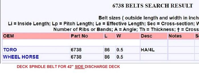

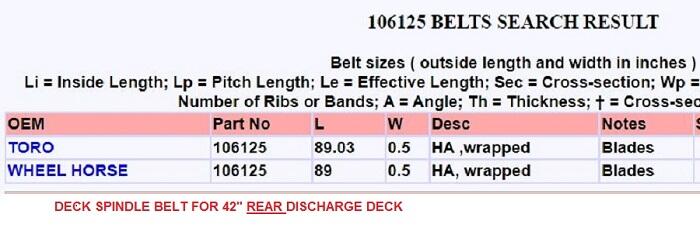

Brockport Bill 2,454 #1 Posted June 10, 2022 when i go online ( parts tree) to the mower deck diagrams for a 42 sd or rd mower and look for Belt number, it shows three belt part numbers, 6738, 1594 and 106125............however, it does not say which is correct belt for which deck? What is correct belt number (and the width and length) for a 42 Rd and 42 sd? thanks Share this post Link to post Share on other sites

JoeM 10,154 #3 Posted June 11, 2022 My notes show 42SD Spindle belt 6738 86 1/2 mule drive 102742 103" 42RD Spindle belt 106125 89 1/2" mule drive 108834 98 1/2" The 1594 is a 48" deck spindle belt 107 1/2" 1 Share this post Link to post Share on other sites
daveoman1966 3,884 #4 Posted June 11, 2022 8 minutes ago, JoeM said: My notes show 42SD Spindle belt 6738 86 1/2 mule drive 102742 103" 42RD Spindle belt 106125 89 1/2" mule drive 108834 98 1/2" The 1594 is a 48" deck spindle belt 107 1/2" I agree... 1 Share this post Link to post Share on other sites
