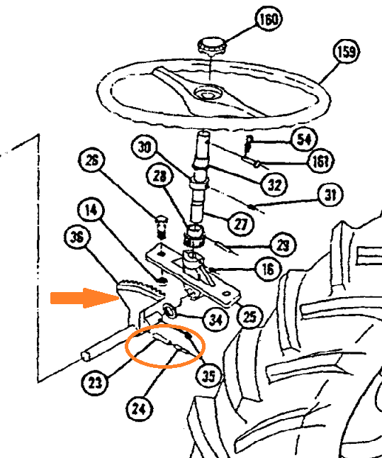

rmaynard 16,650 #1 Posted June 10, 2022 The 704 that I am working on has a lot of slop in the steering. Among other things, I have found that the fan gear rotates a bit on the lower shaft. This fan gear is fixed to the shaft with two roll pins, one is 1/4" with a smaller pin inside of it. Both pins are in good condition, so I assume that the hole in the shaft is slightly out of round, allowing for the movement. What is the recommended fix for this? Should I have the gear welded to the shaft or would I be better off putting a bolt through the gear and torquing it down? Share this post Link to post Share on other sites
ri702bill 10,308 #2 Posted June 10, 2022 (edited) Neither - Try a coiled (aka Spirol) pin first - If the hole(s) are so wallowed out, go up to 5/16". Spiral wound pins cover a wider range of hole size than a split pin and have at least 2X the radial holding power. They work. Edited June 10, 2022 by ri702bill 2 1 Share this post Link to post Share on other sites
rmaynard 16,650 #3 Posted June 10, 2022 Nothing appears wallowed. Does the larger pin still require a smaller pin inside it? Share this post Link to post Share on other sites
squonk 44,747 #4 Posted June 10, 2022 (edited) Service bulletin. I did this on my 704. Worked great and easy to do. did the fan gear and both spindles. @rjg854 just did his 1045 WH61-90 #049 Steering roll pin Orig.pdf Edited June 10, 2022 by squonk 1 1 Share this post Link to post Share on other sites
rmaynard 16,650 #5 Posted June 10, 2022 1 hour ago, squonk said: Service bulletin. I did this on my 704. Worked great and easy to do. did the fan gear and both spindles. @rjg854 just did his 1045 WH61-90 #049 Steering roll pin Orig.pdf 233.49 kB · 3 downloads Thanks Mike. Looks like this will work. Share this post Link to post Share on other sites

rmaynard 16,650 #11 Posted June 18, 2022 On 6/10/2022 at 3:46 PM, squonk said: Service bulletin. I did this on my 704. Worked great and easy to do. did the fan gear and both spindles. @rjg854 just did his 1045 WH61-90 #049 Steering roll pin Orig.pdf 233.49 kB · 32 downloads Followed bulletin to the letter. Worked perfect. Thanks Mike. 3 Share this post Link to post Share on other sites
