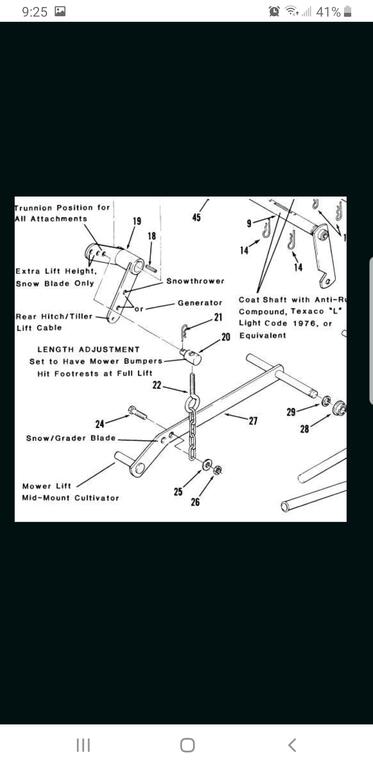

xstang77 2 #1 Posted June 9, 2022 So I'm purchasing a tiller to install on my 520h as well as a brinly plow. So far I know I need to utilize the dozer blade rear attachment points around the axle and a clevis hitch. Do I also need to buy an additional rockshaft kit? I've seen mention about one that goes under the seat,however my tractor already has one I use to hook up my snowblower and dozer blade to,do I need one in addition to this one? If so this ends up being a small fortune in itself! See #19 in attached pic for reference of what's already on my horse. Share this post Link to post Share on other sites
gwest_ca-(File Mod) 12,354 #2 Posted June 9, 2022 This one is under the seat It is also part of the tiller package 1 Share this post Link to post Share on other sites
xstang77 2 #3 Posted June 9, 2022 So it is an additional rockshaft..between buying that,the clevis hitch and the tiller with associated belts and pulleys its quite the chunk of change! Share this post Link to post Share on other sites
