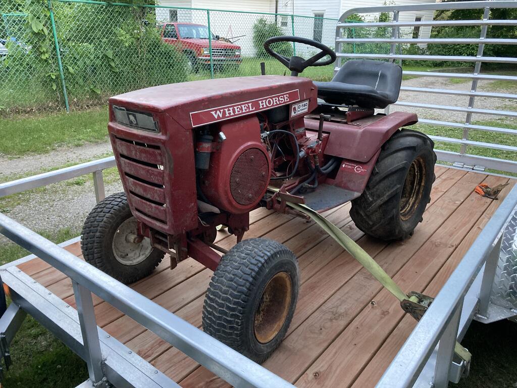

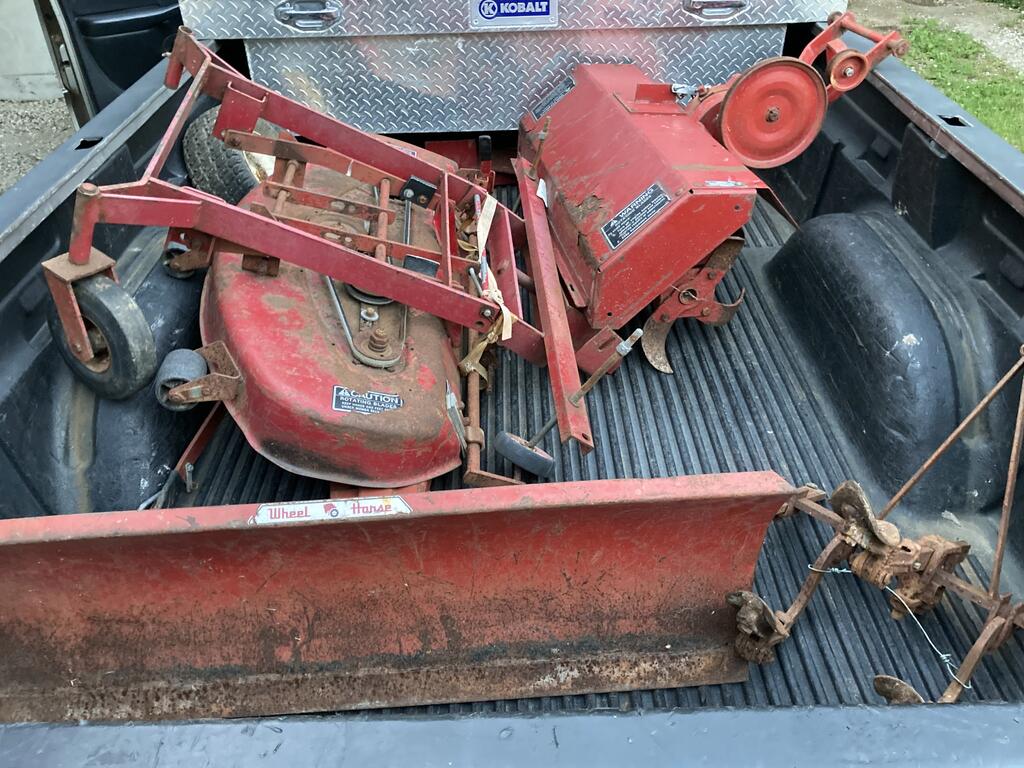

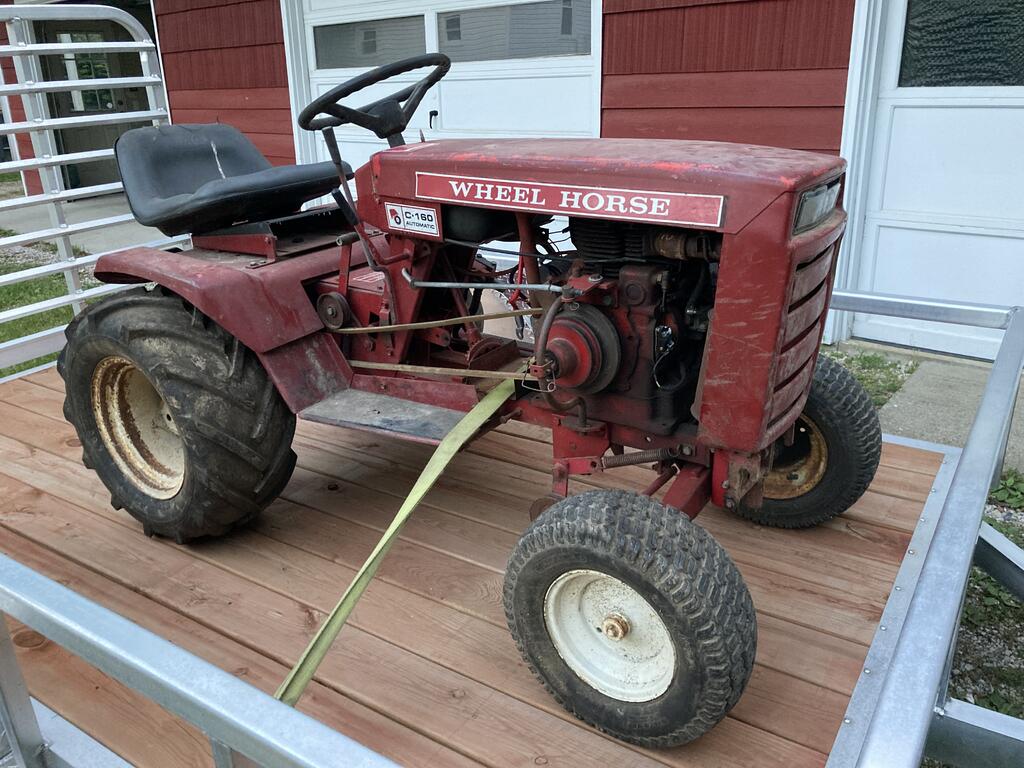

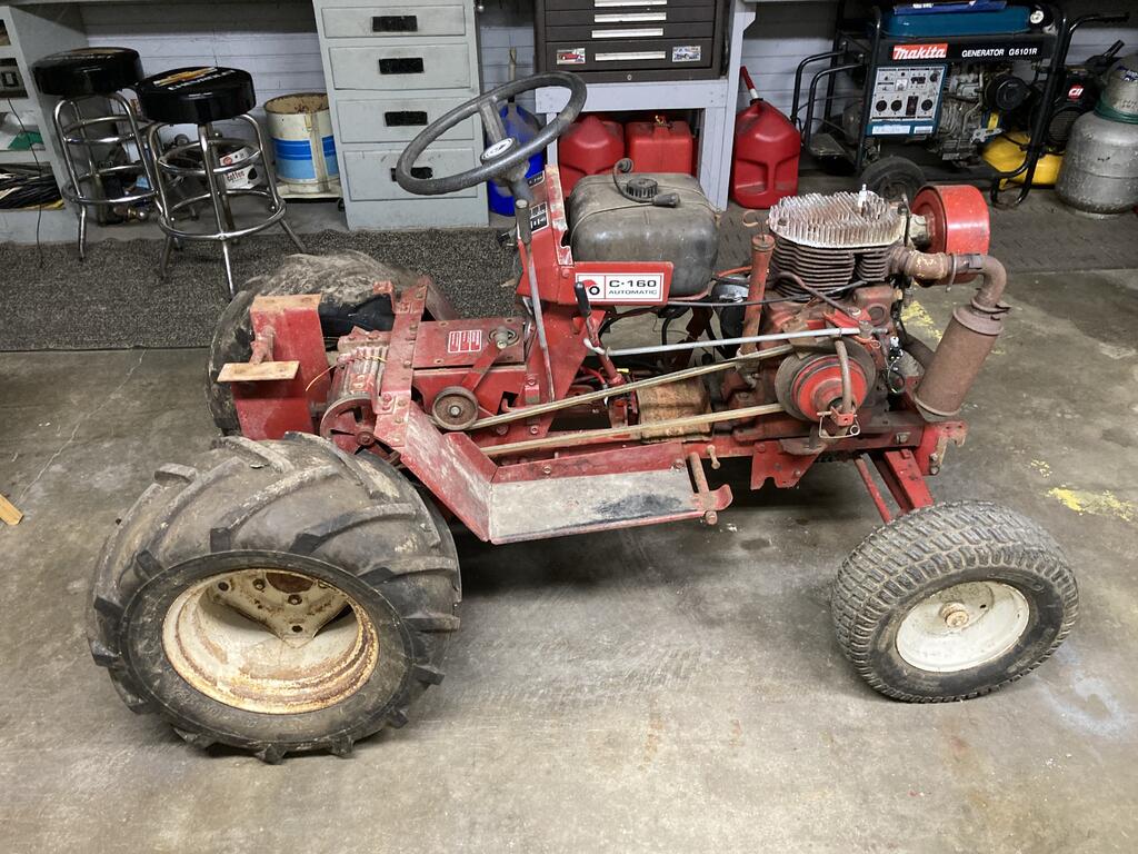

Blasterdad 3,167 #1 Posted June 8, 2022 (edited) Brought this old girl home yesterday, found her for a dear family friend. She will spend a little time here until she & all her attachments have a clean bill of health, then off to her new home for work duty in the garden & yard. Edited June 8, 2022 by Blasterdad 9 22 Share this post Link to post Share on other sites

953 nut 68,197 #6 Posted June 8, 2022 Always glad to hear that another person has been bitten by the incurable Wheel Horse bug! Is there a foot-rest with the reclining seat? 3 Share this post Link to post Share on other sites
Blasterdad 3,167 #7 Posted June 8, 2022 1 minute ago, 953 nut said: Always glad to hear that another person has been bitten by the incurable Wheel Horse bug! Is there a foot-rest with the reclining seat? Yeah that is interesting, the original bracket is bolted on upsidedown & backwards, & the seat has a bracket bolted on top of that, Lol. Don't know what it come off originally... 2 2 Share this post Link to post Share on other sites
Pullstart 71,016 #8 Posted June 9, 2022 Do you need a belt guard? I believe I have one… 2 1 Share this post Link to post Share on other sites
Blasterdad 3,167 #9 Posted June 9, 2022 16 minutes ago, Pullstart said: Do you need a belt guard? I believe I have one… No, the belt guard & all the little pieces like the idler shafts & what-not were under the toolbox in the in the back of the truck, the tractor is complete, the only thing missing on it was the plow mount, but I have like 5 of those laying around... About the only thing I could find missing was the plow angle rod & wouldn't you know it I just got rid of 3 whole pows doing some Horse trading,Lol. Oh well, easy enough to find or make one... Thank you very much for the offer though, good looking out!!! 3 Share this post Link to post Share on other sites

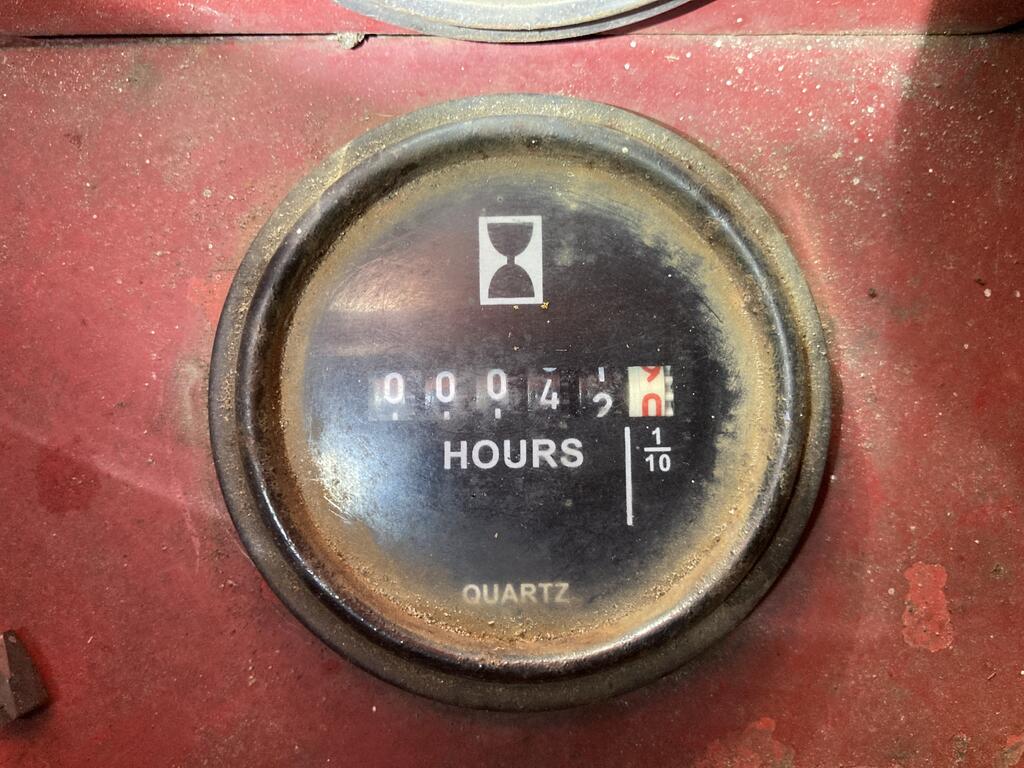

Blasterdad 3,167 #10 Posted June 9, 2022 Another "interesting" item on this tractor, not sure if it's true or not but sure would be cool if it was... 4 2 Share this post Link to post Share on other sites
peter lena 9,993 #11 Posted June 9, 2022 @Blasterdad terrific pick up on that ! a thorough baseline service , will verify and enhance its life , both that tiller and front end mower set up already has me crawling all over that , even that lower blade wear edge , looks like its still in the safe wear zone. an aerosol spray down , would lubricate and retain patina on all metal surfaces . save another one , oily pete 1 Share this post Link to post Share on other sites
Pullstart 71,016 #12 Posted June 9, 2022 (edited) Man… if that ticker was accurate and working the whole time, that was a rough 42 hours! Edited June 9, 2022 by Pullstart 3 Share this post Link to post Share on other sites

Blasterdad 3,167 #15 Posted June 9, 2022 6 hours ago, Pullstart said: Man… if that ticker was accurate and working the whole time, that was a rough 42 hours! I seriously doubt it's hooked up, it was taken care of though, oil in engine & tranny are both clean but will change them anyway. I got it running in about 10 minutes when I got there, put a new owner supplied starter on it, new battery, cleaned up the points & got spark, & with a little assistance from my portable instant carburetor filled with Klots & Rec gas she fired right up & sounded great. I love the smell of Benol in the afternoon, smells like victory! Lol. 2 1 Share this post Link to post Share on other sites

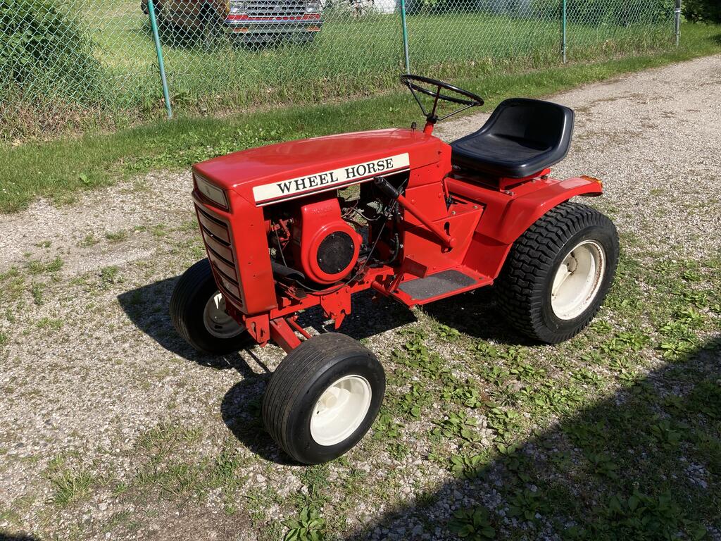

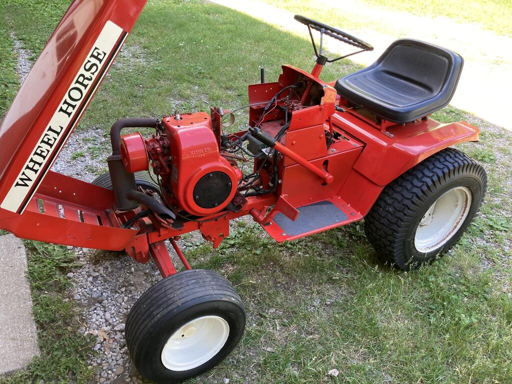

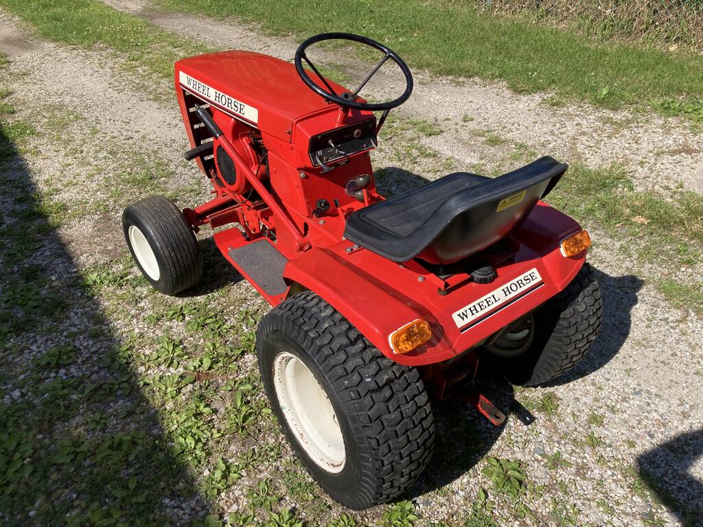

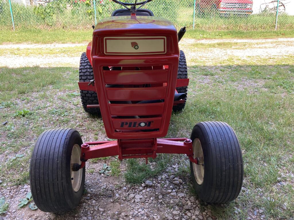

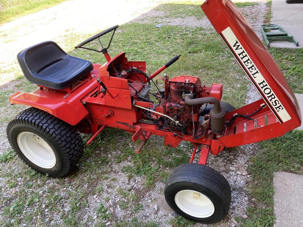

Blasterdad 3,167 #16 Posted June 12, 2022 And another.... 2 6 1 Share this post Link to post Share on other sites
ebinmaine 80,102 #17 Posted June 12, 2022 2 hours ago, Blasterdad said: another VERY nice. What's the story here? 2 Share this post Link to post Share on other sites
Blasterdad 3,167 #18 Posted June 13, 2022 (edited) 1 hour ago, ebinmaine said: VERY nice. What's the story here? The C-81 is the first Wheel Horse I grew up on, my grandfather bought it new in '79, (78 model) I still have it & all the original paperwork. This one makes #4 in the stable. The gentleman I bought it from said he restored it about 10 years ago & shortly after it quit running so he parked it & hadn't touched it since. His son took some parts off it but I just happen to have what he took in my "tack room". My friends C-160 comes first, then I'll get to her... Edited June 13, 2022 by Blasterdad Forgot Banana! 1 Share this post Link to post Share on other sites
ebinmaine 80,102 #19 Posted June 13, 2022 1 minute ago, Blasterdad said: The C-81 is the first Wheel Horse I grew up on, my grandfather bought it new in '79, (78 model) I still have it & all the original paperwork. This one makes #4 in the stable. The gentleman I bought it from said he restored it about 10 years ago & shortly after it quit running so he parked it & hadn't touched it since. His son took some parts off it but I just happen to have what he took in my "tack room". My friends C-160 comes first, then I'll get to her... Keep us posted on what sort of "incredible complicated" things are repaired. 2 Share this post Link to post Share on other sites

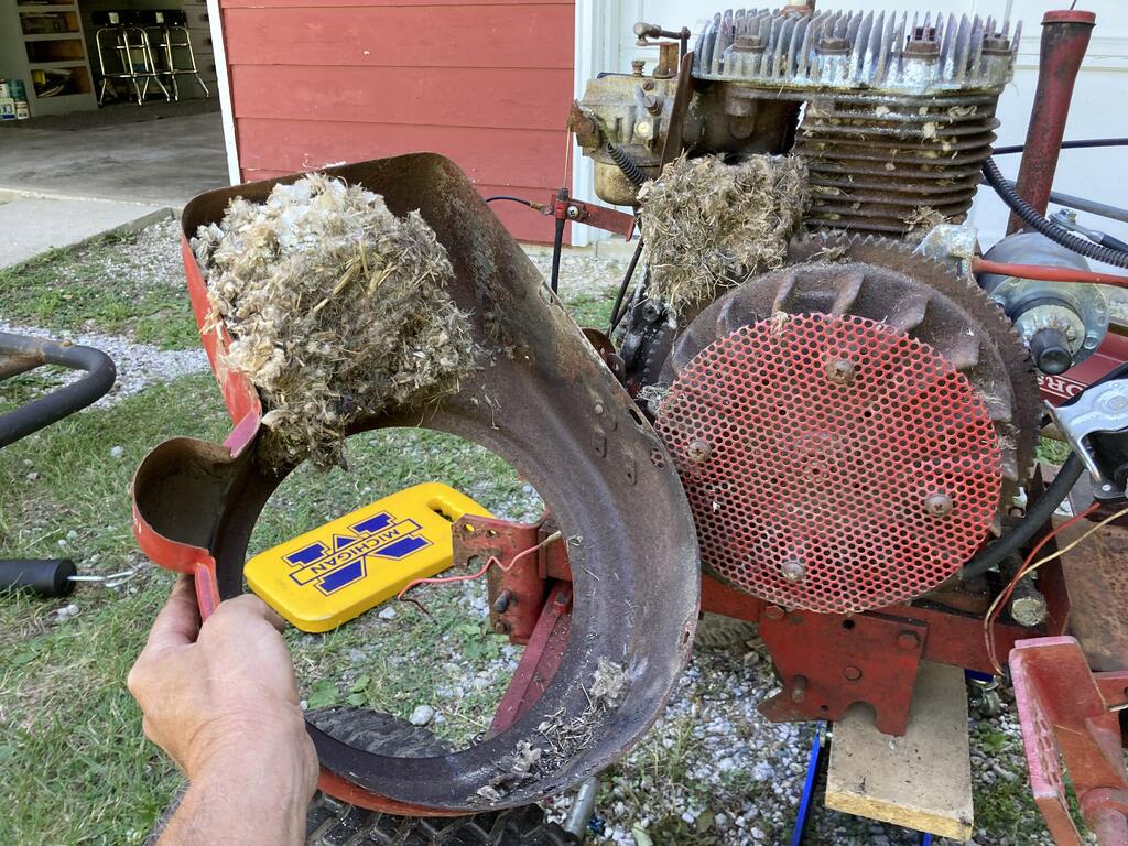

Blasterdad 3,167 #22 Posted June 19, 2022 Started on ol' 160 today, This is ALWAYS the first thing I do outside before I bring them into my shop. This was a BIG one. The inside of the tins will get sandblasted & painted, (they stink to High Heaven) & the block got sprayed down with bleach for an overnight soak. I'm thinking I might try a mod I've been wanting to do on this one, going to epoxy razor blades on each of the flywheel cooling fins & wire the debris screen to a bug zapper !!! I HATE VERMIN !!! 5 2 Share this post Link to post Share on other sites
ebinmaine 80,102 #23 Posted June 19, 2022 9 hours ago, Blasterdad said: VERMIN Yepp. Constant vigil is required around these parts. We keep bucket traps up when it's above freezing. Always have multiple traps set around sheds and yard. Small metal pieces fly around the yard at high speeds quite often. For the most part we do ok but occasionally find a nest where it can't be. 2 Share this post Link to post Share on other sites

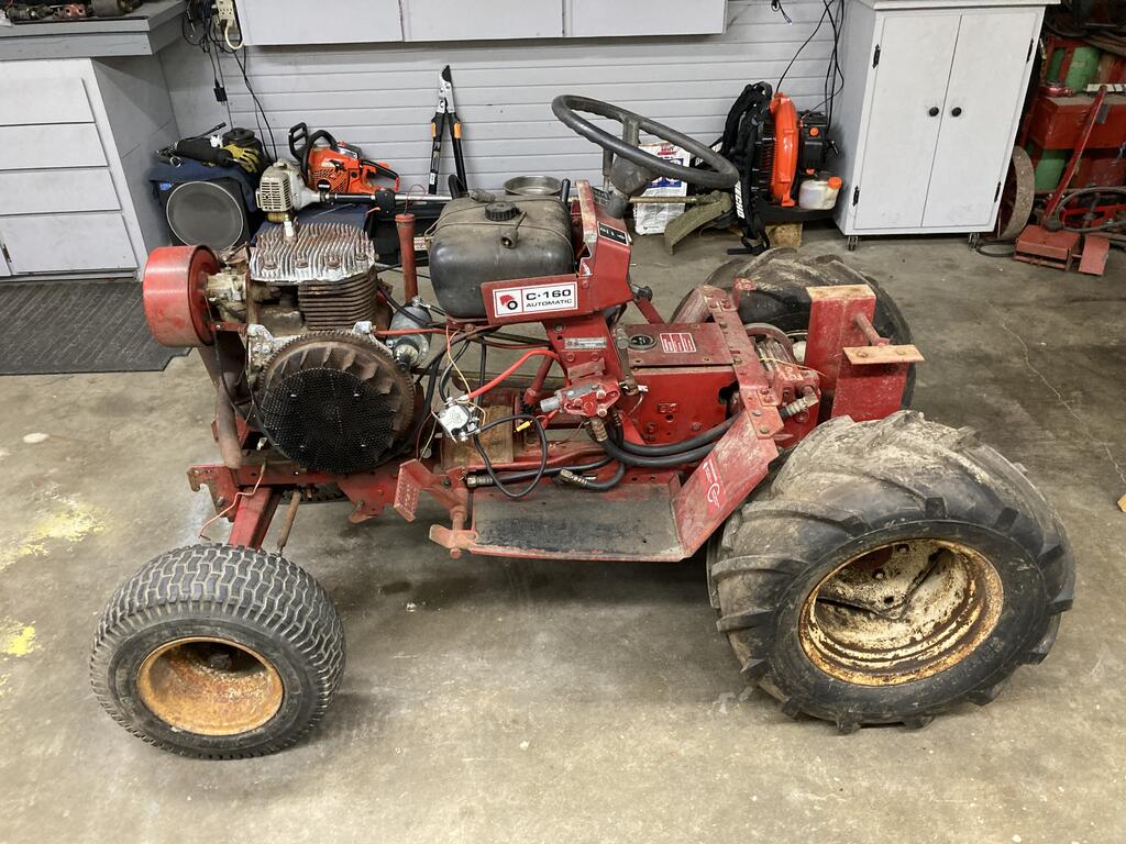

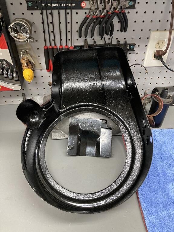

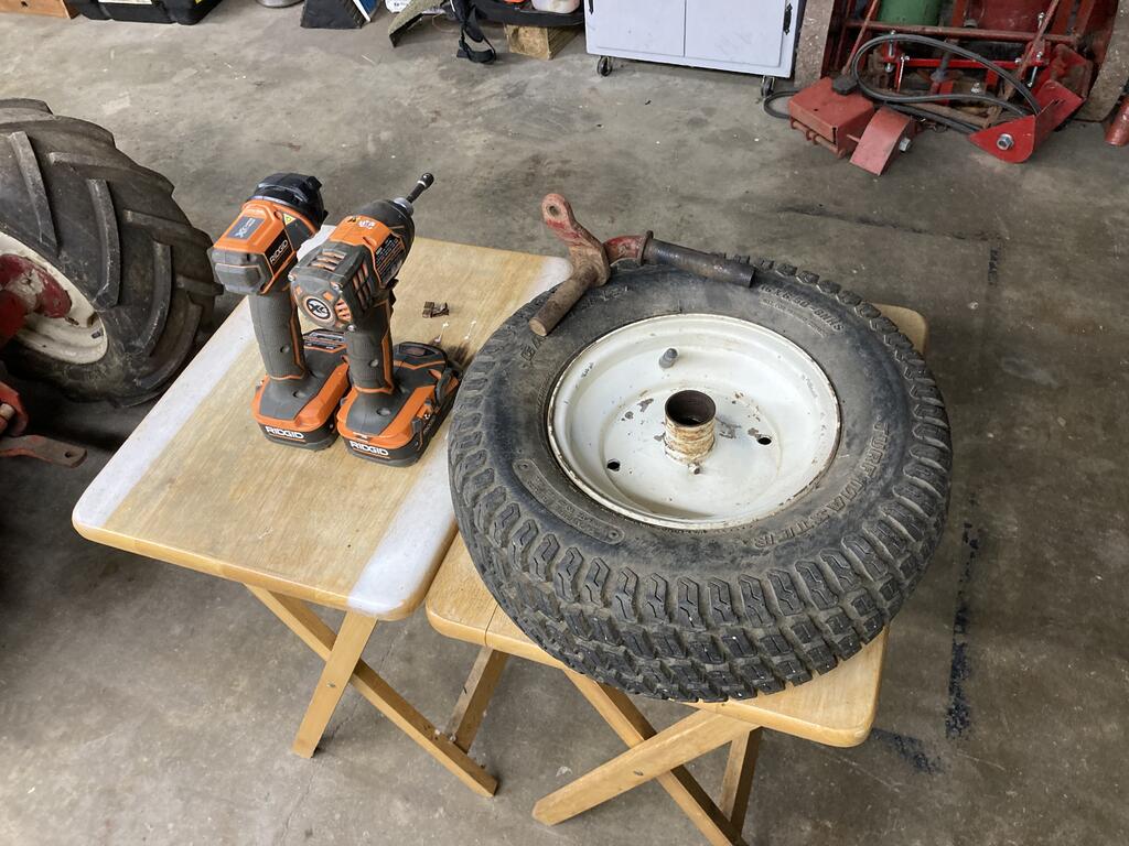

Blasterdad 3,167 #24 Posted June 20, 2022 In the shop after de-mousing, sandblasted tins & painted, front bearing on original wheel & axle was rusted on, it met Mr. Fire Wrench. 3 Share this post Link to post Share on other sites

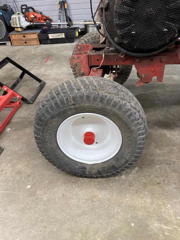

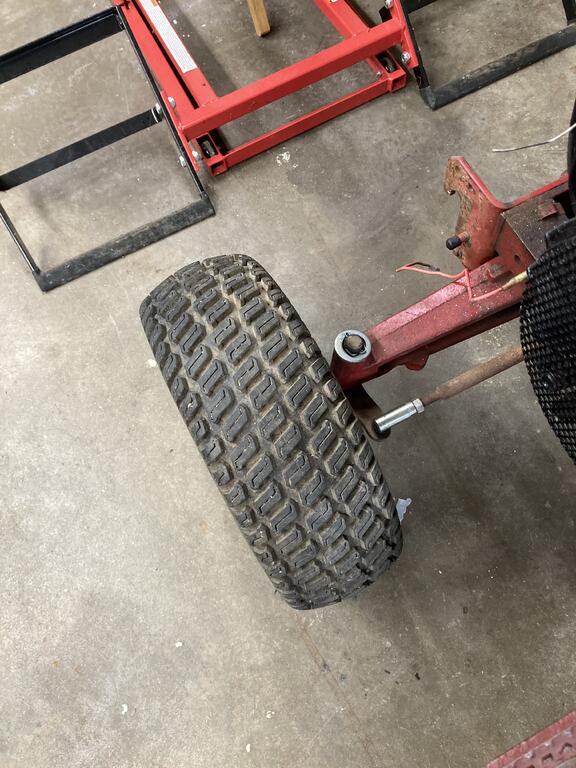

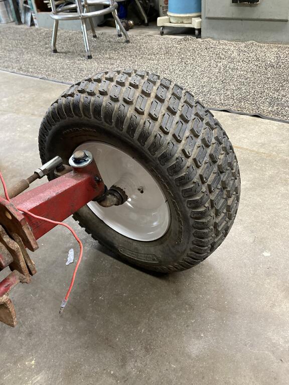

Blasterdad 3,167 #25 Posted July 8, 2022 Finally got most of my horse fixing done on my tractors so now I can focus on my friends C-160. Got the original wheel back on, axle fixed & aligned. The bearing had failed & chewed up the old axle which wallowed out the hub a little. I had to pean the back of the hub back into shape for the new bearing hence the chipped paint, but will touch it up later. (should have done it before painting it, ).Lol Tins are ready to go back on after I go through the fuel system. 4 Share this post Link to post Share on other sites
