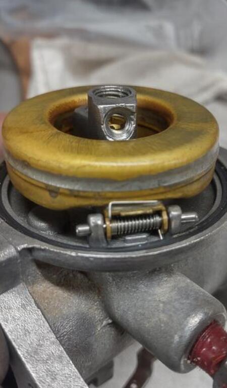

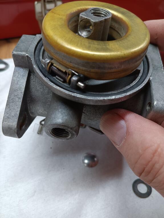

Handy Don 17,716 #126 Posted July 28, 2024 50 minutes ago, ebinmaine said: It doesn't though... The short tang is still held in place by the gasket just as the opposite way round. I’d be suspicious of any orientation that can disturb the gasket seal either on the bowl or the body. I think it is on backward. To my eye, the long tang is supposed to engage with the rectangular nub on the body under the float pivot shaft. The short tang is against the frame of the float where you saw the rubbed clean area. 1 1 Share this post Link to post Share on other sites
ebinmaine 81,225 #127 Posted July 28, 2024 14 minutes ago, Handy Don said: I’d be suspicious of any orientation that can disturb the gasket seal either on the bowl or the body. I think it is on backward. To my eye, the long tang is supposed to engage with the rectangular nub on the body under the float pivot shaft. The short tang is against the frame of the float where you saw the rubbed clean area. You have an interesting thought there..... 1 1 1 Share this post Link to post Share on other sites
TractorEd 675 #128 Posted July 28, 2024 4 hours ago, ebinmaine said: It doesn't though... NOTHING TO SEE HERE! NOW MOVE ALONG … 🤫 1 Share this post Link to post Share on other sites
TractorEd 675 #129 Posted July 28, 2024 3 hours ago, ebinmaine said: You have an interesting thought there..... I was going to ask about that rectangle thing, but I couldn’t see under the spring/float good enough. That’s what I get for being shy. @Handy Don said it. And I think he may be right. 1 Share this post Link to post Share on other sites

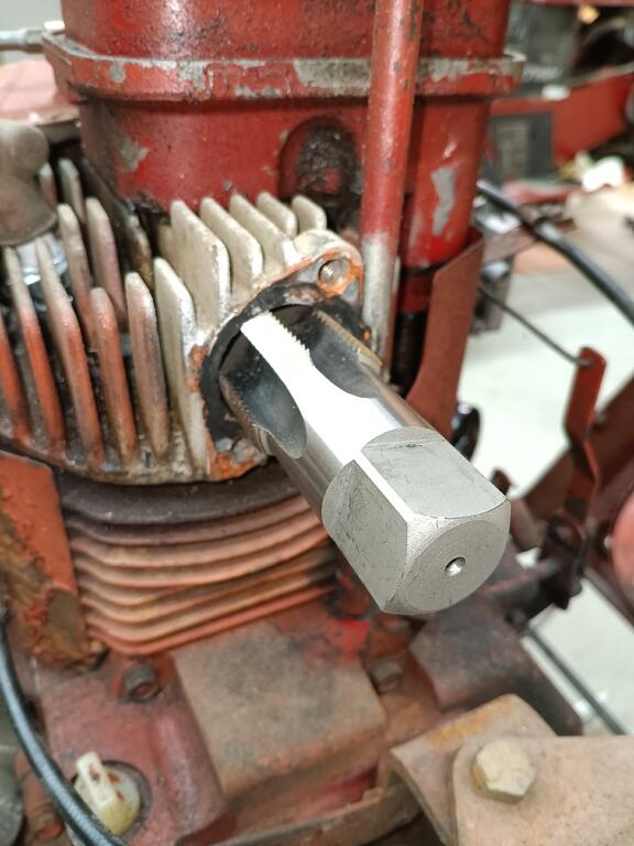

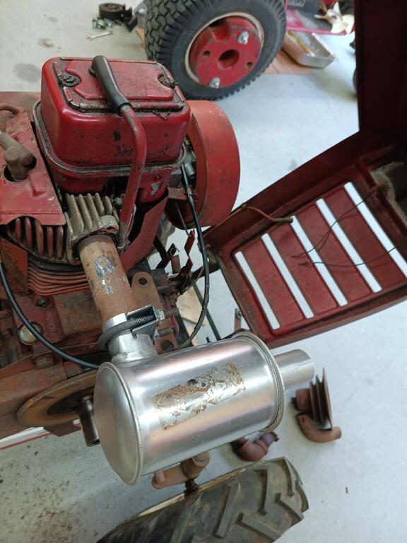

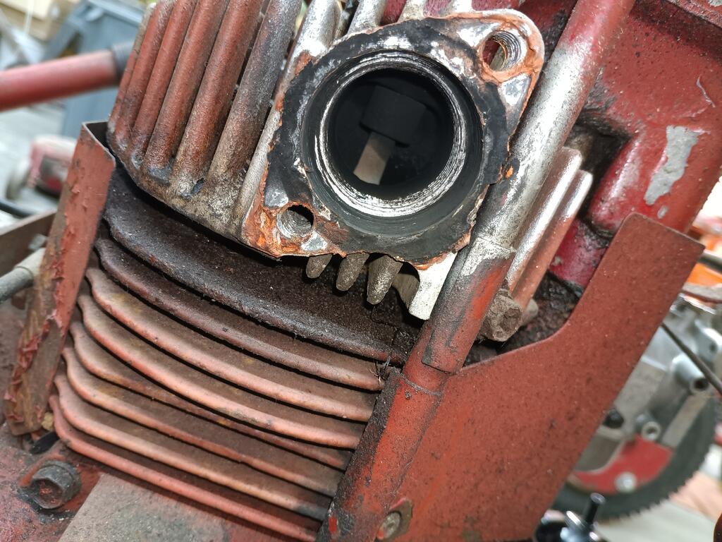

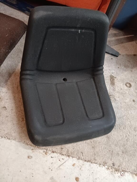

ebinmaine 81,225 #130 Posted July 30, 2024 I got a reply from a YouTube channel that has done these. If I get permission I'll post what he sent. I may have a tab missing from the float. More to come later there... In other news.. I have a nice seat here that I cleaned up yesterday. It's a very odd material. Rough. Grippy. Not at all smooth and shiny. It should be EXCELLENT for our rough terrain and woods usage. I used a tap to clean out the exhaust based on how another one of my C160-8 Tecumseh powered tractors is set up. I'll get a pipe to thread into the cylinder head instead of relying on two small bolts in a flange. 5 Share this post Link to post Share on other sites
Pullstart 71,541 #131 Posted July 30, 2024 Awesome stuff EB! You know, a guy with the right tools could make a sleeve flange pipe tube apparatus to support the exhaust both ways. Pipe threads AND tapped holes. 2 3 Share this post Link to post Share on other sites
ebinmaine 81,225 #132 Posted July 30, 2024 14 minutes ago, Pullstart said: Awesome stuff EB! You know, a guy with the right tools could make a sleeve flange pipe tube apparatus to support the exhaust both ways. Pipe threads AND tapped holes. Ooooooooooooooo I'm gonna have to put some thought process to that one! 3 Share this post Link to post Share on other sites
Handy Don 17,716 #133 Posted July 30, 2024 2 hours ago, Pullstart said: Awesome stuff EB! You know, a guy with the right tools could make a sleeve flange pipe tube apparatus to support the exhaust both ways. Pipe threads AND tapped holes. I was wishing I HAD tapped flange holes when I discovered there were no usable threads left in a K181 even after investing in the big NPT tap! Ended up “gluing” the nipple in with the ceramic JB weld. 2 Share this post Link to post Share on other sites

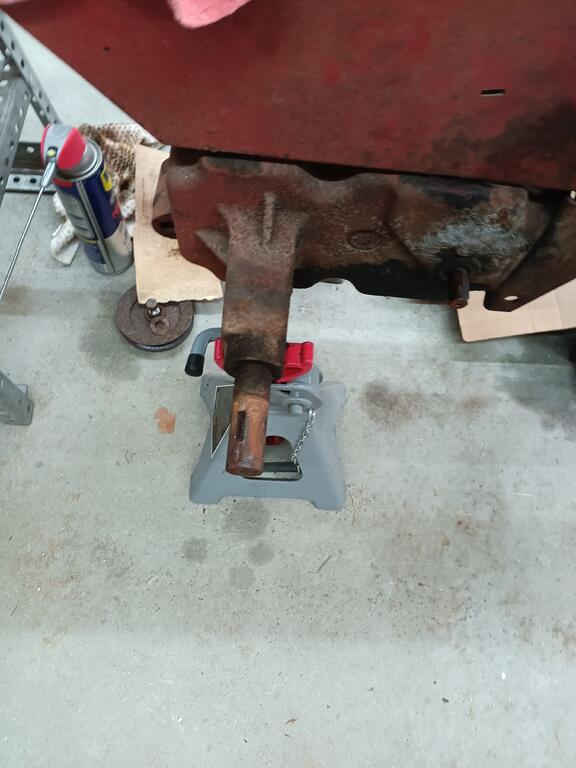

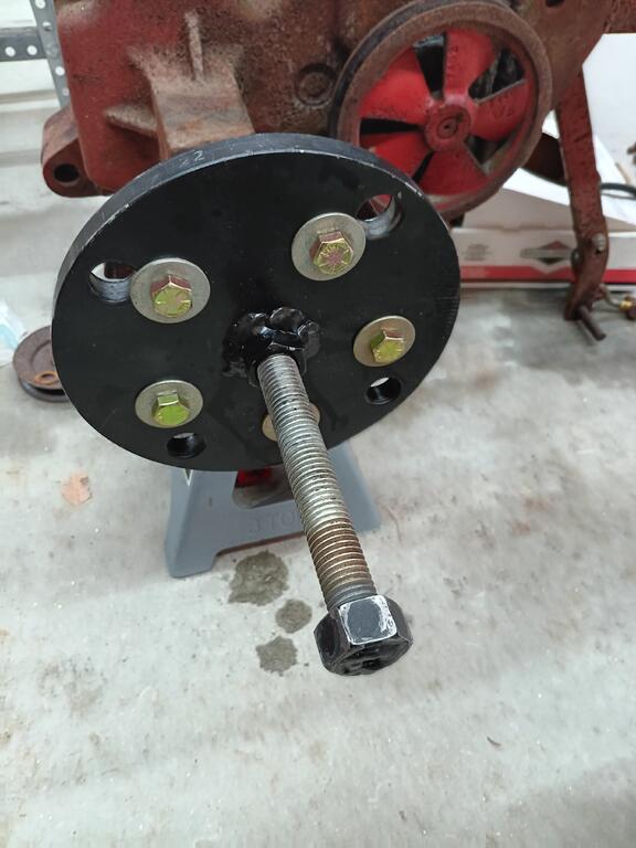

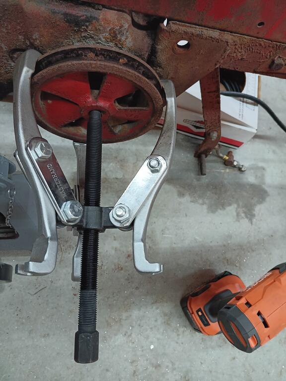

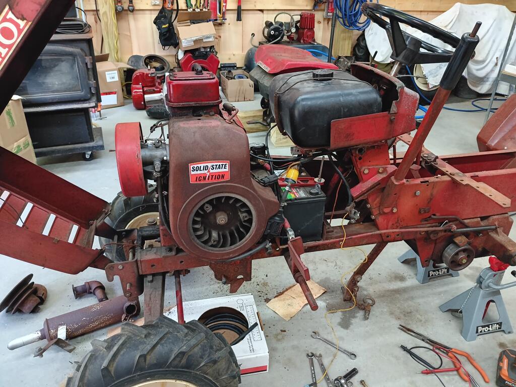

ebinmaine 81,225 #134 Posted August 3, 2024 Transmission drive pulley being removed. Attempt at removing both wheel hubs this morning. 2 Share this post Link to post Share on other sites

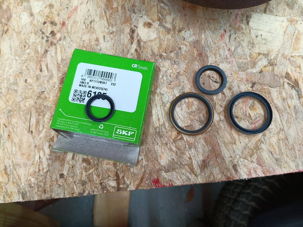

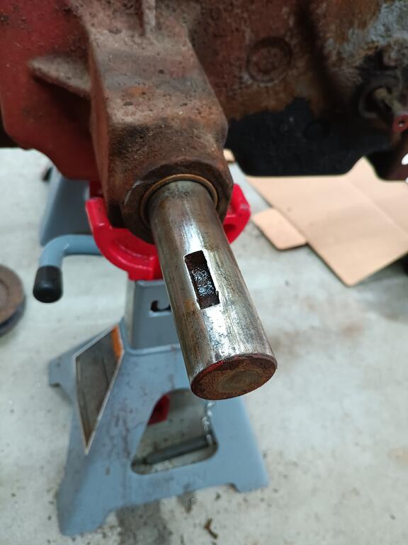

ebinmaine 81,225 #135 Posted August 3, 2024 Both hubs came off just fine. Almost no resistance from the right side. Minimal effort required for the left side. All four seals removed. One axle cleaned up. Seals ready for installation after cleaning is finished. 3 Share this post Link to post Share on other sites

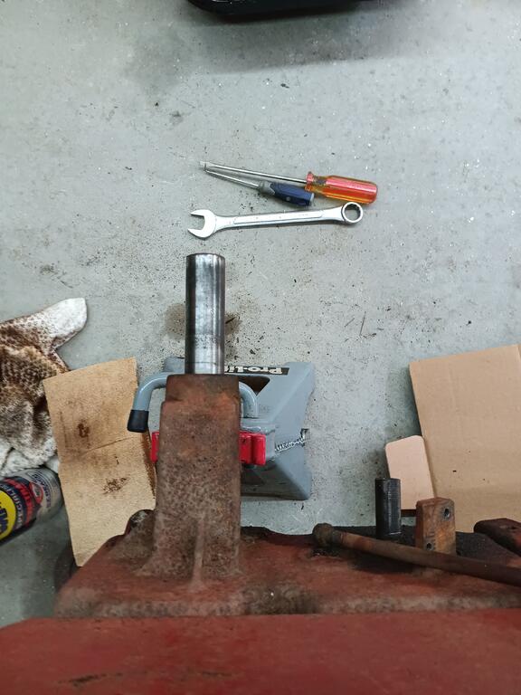

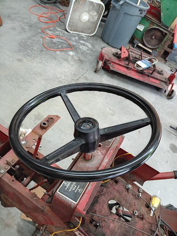

ebinmaine 81,225 #136 Posted August 3, 2024 Steering wheel on. New roll pin in. Wheel seals in. I use an old hub as a "driver".. Keeps the seals square and drives them right in with minimal effort. My audience this morning. 2 4 1 Share this post Link to post Share on other sites
Handy Don 17,716 #137 Posted August 3, 2024 7 minutes ago, ebinmaine said: My audience this morning. Just a couple of clucks--ignore ‘em! 1 3 Share this post Link to post Share on other sites

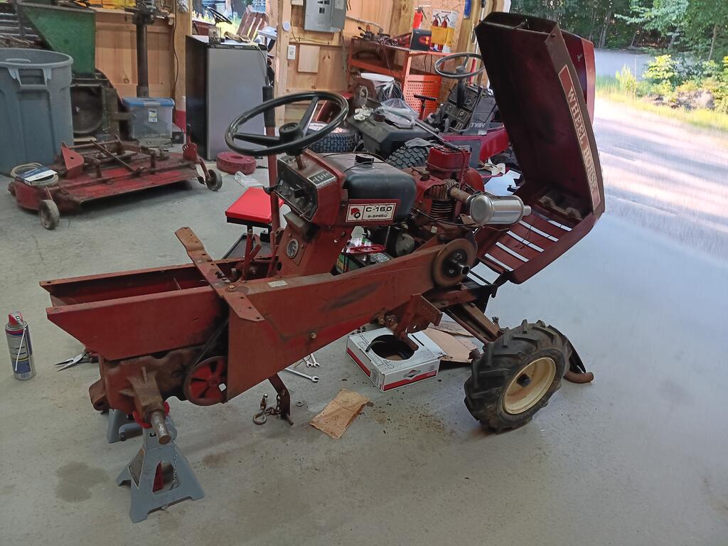

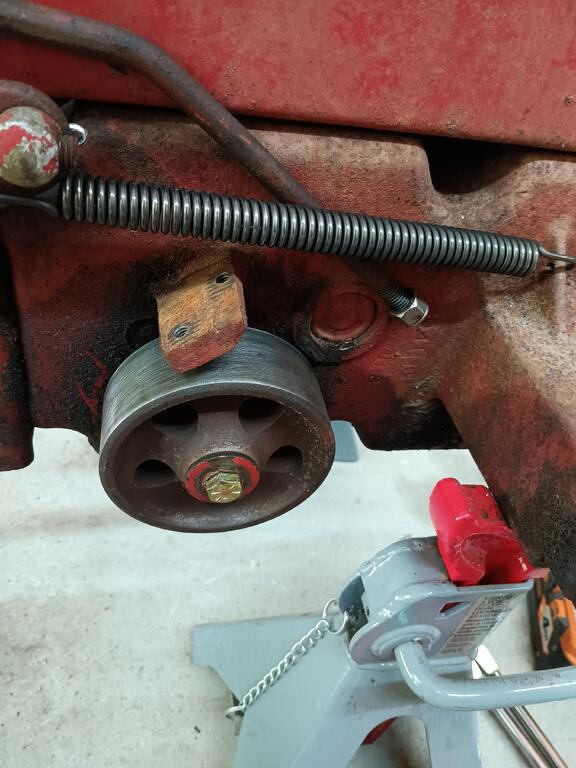

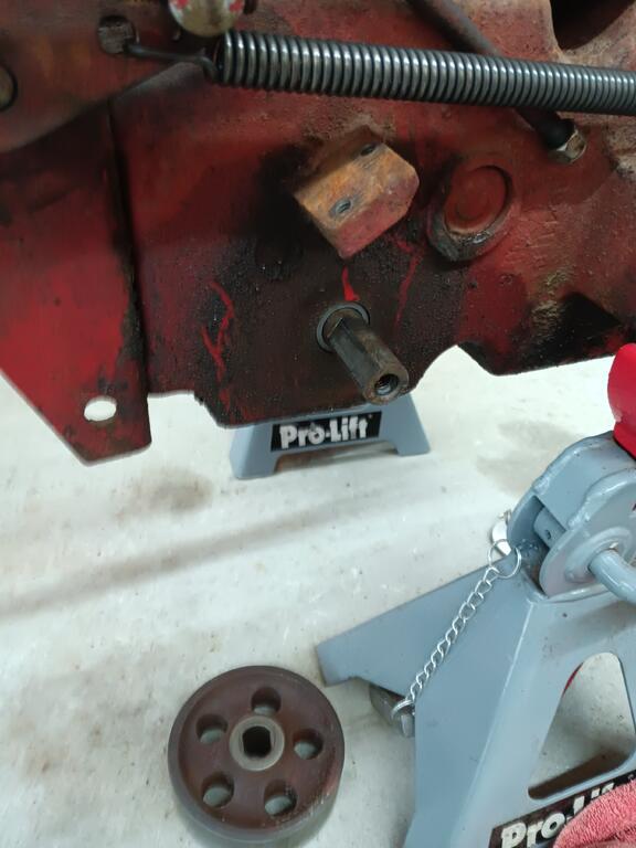

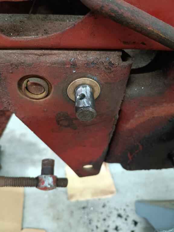

ebinmaine 81,225 #138 Posted August 4, 2024 A few days ago I'd ordered some bushings to take the looseness/ play out of the clutch pedal cross shaft. Today I watched a video on how to hand sharpen a large drill bit because I needed a 5/8' hole deeper than the step bits on hand. Got that bored out on both sides and tapped the bushings in place. To make a little room for the flanges of the new bushings I left the spring washer out of the right side and ground the arm a bit on the left. Got the transmission input pulley on. Also added a missing clutch pedal stopper bolt. I do have an issue to solve. The drive belt contacts the brake lever rod. I'll look at some other tractors and see what's happening. 1 Share this post Link to post Share on other sites

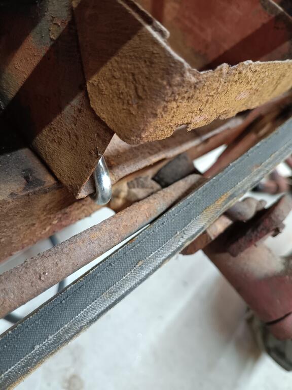

Moparfanforever 940 #139 Posted August 4, 2024 The drive belt contacts the brake lever rod. Engine pulley in to far?? 1 Share this post Link to post Share on other sites
ebinmaine 81,225 #140 Posted August 4, 2024 10 minutes ago, Moparfanforever said: The drive belt contacts the brake lever rod. Engine pulley in to far?? That's my thought too. Everything else looks OK. It's possible the brake rod is outta line a hair as well. There's other rods bent. ..... Share this post Link to post Share on other sites
ebinmaine 81,225 #141 Posted August 4, 2024 On 7/27/2024 at 9:57 AM, ebinmaine said: Deleted the video. Possible bad information. Here's a picture showing more likely proper orientation of the spring: On 7/28/2024 at 8:40 AM, ebinmaine said: After having read and mulled over the information I was seeing yesterday and finally finding my own picture I've decided to take the time to reverse the spring back to how I found it. I DO believe it would work either way on a Wheelhorse but I also believe in doing things right as often as possible. In the pics the longer "tang" MAY have the ability to create SLIGHTLY more pressure than the shorter tang. This could/ would change the operation characteristics. INCORRECT: CORRECT: As one could imagine this whole float spring deal was buggin me some. Either way I put it just didn't seem right. But..... It DOES actually belong the way it is in the pic above marked "correct" above it. Two of my Tecumseh carbs came apart the same way. On the plus side I did find I was missing a fuel restrictor of some sort that goes in the side of the bottom of the pickup tube that feeds the main jet. The carb is all back together and back on the engine. Share this post Link to post Share on other sites
Handy Don 17,716 #142 Posted August 4, 2024 39 minutes ago, ebinmaine said: Two of my Tecumseh carbs came apart the same way. I’m not convinced, sir. Absent clarity in a manual, especially since the spring’s purpose is still unknown, I can easily see any number of these being put together wrong during previous carb rebuilds. Having the spring touching the float body seems an invitation to friction and wear and holed float; having the spring touching the gasket in any way seems like a leak invite. 2 Share this post Link to post Share on other sites
ebinmaine 81,225 #143 Posted August 4, 2024 12 minutes ago, Handy Don said: I’m not convinced, sir. Absent clarity in a manual, especially since the spring’s purpose is still unknown, I can easily see any number of these being put together wrong during previous carb rebuilds. Having the spring touching the float body seems an invitation to friction and wear and holed float; having the spring touching the gasket in any way seems like a leak invite. I absolutely agree. I'm not 100% on board with this either but it appears to be the way it was designed either as built originally or in a later bulletin. I still haven't found a pic that I know is public share. 1 Share this post Link to post Share on other sites
ebinmaine 81,225 #144 Posted August 4, 2024 @Handy Don I found a paper manual that @c-series don sent Trina a few years ago. Unfortunately there's no clear Pic in it but the verbal description clearly implies that the gasket actually holds the shorter tang of the spring in place. It also shows a type of float that's not in either one of my carbs. Best I can do for now is try it out. Runs OK. ...win! Runs poorly.... I swap a fresh Kohler #30 carb on there and rearrange the linkage. 1 Share this post Link to post Share on other sites
Handy Don 17,716 #145 Posted August 5, 2024 38 minutes ago, ebinmaine said: Unfortunately there's no clear Pic in it but the verbal description clearly implies that the gasket actually holds the shorter tang of the spring in place. Well, I’ll step back and accept it! 2 Share this post Link to post Share on other sites

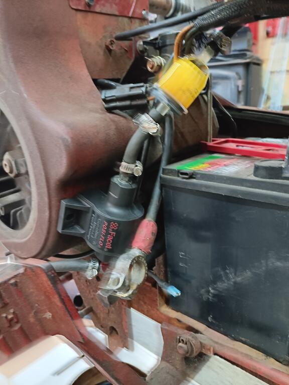

ebinmaine 81,225 #146 Posted August 7, 2024 We have fire! 2 1 1 Share this post Link to post Share on other sites

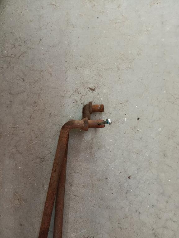

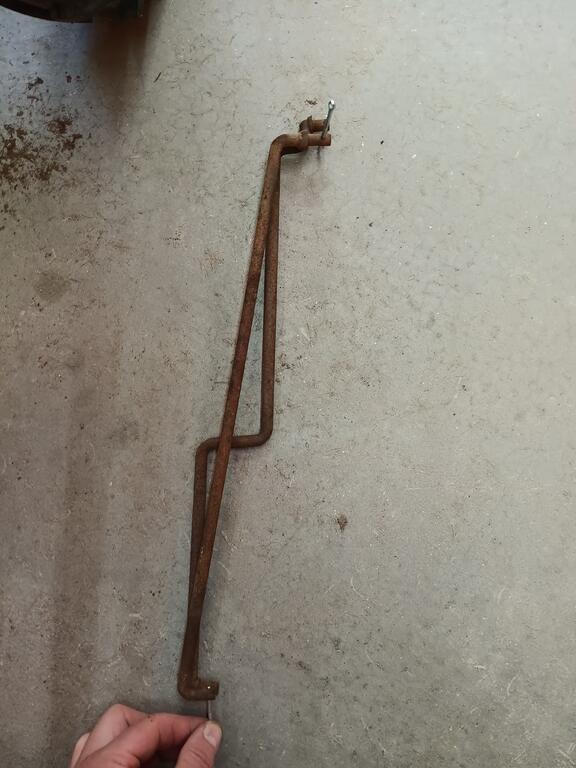

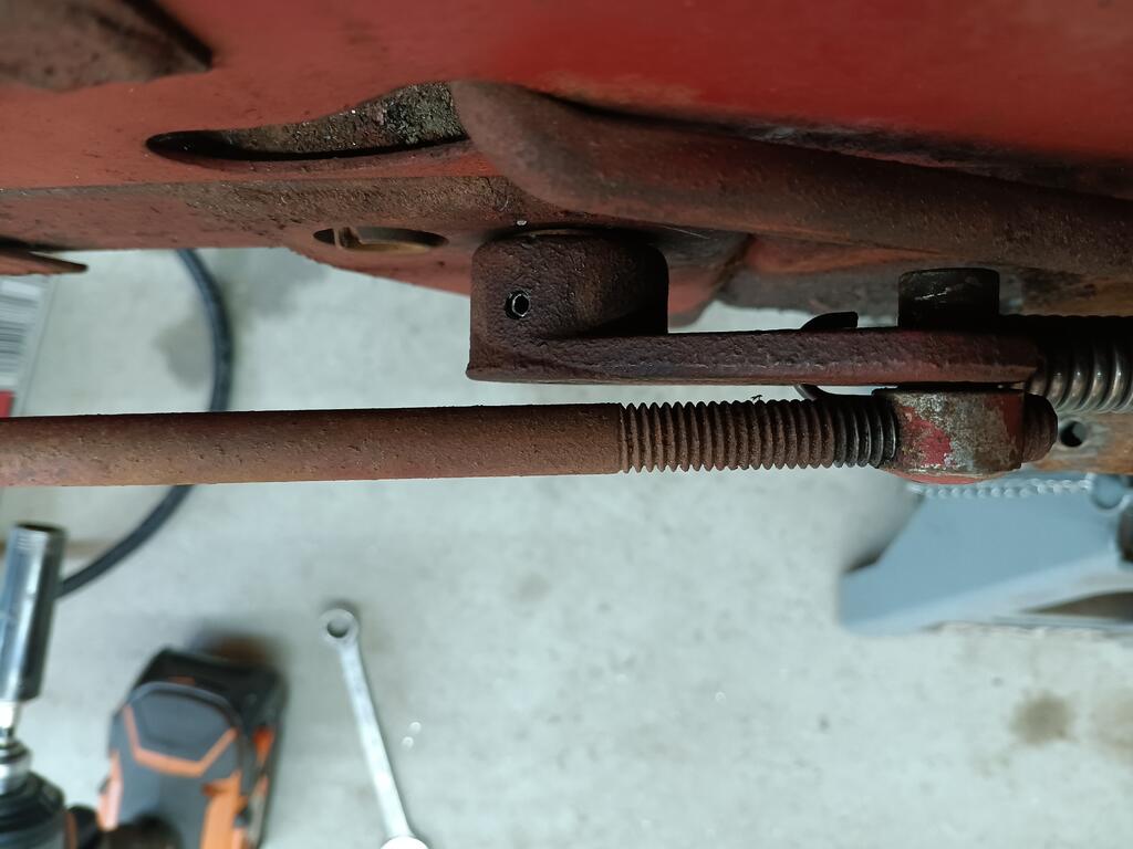

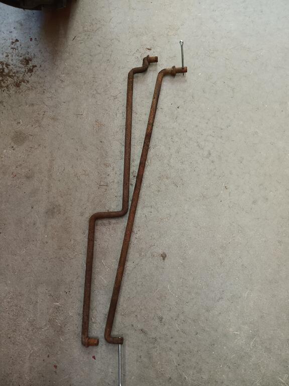

ebinmaine 81,225 #147 Posted August 7, 2024 Fair amount of things going on in my family right now so I took today off work as a "Tractor Therapy" day.. Made some good progress on this machine. Started out with waffles. Excellent start. As mentioned in an earlier post the brake rod was just not setting right. I went to the parts pile and got a Park brake lever. Installed that. It became instantly more obvious that the rod was too long and angled wrong. So I went back to the parts pile and found a couple of correct brake rods. Chose the least worn one and installed that. Better. Left is what was on. Right is correct. Note that it's angled wrong and too long. You can see the space next to the belt now. I also put a different brake shoe rod on. Less worn. Sets better. Brake drum seal installed. Brake drum on. I put a temporary muffler in place. Also installed the fuel system. Tank is cast 1990. Looks good inside. All new lines. New fuel filter. Reinstalled the Facet pump. New Aircraft Spruce tank outlet valve and grommet. 1 3 Share this post Link to post Share on other sites

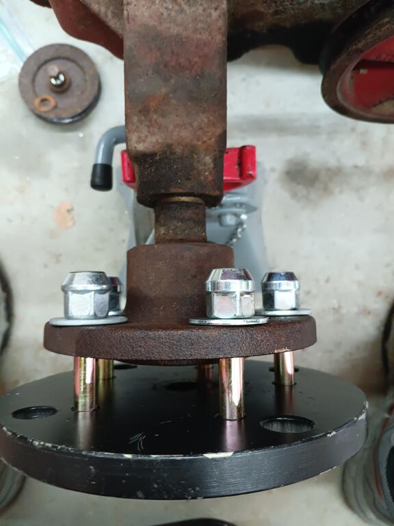

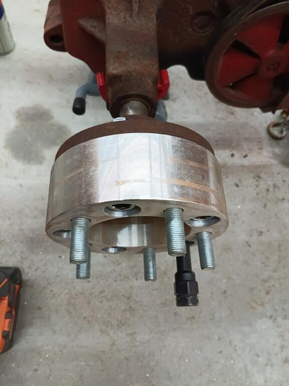

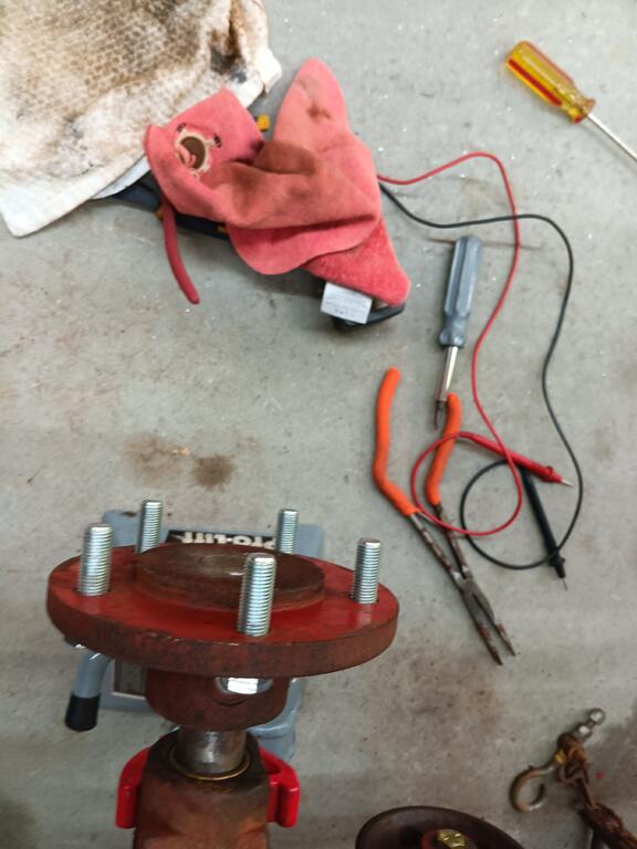

ebinmaine 81,225 #148 Posted August 11, 2024 Got the hubs cleaned out. Installed lug bolts. Hunted around for my 25+ year old bottle of never sieze that smells terrible and disgusting. Trina found it. Applied that nasty gunk to the axles and slid the hubs in place. I like having an extra wiiide rear for stability on our rough terrain. Got the shifter dog point set screw adjustment a little tighter. Transmission oil topped off and shifter boot on. Shifter top plate installed. Had to replace the inner and outer fasteners that hold it. The park brake lever end cover is back on. I decided to use the bulldog shift knob I'd picked up years ago for my first Horse, the 1974 B80. 1 3 Share this post Link to post Share on other sites
kpinnc 19,088 #149 Posted August 12, 2024 (edited) On 8/3/2024 at 9:28 AM, ebinmaine said: Attempt at removing both wheel hubs this morning. Nice puller design! The extra 4+ inches you'll get from those spacers definitely adds to the track width and stability. I love wheel spacers! Edited August 12, 2024 by kpinnc 2 Share this post Link to post Share on other sites
ebinmaine 81,225 #150 Posted August 12, 2024 1 hour ago, kpinnc said: Nice puller design! Yessir it sure is! Not my build though. Works excellent. That was created by another crazy tractor person. 1 hour ago, kpinnc said: The extra 4+ inches you'll get from those spacers definitely adds to the track width and stability. I love wheel spacers! Yeah me too. Better stability. Extra room for chains if needed. And I just like the wide look. 1 Share this post Link to post Share on other sites
