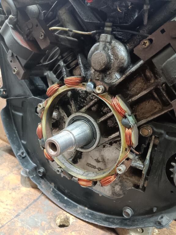

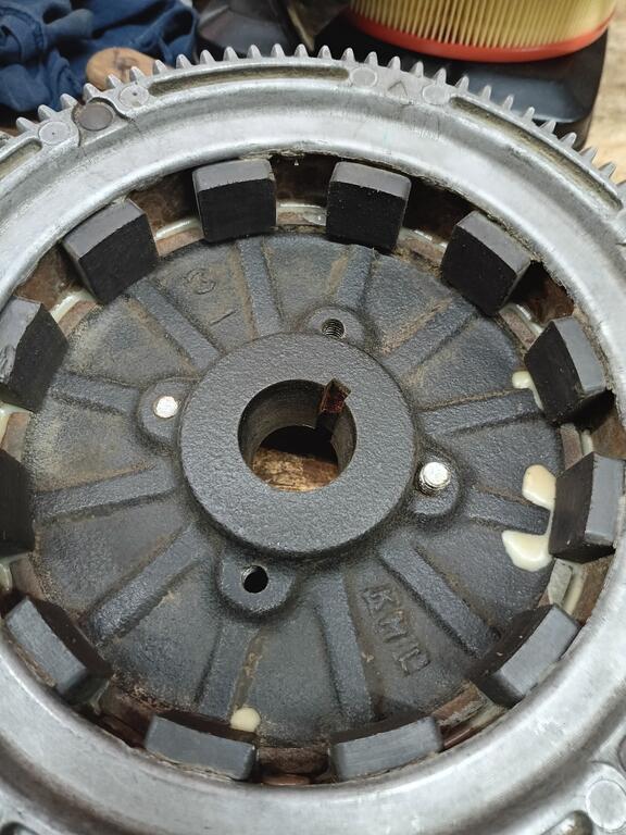

ebinmaine 80,684 #227 Posted December 22, 2025 Got a few minutes to work on cleaning the engine flywheel and inside the housing. Not sure how I'm gonna degrease this beast. Open to suggestions there. 3 Share this post Link to post Share on other sites
sqrlgtr 3,901 #228 Posted December 23, 2025 2 hours ago, ebinmaine said: Got a few minutes to work on cleaning the engine flywheel and inside the housing. Not sure how I'm gonna degrease this beast. Open to suggestions there. Do you think if you were reeeal carefull might use carb cleaner? 3 Share this post Link to post Share on other sites
ebinmaine 80,684 #229 Posted December 23, 2025 2 minutes ago, sqrlgtr said: Do you think if you were reeeal carefull might use carb cleaner? Mebbe. I've considered both carb clean and brake clean. 1 Share this post Link to post Share on other sites
gwest_ca-(File Mod) 12,485 #230 Posted December 23, 2025 Ever tried Super Clean in the purple spray bottles? I buy it by the gallon and use it on everything. Rubber gloves strongly recommended. Rinse off with water. Second application and it is ready for paint. 1 1 Share this post Link to post Share on other sites
ebinmaine 80,684 #231 Posted December 23, 2025 11 minutes ago, gwest_ca said: Ever tried Super Clean in the purple spray bottles? I buy it by the gallon and use it on everything. Rubber gloves strongly recommended. Rinse off with water. Second application and it is ready for paint. Ya know what? It's been years since I've had Purple cleaner here. Thanks for the reminder! 2 Share this post Link to post Share on other sites
Handy Don 17,473 #232 Posted December 23, 2025 2 hours ago, ebinmaine said: Not sure how I'm gonna degrease this beast. Open to suggestions there. Wiring with varnish insulation and any solvent that can dissolve grease are not gonna play well together. There are special cleaners for electronics that are useable safely on printed circuit boards, variable capacitors, etc. etc 5 Share this post Link to post Share on other sites
ebinmaine 80,684 #233 Posted December 23, 2025 4 minutes ago, Handy Don said: Wiring with varnish insulation and any solvent that can dissolve grease are not gonna play well together. There are special cleaners for electronics that are useable safely on printed circuit boards, variable capacitors, etc. etc Fair amount of area to clean. Might be easier to remove the magnetos or mask. 3 Share this post Link to post Share on other sites

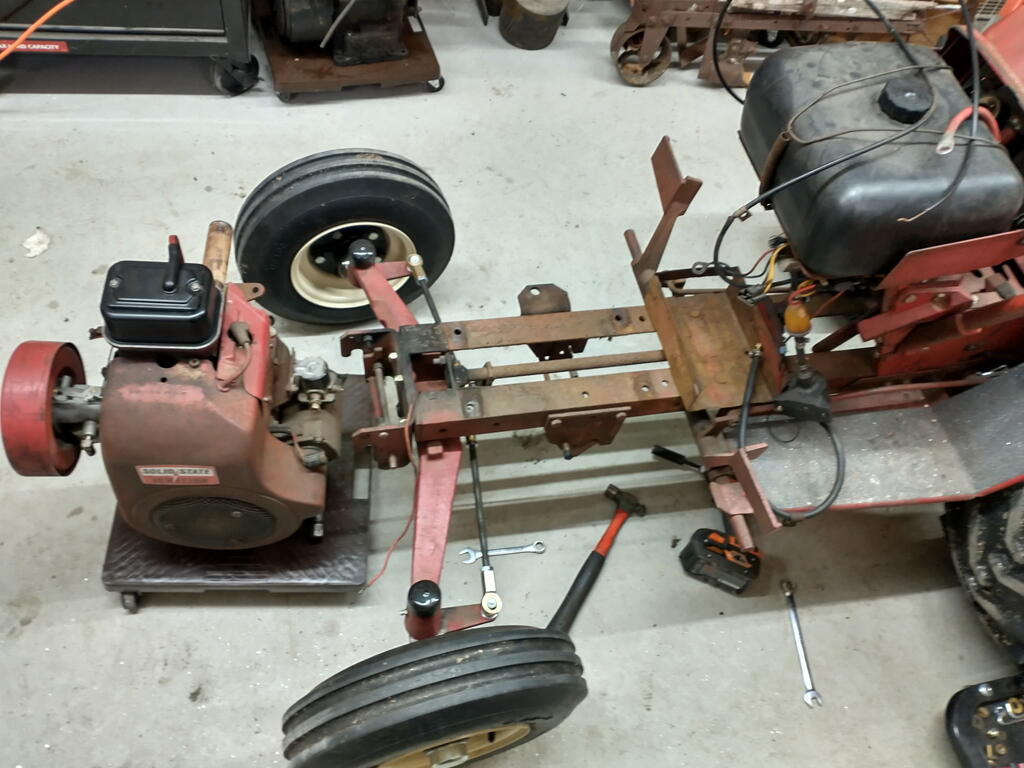

ebinmaine 80,684 #236 Posted January 1 Good progress today. The engine is off and setting in a roller dolly. Battery tray is out too. Next is the steering system. I've decided that since this tractor has great potential as a worker I'll install one of the Gear ⚙️ reduction steering setups I have. 2 2 1 Share this post Link to post Share on other sites

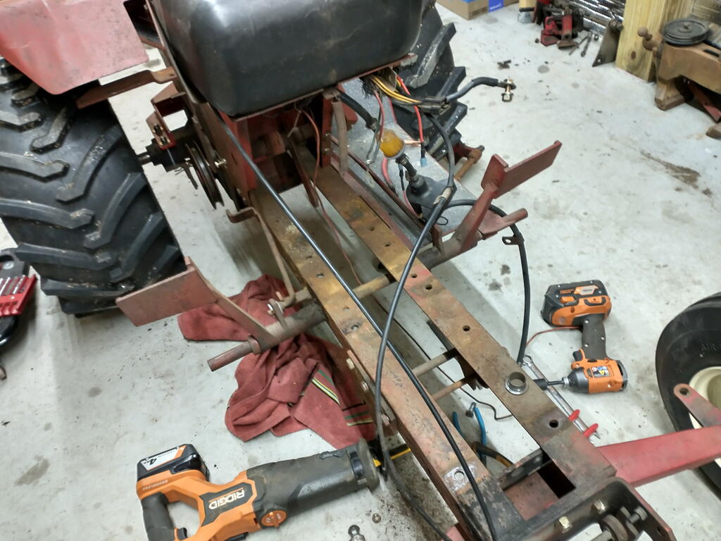

ebinmaine 80,684 #245 Posted January 1 Got the steering wheel hammered off. That was easy considering it was only just out on a few months ago. The upper shaft however was..... challenging. The locking collar below the dash panel was frozen. The lower gear was well worn and upon inspection we found a chipped tooth. I elected to cut the shaft at the lower gear. I saved the shaft for future use like tie rods or whatever and tossed the gear in the trash 🗑 We're now at the stage of continuing cleanup of the frame and preparing to install a gear reduction system I acquired from @Handy Don. 2 1 Share this post Link to post Share on other sites
