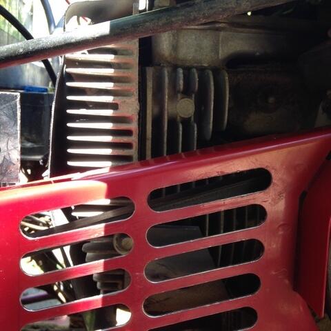

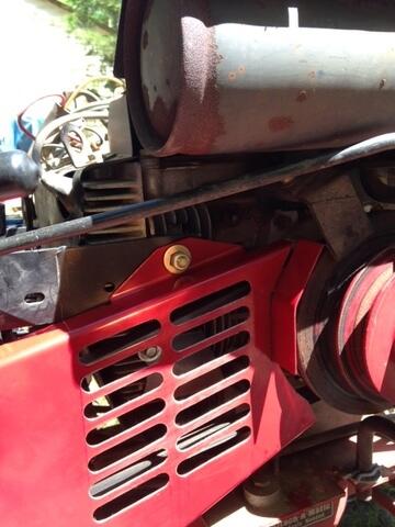

JAinVA 4,638 #7 Posted June 7, 2022 (edited) There is supposed to be a rubber seal at the oil filter area of the engine tin. Belt guard modifications to increase airflow are an option. They also help with checking on debris buildup on the rear fins. Edited June 7, 2022 by JAinVA 1 Share this post Link to post Share on other sites
