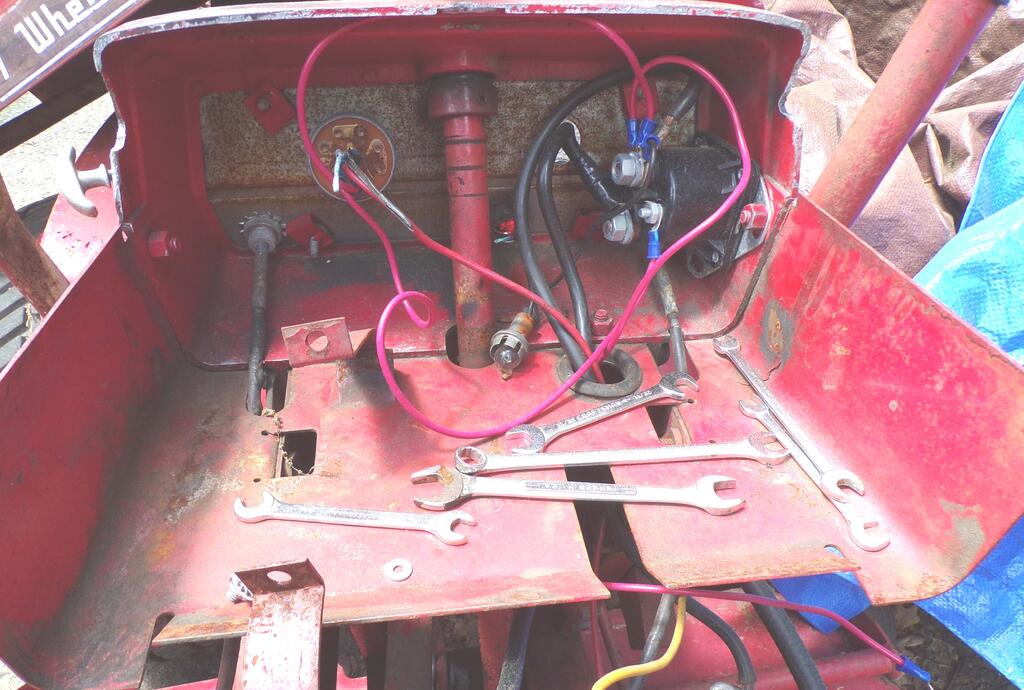

GaryRat 31 #5 Posted June 5, 2022 Here is a picture of what I have now. The back of the switch does not show up to good but you can see that it has more connection than the original which had three. One wire that appears to stick straight out is one that burned and was connected to the bulb. I'll go back out and take another picture that shows the back of the switch better. 1 1 Share this post Link to post Share on other sites
ebinmaine 77,821 #6 Posted June 6, 2022 Part of the issue in there I can see right away is that the cables going away from the solenoid are not thick enough and likely aged. If you're going to stay with that solenoid and 5 pin switch setup, the solenoid really should be moved down to a position closer to the battery and SG and proper 6 gauge cables installed. It would be a good idea to pick up three or four feet of seven conductor trailer wire so you can separate the circuits by color which makes them far easier to trace and install. 3 Share this post Link to post Share on other sites

GaryRat 31 #10 Posted June 16, 2022 I removed the remnants of the burnt wire from the ignition switch and also the other end which was at the generator light. I was able to start the engine then without any smoke! But I don't know if my battery is getting charged. I am not sure what ignition switch I have in the machine but it has five connection like the one in the above diagram. I am anxious to mow the lawn as it is getting quite tall so further wiring will need to be done later. Once I got it running another problem was revealed - I am think my transaxle may be shot! I'll post that issue in another forum. Share this post Link to post Share on other sites
