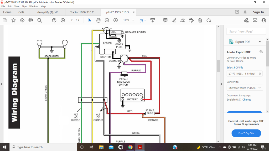

moe1965 774 #19 Posted June 5, 2022 15 minutes to answer tunahead72 question.... I'm in a real bad situation now. I may have crossed some wires. I removed the plug in I'm thinking factory plug that was original to the engine that comes out of the engine from behind the flywheel. And replaced it with a new plug because one terminal was broken and the others didn't look so good. The picture is the wires that are coming out from behind the fly wheel which wire goes to what . Right now the single black wore I have going to the positive side of the coil the other black wire I have going to the back of the ignition switch and it is labeled I. For ignition I'm presuming. The yellow wire is going to the back of a switch that turns lights on and off. Is this correct for what ever reason I blew a fuse and now I have no spark... I'm an idiot Share this post Link to post Share on other sites

Skipper 1,792 #23 Posted June 6, 2022 One easy option to all this could be to just mount a 10$ "kohler" rectifier, and be done with it. Simple rewire. That is if it is not just the handheld meter that is wrong. Try it on a car! Should say very close to 14.4v running engine. 2 Share this post Link to post Share on other sites
moe1965 774 #24 Posted June 6, 2022 Voltage this morning was 12.60 on the battery with engine not running. I will put a rectifier on it . which line would I splice it into. 1 Share this post Link to post Share on other sites

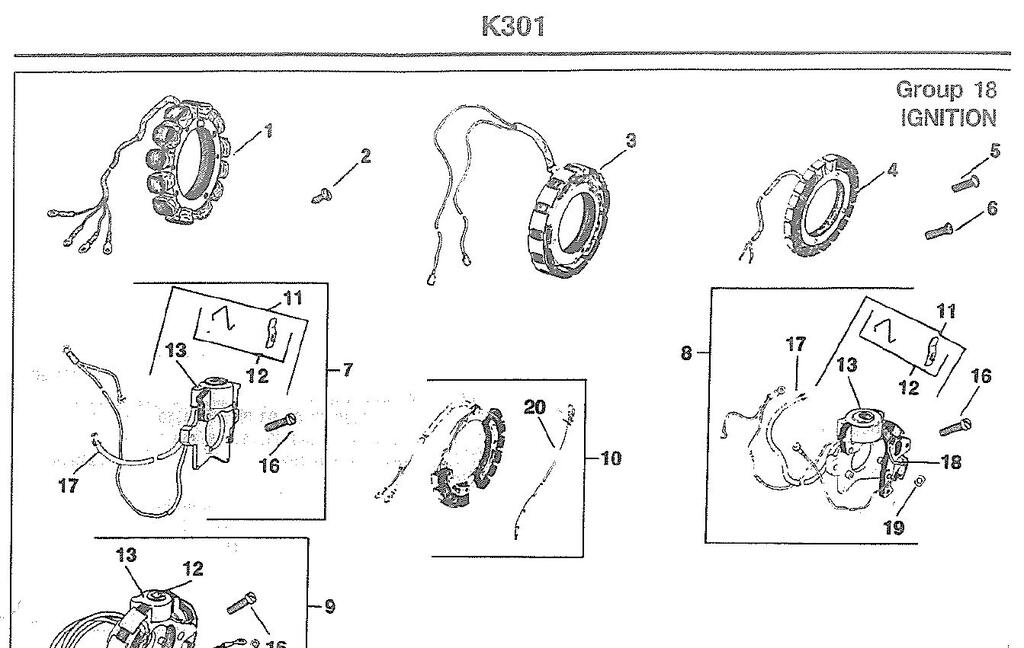

pfrederi 21,172 #25 Posted June 6, 2022 (edited) I do not think you can just "add" a rectifier. The stator used for your 3 amp unregulated system is different than the ones for 10 or 15 amp regulated systems. Your stator would be #10 (10 and 15 amp system use 3 or 4) Edited June 6, 2022 by pfrederi Share this post Link to post Share on other sites
