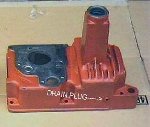

Mike C160 251 #1 Posted June 3, 2022 Greetings. That tiny little plug near the draw bar....is that really the drain plug for the hydro unit??? Cheers 1 Share this post Link to post Share on other sites
daveoman1966 3,884 #2 Posted June 3, 2022 Yep... Here it is. 1 1 Share this post Link to post Share on other sites
Mike C160 251 #3 Posted June 3, 2022 Just now, daveoman1966 said: Yep... Here it is. Wow. Thanks. Not the biggest of drain plugs. Cheers Share this post Link to post Share on other sites
