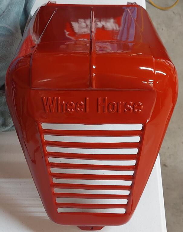

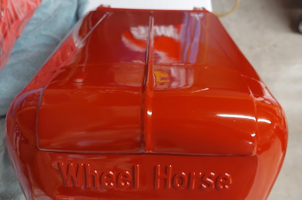

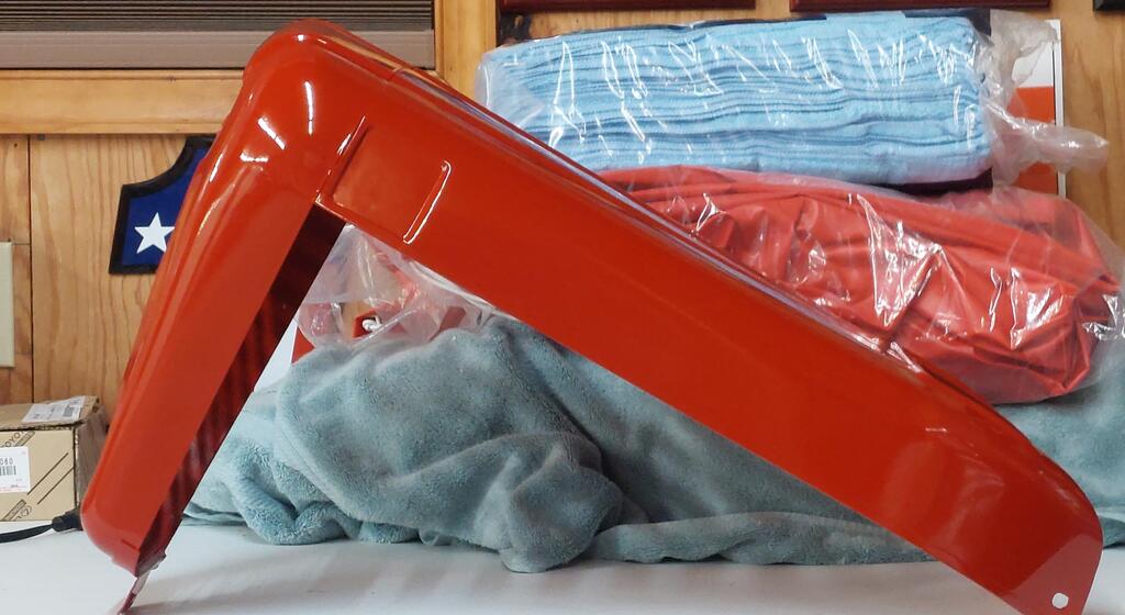

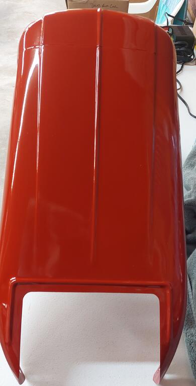

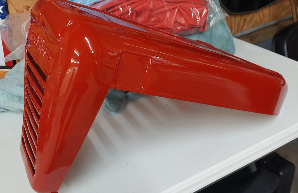

dmoore 1,024 #102 Posted August 18, 2022 Hood should be done this weekend. Share this post Link to post Share on other sites

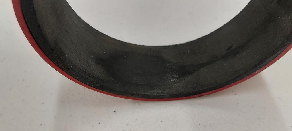

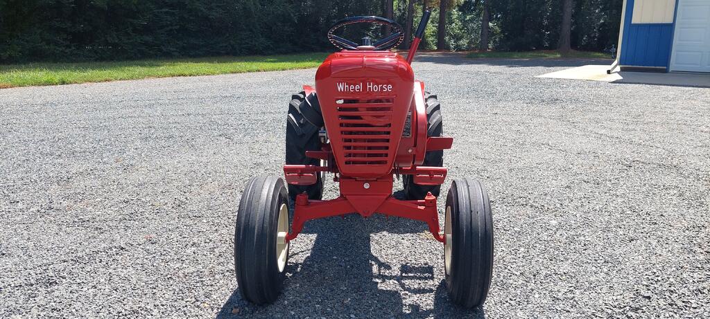

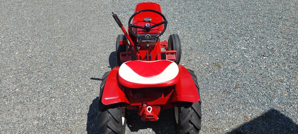

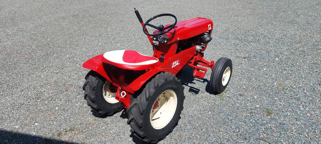

dmoore 1,024 #104 Posted August 30, 2022 (edited) Mounted the hood and made a few adjustments today. I'm really happy how this little tractor came out. Had some noise initially coming from the brake pad. Removed it and the noise went away so I guess I will sand down a little of the top portion of the lining. You can see the dark spot where it was hitting without applying the brake. Thanks to all who helped out along the way and I hope this restoration will help someone in the future. A special thanks to Terry for his fabulous decals! Edited August 31, 2022 by dmoore Share this post Link to post Share on other sites
Handy Don 16,062 #106 Posted August 30, 2022 2 minutes ago, dmoore said: Removed it and the noise went away so I guess I will sand down a little of the top portion of the lining I'm not a heavy brake user, but I do like to count on them when applied! On the four tractors I've refurbished, all had plenty of lining but it was glazed or weathered and looked iffy to me. As you are planning, I did a bit of sanding with a medium grit flap drum to take off the glaze or weathered material and they all work great. Share this post Link to post Share on other sites
dmoore 1,024 #108 Posted September 1, 2022 Removed the brake band and sanded off a little material at the top. re-installed, no more noise. Share this post Link to post Share on other sites
