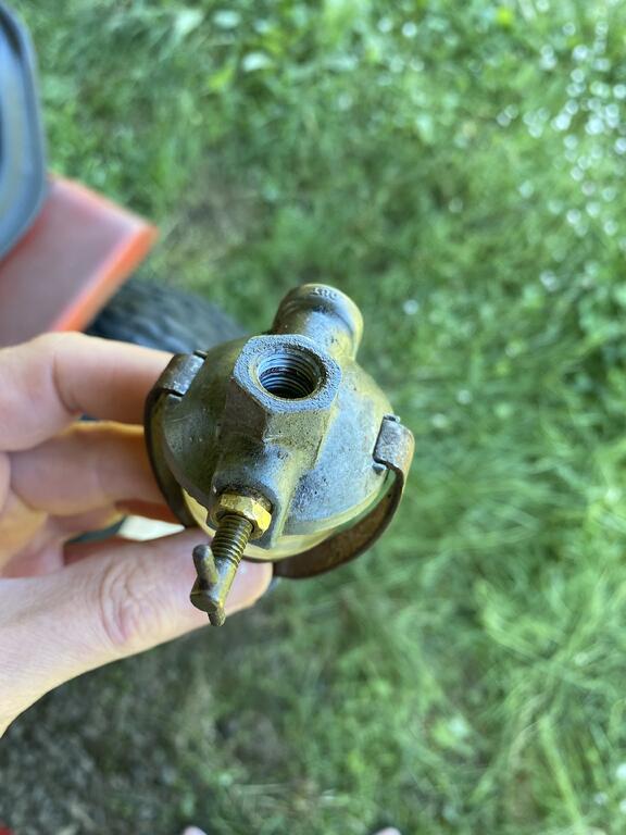

Ponyboy 64 #1 Posted May 31, 2022 After having my 875 up and running for 1 day, the sediment bowl decided to start weeping at its shutoff valve. I’ve decided to do like others have done and forego the bowl for a straight shut-off valve. Are there models that screw into the existing threaded nipple coming out of the tank (don’t know the measurement at the moment) that you would recommend? Thanks! Share this post Link to post Share on other sites

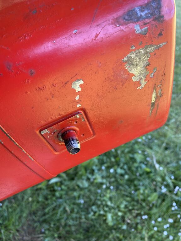

Ponyboy 64 #9 Posted May 31, 2022 (edited) Here’s a shot of the bottom of the tank, showing where the bowl assembly attaches. I forgot to check, but doesn’t that look like a rubber grommet around the nipple? Edited to add, I'm now just realizing that that piece sticking out is likely not part of the tank, was added to accommodate the shut off like others have mentioned (slow Tuesday morning after a long weekend, sorry). So I should be able to unscrew that piece and install a valve like Achto shared (or leave it in and grab a few adapter pieces). When I removed the bowl assembly and looked down inside from the top into the threaded area, the black rubber seal for the shutoff was partially sticking up, torn…the culprit. Edited May 31, 2022 by Ponyboy 2 Share this post Link to post Share on other sites
Achto 32,347 #10 Posted May 31, 2022 1 hour ago, Ponyboy said: I forgot to check, but doesn’t that look like a rubber grommet around the nipple? That is just a raised portion of metal around the threads. I can see threads on the nipple where it goes into the tank. Use a little thread sealer when you install the new petcock. 3 Share this post Link to post Share on other sites
rjg854 13,311 #11 Posted May 31, 2022 3 hours ago, Ponyboy said: That's what the tank looked like on my 1045, I just took that nipple out of the bottom tank and screwed the new shut off in, in place of the sediment bowl. 1 Share this post Link to post Share on other sites
Ponyboy 64 #12 Posted May 31, 2022 OK, thanks everyone! I got the nipple removed and the new shut-off valve ordered. I ran new fuel lines the other day and included a clear in-line filter already so should be a quick install near the tank. 4 Share this post Link to post Share on other sites
