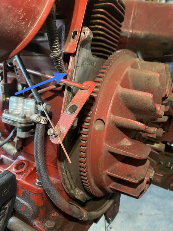

The black wire going up behind the fuel pump. show us where that leads to. Lets make sure what kind of ignition it has The engine may have been changed.
Pulled off the shrouds but still can’t trace where this little black (oversprayed red, blue arrow) wire goes other than it looks to run with the spark plug wire then terminates somewhere behind the flywheel

OK you still have the trigger ignition. If the  little wire from the switch that goes under the fly wheel got power from the switch
(OK — touching test light from B+ on battery now shows test light on at ignition/starter and ignition/magneto ) It's fried, That switch shouldn't have put power on that little wire at the switch unless the switch has an internal short which could explain the pop you heard.

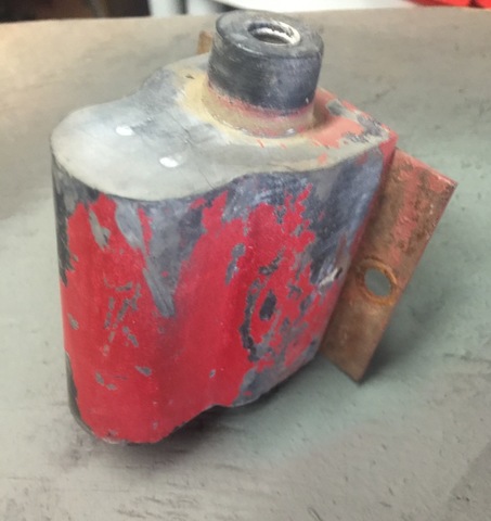

Do you have a unit like the one in this photo on your engine? There is a great deal of speculation going on about what type of ignition system your engine has, The number on your fan shroud tells us that this is the type of ignition you have but that wouldn't have points and condenser. Since the fan shroud is interchangeable to any Kohler engine we can't be sure from what we are seeing. What does the spark plug wire connect to? Does it run behind the flywheel too?
Negative - I have no unit like that
pictured
Spark plug wire runs behind flywheel to rectifier/regulator

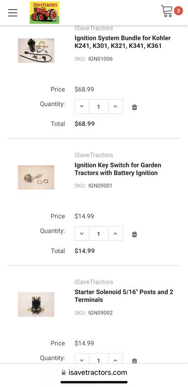

How does this shopping cart look? I have AWG 16 wire on hand.
  • Thanks 1
953 nut
:handgestures-thumbupright:     looks like you are on your way!

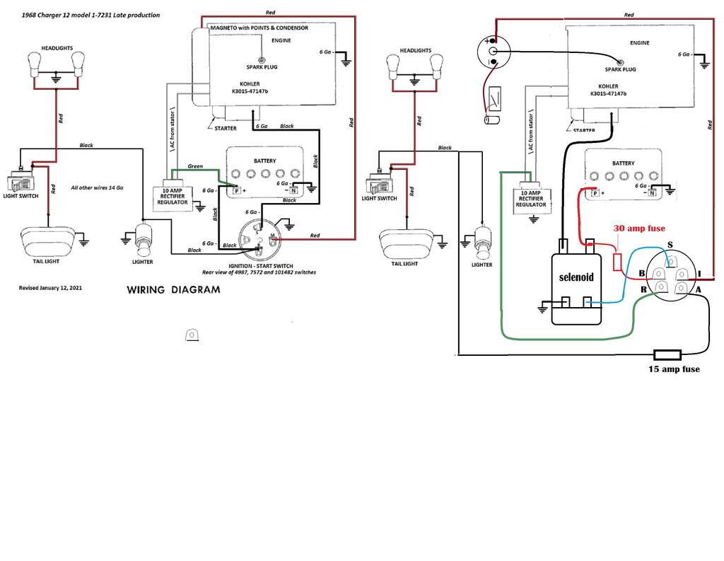

You don't have to remove the magneto, just leave it in place. I have written up a plan of attack for you and a wiring diagram. The colors of the wires are not important, just a way of seeing where they go. I placed the wiring diagram side by side so you can see that most of your wiring components stay as is. If you have questions be sure to ask.
65896656_1968Charger12lateproductionwiring.thumb.jpg.e71352378d520a04931e7c797fbf9e28.jpg
The modifications required to install your new ignition system are very easy to accomplish, we will go step by step.
1, Remove the cables from the battery so we don’t have any sparks flying.
2, Remove the wires going to your present ignition switch and replace the switch with your new one.
3, Locate the solenoid where it is accessible and will have a good ground to the engine/battery. Connect one of the small terminals to ground with a small jumper wire.
4, Put the #4 cables that went to the old ignition switch on the solenoid, one on each large terminal, doesn’t matter which one. On the large terminal that will be connected to the battery add a 30 Amp fuse holder that will go to the “B” terminal on the ignition switch.
5, Move the green wire that comes from the voltage regulator from the battery post to the “R” terminal of your new ignition switch.
6, Connect the “S” terminal of the ignition switch to the ungrounded small terminal of the solenoid.
7, Run the wire presently going to the battery from the cigarette lighter/lights to the “A” terminal of your ignition switch and include a 15 or 20 Amp fuse holder.
8, Mount your ignition coil and run a wire from the “I” terminal of the ignition switch to the “+” terminal of the coil.
9, Install your points and condenser gapping the points to .020” maximum opening. The points and condenser will attach to the “-“ terminal of the ignition coil.
10, Now you have five wires connected to the ignition switch; two #4 cables, a ground and the ”S” wire connected to the solenoid; the ignition coil, points and condenser connected. One of the #4 wires is already connected to the starter so all that is left to do is connect the battery cables, start the engine and enjoy the ride.
  • Excellent 1

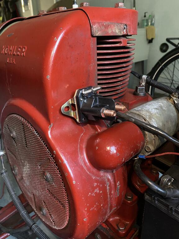

Question: Where would be an appropriate location to mount the new solenoid?
953 nut
I would mount the solenoid to the area just below fuel tank close to the battery and engine. Guess your new cables are long enough to reach there.
BrianKoch
How about here on the flywheel cover?
  • Excellent 1
953 nut
I have seen them mounted there too, should work well.
