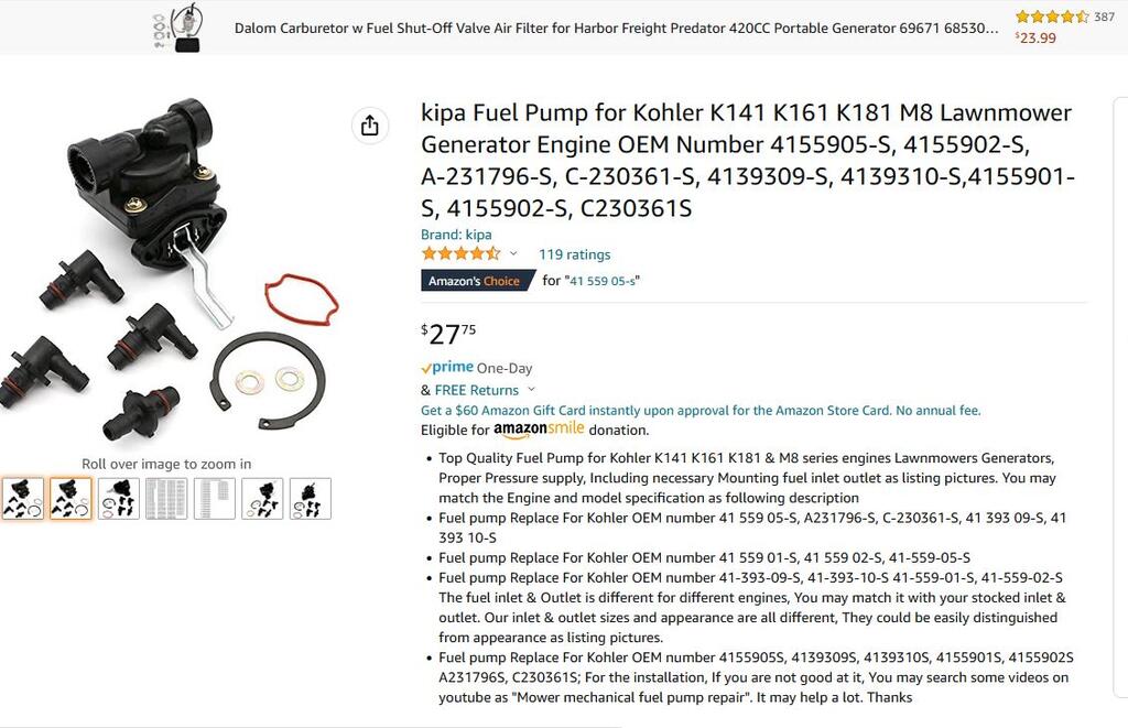

pfrederi 21,301 #2 Posted May 28, 2022 Lots of after market ones...I replace any failed mechanical pump with an electric one. i use Facet posiflo made in USA Knock off 2 Share this post Link to post Share on other sites
pfrederi 21,301 #3 Posted May 28, 2022 If you buy a mechanical one make sure it has the offset arm as show in picture above. Straight arms are for 10hp and up 1 Share this post Link to post Share on other sites
