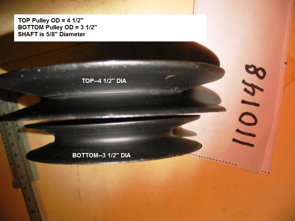

daveoman1966 3,883 #2 Posted May 28, 2022 My guess: Presuming the center pulley is the correct one: Your 'new' deck drive pulley is mounted upside-down. This error is VERY typical and all you gotta do is flip it over so that the 4.5" side of the pulley is UP...and the narrower 3.5" side is down. 5 1 Share this post Link to post Share on other sites

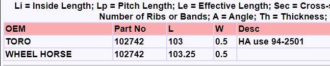

daveoman1966 3,883 #5 Posted May 28, 2022 7 minutes ago, Scott with a C105 said: I really didn't think of that, I'm sure that would cause some major blade speed problems along with the bogging down issue I'm having. Thanks.... I have this pulley if needed. NOTE: the drive belt on the PTO MUST be on the inner 'V' for the deck to work right. The factory OEM belt is 102742 (94-2501 new #) 1 Share this post Link to post Share on other sites
