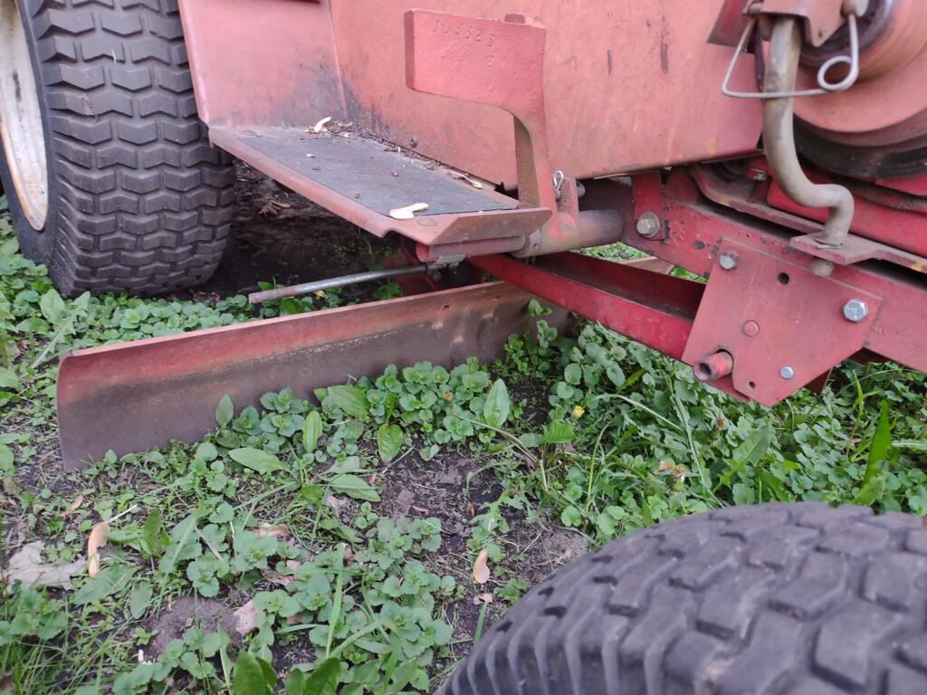

S416-8 399 #1 Posted May 28, 2022 I picked one of these yesterday but now that I have it home, tried to installed it I think I am missing the s bar.. all I got was the blade and mount.. anyone have any experience with these? Share this post Link to post Share on other sites
Achto 32,346 #2 Posted May 28, 2022 10 minutes ago, S416-8 said: anyone have any experience with these? Looks like you have everything that you need. Your lift link maybe wrong, possibly. Mine is strait. 1 Share this post Link to post Share on other sites

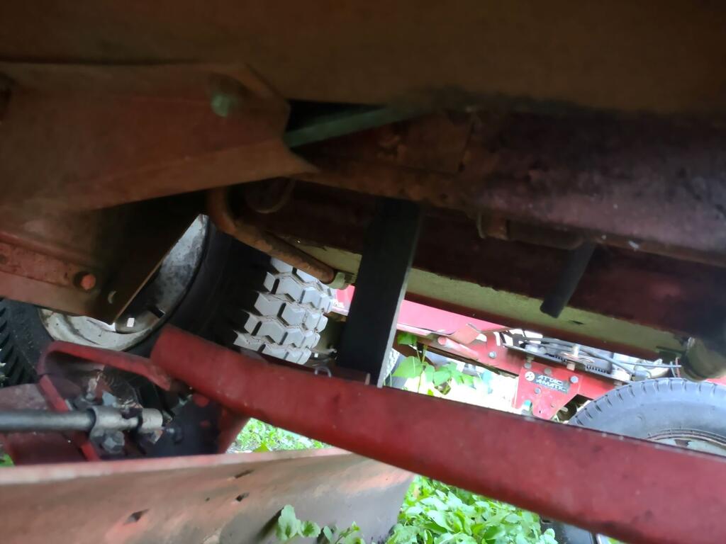

S416-8 399 #3 Posted May 28, 2022 (edited) does it use the same lift bar as the mower? didn't come close to fitting unless I am looking at of wrong? This is what I did not get with mine but I just order one Edited May 28, 2022 by S416-8 Share this post Link to post Share on other sites
Achto 32,346 #4 Posted May 28, 2022 13 minutes ago, S416-8 said: does it use the same lift bar as the mower? No. My lift bar is straight with a distance of 8.5" from pin to pin on center. I actually made mine from a piece of 1/4" x 1" flat stock & some 3/8" round stock. 1 Share this post Link to post Share on other sites
S416-8 399 #5 Posted May 28, 2022 ok that was what I was going to try.. the only steel I could dig up today wouldn't work.. 1 Share this post Link to post Share on other sites

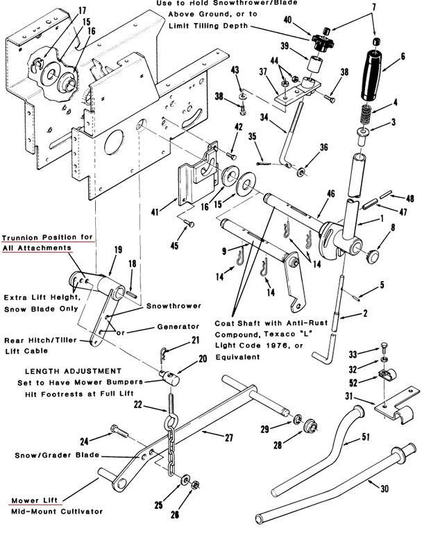

953 nut 68,477 #7 Posted May 28, 2022 Are you attaching it to the rocker shaft (part 19) as shown below? 1 Share this post Link to post Share on other sites
squonk 47,887 #8 Posted May 28, 2022 (edited) Remove the clip # 29. Make sure you pull # 28 bushing out and save it. Remove #'s 20 &21 from #19. #27 now comes out. 5 min . job. Install link in the hole that says all other attachments in #19. Edited May 28, 2022 by squonk 1 Share this post Link to post Share on other sites
S416-8 399 #9 Posted May 31, 2022 Sorry for the delay was playing with the tractor.. thank you. The chain is already installed there but the deck lift is still there so the lift of the grader is restricted a ton. Will work on removing that per your instructions.. thanks a ton this will help a ton Share this post Link to post Share on other sites
S416-8 399 #10 Posted June 1, 2022 thanks for all the help.. with this info the blade is working great and is becoming a BIG part for what I am working on thanks 3 Share this post Link to post Share on other sites
