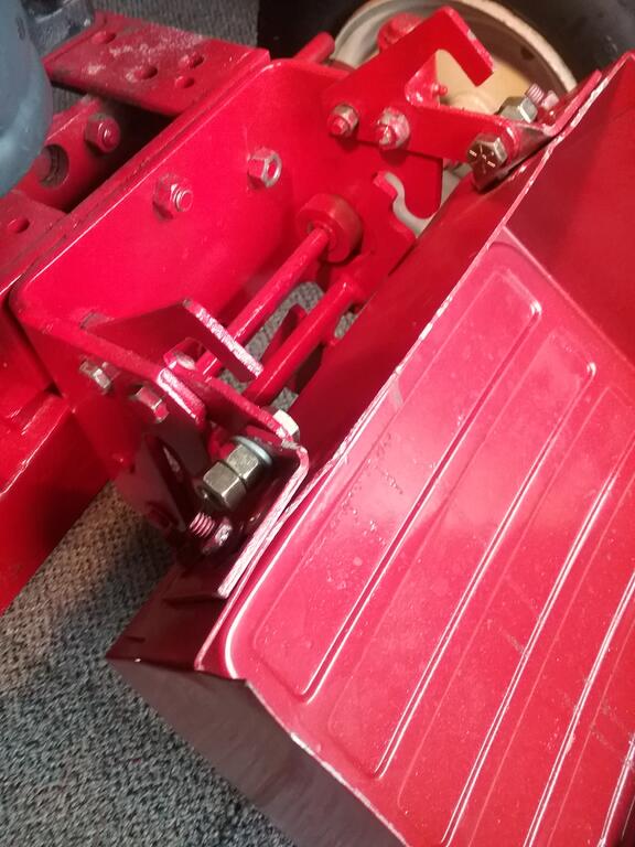

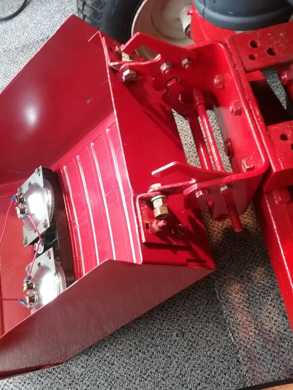

redone 45 #1 Posted May 27, 2022 I 've posted pictures of the two brackets that stop the hood from going to the ground. Someone informed me to bend them down. I 've tried to do this. But these brackets are machined stamp. How is this done Thank you Bill 1 Share this post Link to post Share on other sites

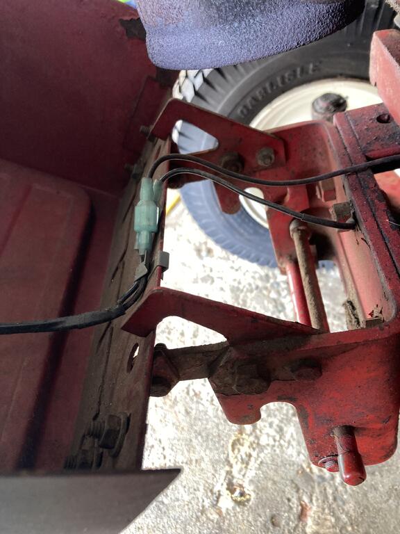

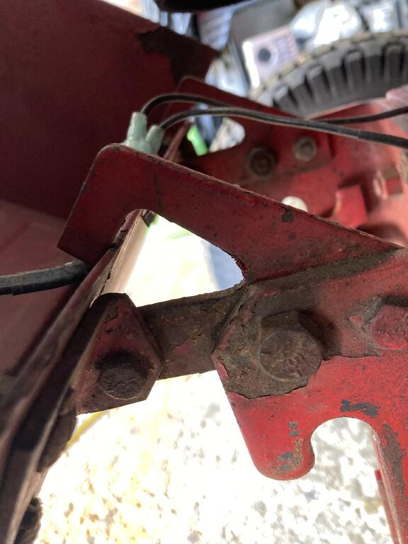

SylvanLakeWH 31,058 #2 Posted May 27, 2022 (edited) Here’s how mine is… I think you need to get the bracket bolted on the hood, with lip of bracket catching it, then bolt to frame… Edited May 27, 2022 by SylvanLakeWH 2 Share this post Link to post Share on other sites
Jeff-C175 7,207 #3 Posted May 27, 2022 (edited) My experience is that those 'arms' are not long enough to properly engage the hood. I've added plates that stick out about a half inch on both of my machines between the hood and the hinge. The plate catches the hinge instead of tearing up the edge of the hood and the hood flopping all the way forward. It is possible to loosen the four bolts and slide the hood back but then it won't line up on the other end at the instrument panel stand. I don't see any way that you could bend something to make it work. You could also weld a little extension onto the stop tab, but that may interfere with the hood. Edited May 27, 2022 by Jeff-C175 2 1 Share this post Link to post Share on other sites

Jeff-C175 7,207 #6 Posted May 31, 2022 33 minutes ago, Lee1977 said: adjustment of the hinge may be all that is needed I thought the same when trying to get mine to work properly, but when I set it to line up at the hood stand, the bolts were all at the end of their travel at the hinge (see photo). It could be that the hood stand is bent forward a little... somehow... 1 Share this post Link to post Share on other sites
Lee1977 7,632 #7 Posted May 31, 2022 3 hours ago, Jeff-C175 said: I thought the same when trying to get mine to work properly, but when I set it to line up at the hood stand, the bolts were all at the end of their travel at the hinge (see photo). It could be that the hood stand is bent forward a little... somehow... That hood stand is in three pieces and bolted together could allow for it to be move some. 2 Share this post Link to post Share on other sites
