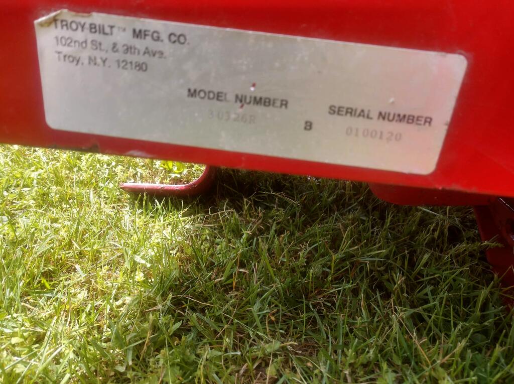

Spottedeventer 3 #1 Posted May 26, 2022 Im looking to find a tiller for my dads old 314-8 which I dearly love. I found this toro tiller which is brand new but am unsure if it would work. Any assistance would be greatly appreciated 1 Share this post Link to post Share on other sites
gwest_ca-(File Mod) 12,451 #2 Posted May 26, 2022 Welcome to the forum. This Troy built model may work but would require a ton of modifications. For plug and play you need one of these 1983-1985 tiller model 07-36TL02 Uses tiller hitch 105543 Rear axle hitch mounts under rear axle First belt guard on front idler assembly to be retained by bolts to a welded-on bracket [Drive belt # 1599 (HA x 139.00in 1/2" x 139") If used on later twin-cylinder models use belt # 103635 which has been replaced by # 110265 (1/2" x 141.00")] 1986-1989 tiller model 07-36TL03 Uses tiller hitch 105543 Rear axle hitch mounts under rear axle [Drive belt # 1599 (HA x 139.00in 1/2" x 139") If used on later twin-cylinder models use belt # 103635 which has been replaced by # 110265 (1/2" x 141.00")] 1990-1991 tiller model 07-36TL04 Uses tiller hitch 105543 Rear axle hitch mounts under rear axle [Drive belt # 103635 which has been replaced by # 110265 (1/2" x 141.00")] 1992 tiller model 07-36TL05 Uses tiller hitch 105543 Rear axle hitch mounts under rear axle [Drive belt # 103635 which has been replaced by # 110265 (1/2" x 141.00")] 1993-2001 2003-2007 tiller model 79370 Rear axle hitch mounts under rear axle [Drive belt # 103635 which has been replaced by # 110265 (1/2" x 141.00")] There are older models that could fit with slight modifications 3 Share this post Link to post Share on other sites
