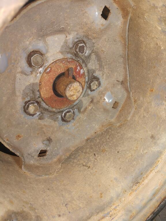

Timman 6 #10 Posted May 25, 2022 51 minutes ago, wallfish said: That idler pulley for the drive belt should have a spring to apply tension to the belt. That's how it drives and clutches. You can simulate that tension by pulling back on the clutch pedal with your toe. The spring should be on the opposite side of the pulley. Near the brake drum Yes thanks I did find that and had it adjusted back so far the clutch was almost on the floorboard. 5 hours ago, squonk said: Make sure your keyways in the hubs and transmission input pulley are ok . And lets see a pic of the belt installed. Might just be too worn out causing the belt to bottom in the pulleys. I think that is the problem .the transmission input key is good but I just realized that the wheel hub key looks to be half out maybe. 4 Share this post Link to post Share on other sites
953 nut 63,068 #11 Posted May 25, 2022 Looks like you found the culprit that was stealing your power to the ground. Hope your hub was not damaged. 1 Share this post Link to post Share on other sites

oliver2-44 11,070 #13 Posted May 26, 2022 The bore of that hub sure looks wallowed out or the axle worn down. Let us know what you find after disassembly 1 Share this post Link to post Share on other sites
wallfish 18,789 #14 Posted May 26, 2022 Looks like the key shaved a nice 45 deg bevel on the inside edge of the hub. 3 Share this post Link to post Share on other sites
Handy Don 15,220 #15 Posted May 26, 2022 Normally the axle should be flush with the outside of the hub. You'll want to check for damage if the slid-in hub has been rubbing against the transaxle case. 1 Share this post Link to post Share on other sites

wallfish 18,789 #21 Posted May 26, 2022 1 hour ago, stevasaurus said: I hate to say this, but after 4 days of looking, you did not see this?? It appears like whoever painted the wheels didn't notice it. The end of the axle looks painted and it looks like the key too but it's a pic so that might all just be rust. 1 Share this post Link to post Share on other sites
