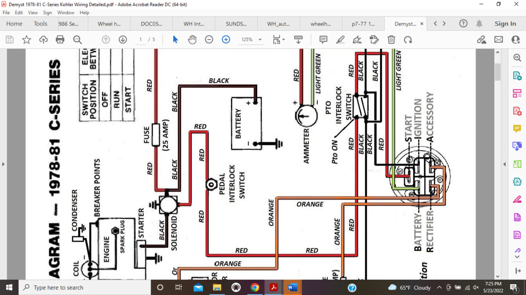

gwest_ca-(File Mod) 11,743 #7 Posted May 23, 2022 Early C-125's use a pto switch with 4 wires. Two control the ignition and the other two control the starter through the clutch pedal switch to the starter solenoid. Late models use a 2-wire pto switch that powers the ignition switch with pto OFF. When the pto is ON the seat switch powers the ignition switch. No battery power directly to the ignition switch like we normally see. The ignition switch powers the neutral/clutch pedal switch and then to the starter solenoid. Pto must be OFF or operator must be in the seat to have power at the ignition switch. 2 1 Share this post Link to post Share on other sites

953 nut 62,177 #9 Posted May 23, 2022 4 hours ago, Jrblanke said: when I turn the key, nothing happens. I’ve had it running before. I am getting 12 volts to the coil, but when I turn the key to the start position, I don’t get any volts at the starter. James, since you have 12 volts at the coil with the key on the problem is at or beyond the ignition switch. There should be a red wire from the "S" terminal of your ignition switch to the PTO switch then to the clutch switch and ending on the small terminal of your starter solenoid. With the transmission in neutral, take a small jumper from the battery "+" terminal to the small terminal on the starter solenoid where the red wire goes. At the very least you should get a click from the solenoid. If the starter turns over then do an inspection of the wires along the path from the ignition switch to solenoid. Make sure they have good tight connections and the wires are good. You can put a temporary jumper from the goes in to the goes out side of each safety switch along the red wire to see if the switch is the problem. The attached drawing should help. If you have an engine Spec. number that could help us know for sure what year it is. 1 1 Share this post Link to post Share on other sites

Jrblanke 918 #14 Posted May 24, 2022 11 hours ago, 953 nut said: James, since you have 12 volts at the coil with the key on the problem is at or beyond the ignition switch. There should be a red wire from the "S" terminal of your ignition switch to the PTO switch then to the clutch switch and ending on the small terminal of your starter solenoid. With the transmission in neutral, take a small jumper from the battery "+" terminal to the small terminal on the starter solenoid where the red wire goes. At the very least you should get a click from the solenoid. If the starter turns over then do an inspection of the wires along the path from the ignition switch to solenoid. Make sure they have good tight connections and the wires are good. You can put a temporary jumper from the goes in to the goes out side of each safety switch along the red wire to see if the switch is the problem. The attached drawing should help. If you have an engine Spec. number that could help us know for sure what year it is. Thanks for the write up! And thanks to everyone for pointing me in the right direction. The rain is suposed to let up tonight, so I hope to make some progress very soon. I'll also report back on the spec number. 1 Share this post Link to post Share on other sites
Jrblanke 918 #15 Posted May 25, 2022 Well boys and girls, here is the update. I changed the drive belt last week, and when I loosened the pulley, the little tab that depresses the PTO switch moved enough that it did not engage the safety switch. D'oh! Thanks for all the help guys! 2 1 Share this post Link to post Share on other sites
