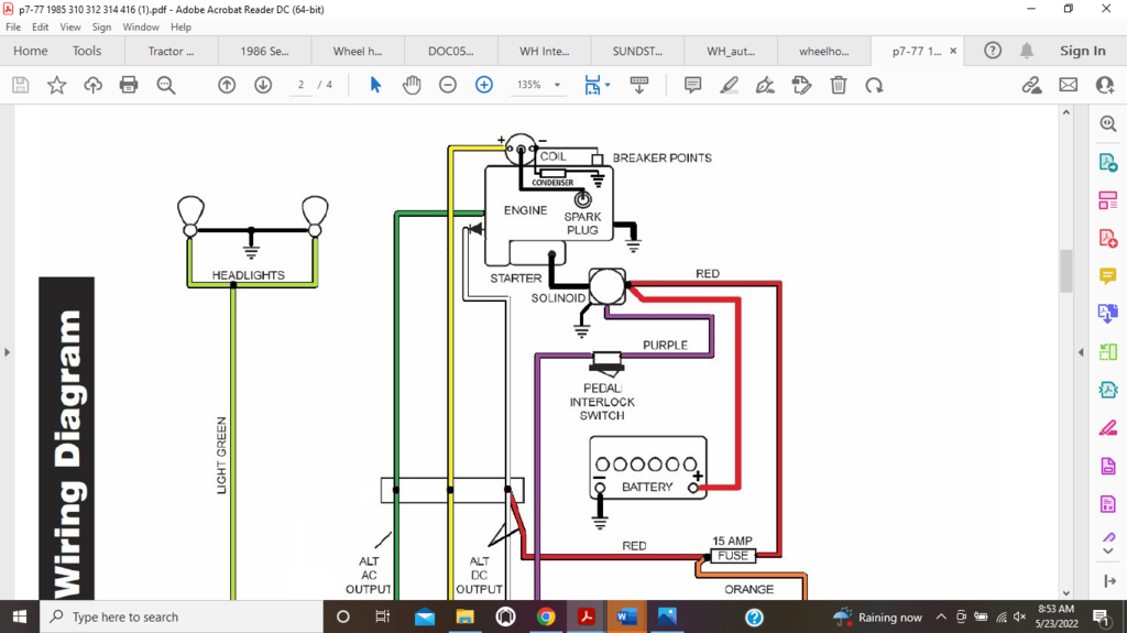

953 nut 63,000 #8 Posted May 23, 2022 That is a good number. You have a 1985 312 with a K-301 engine. The attached wiring drawing shows a little arrow like thing next to the engine connected to a white wire, that is the Diode. There will be a little lump under some tape on the wire near the engine block, the diode is under the tape. Perhaps @gwest_ca can tell us where a replacement diode can be obtained. You will need to solder the new one in place of the old one, engine vibration would too much for a mechanical connection. 1 Share this post Link to post Share on other sites
