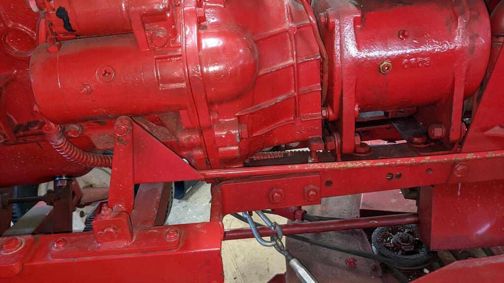

Randy_in_Ohio 99 #39 Posted May 30, 2022 I've tried to identify that gear box but I'm having trouble. It's stamped with "CK03". I'm thinking that it's off of a tractor? I still have a couple things to figure out... like what the vacuum hose coming off the distributer does. I think it needs to plug into a hole in the carb... some sort of throttle regulator? Both gearboxes appear to be full of clean oil. Not sure what kind of oil would go in that 90 degree box but I'll probably change it out once i figure out what it is. 1 Share this post Link to post Share on other sites

Randy_in_Ohio 99 #43 Posted May 30, 2022 5 hours ago, Handy Don said: Vacuum on the distributor likely advances the timing as the engine goes to higher revs (retarded timing allows for easier starts). This is the same idea as the Kohler system on smaller K series engines which used centrifugal force. Should be a port for it on the carb. Yep! Thanks Don. I found the port just need to figure out a fitting to put in there. I may have to tap it out. Probably explains the erratic throttle response. I was thinking today.... no one asked about the brakes! Factory Wheelhorse if you're wondering...but they look like they have new pad anyway 2 Share this post Link to post Share on other sites

Blasterdad 3,168 #46 Posted May 31, 2022 8 hours ago, Randy_in_Ohio said: I still have a couple things to figure out... like what the vacuum hose coming off the distributor does. I think it needs to plug into a hole in the carb... If you can find out which carb was originally on that motor you should be able to figure out if the vacuum advance on the distributor uses ported or manifold vacuum. Manifold vacuum is rare but some engines did use it. Not sure if you could make ported vacuum work with that Kohler carb... 1 Share this post Link to post Share on other sites

Randy_in_Ohio 99 #49 Posted May 31, 2022 16 hours ago, Blasterdad said: If you can find out which carb was originally on that motor you should be able to figure out if the vacuum advance on the distributor uses ported or manifold vacuum. Manifold vacuum is rare but some engines did use it. Not sure if you could make ported vacuum work with that Kohler carb... The original carb had a hole in it for the vacuum advance... this Kohler carb does not. Thought it did at first, but when I looked into the hole it doesn't go anywhere. Not sure what to do with this hose! Cap it? Leave it? Haven't had much time to look into the gearbox, I'll look some more tonight. Going to look for some more numbers on it. Didn't look under it yet. 1 Share this post Link to post Share on other sites
ebinmaine 81,289 #50 Posted May 31, 2022 3 minutes ago, Randy_in_Ohio said: The original carb had a hole in it for the vacuum advance... this Kohler carb does not. Thought it did at first, but when I looked into the hole it doesn't go anywhere. Not sure what to do with this hose! Cap it? Leave it? Haven't had much time to look into the gearbox, I'll look some more tonight. Going to look for some more numbers on it. Didn't look under it yet. I'd plug it on the off chance a mud dauber might want to make a nest in there leave it set for now considering there's no place to plug it in. 4 Share this post Link to post Share on other sites
