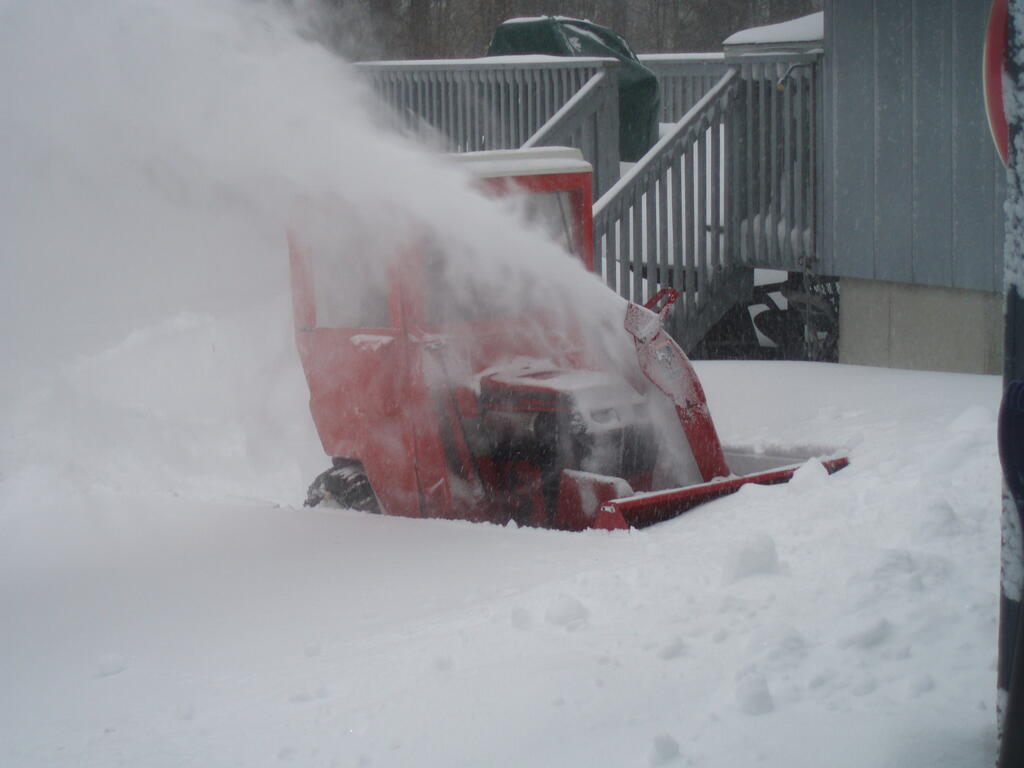

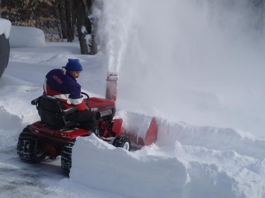

JCM 10,025 #50 Posted May 29, 2022 On 5/21/2022 at 7:13 AM, S416-8 said: GM and I am a red tractor addict. There admitted it so I can now justify the bid that I put on a 520-H before I even have my 416 ? Now that you have an interest in 520's, hooked up to a 2 stage 44'' blower with a hydro is hard to beat when the going gets tough. Depending on where you live. 5 1 Share this post Link to post Share on other sites
