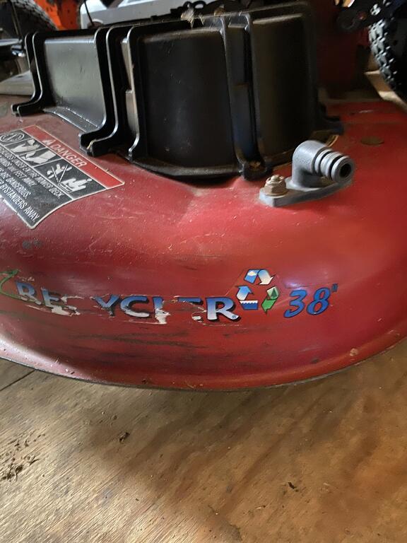

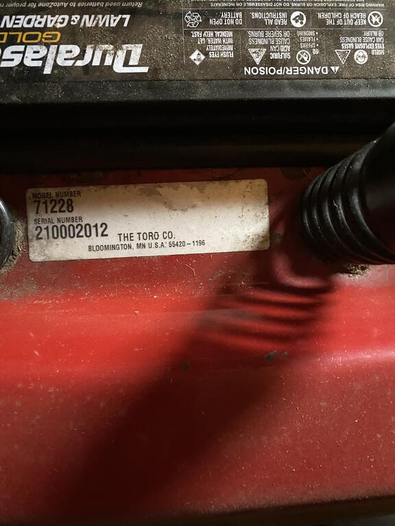

Dallen 1 #8 Posted May 20, 2022 (edited) Sorry for the delay in the reply I was at work and figured it’d be easier to post when I had a pic of the serial number . Thanks everyone for getting back. The deck has a “recycler 38” decal on it but it does indeed have 3 blades. So here it is! Edited May 20, 2022 by Dallen Share this post Link to post Share on other sites
gwest_ca-(File Mod) 12,510 #9 Posted May 20, 2022 Still can not find a 38" 3-blade deck. The ID decal is for a 2001 model 17-44HXL tractor with the 44 being the deck width of cut. Can you find a similar ID decal on the deck? Share this post Link to post Share on other sites
Dallen 1 #10 Posted May 20, 2022 I was unable to locate any sticker with numbers on the deck itself. I did measure with a tape and it is 44” across the back. Share this post Link to post Share on other sites
gwest_ca-(File Mod) 12,510 #11 Posted May 20, 2022 The mower deck that came on the model 71228 tractor was a model 79108. The 79102 posted above is the correct bagger for this deck. The mower blades used with the vacuum are different. Share this post Link to post Share on other sites
