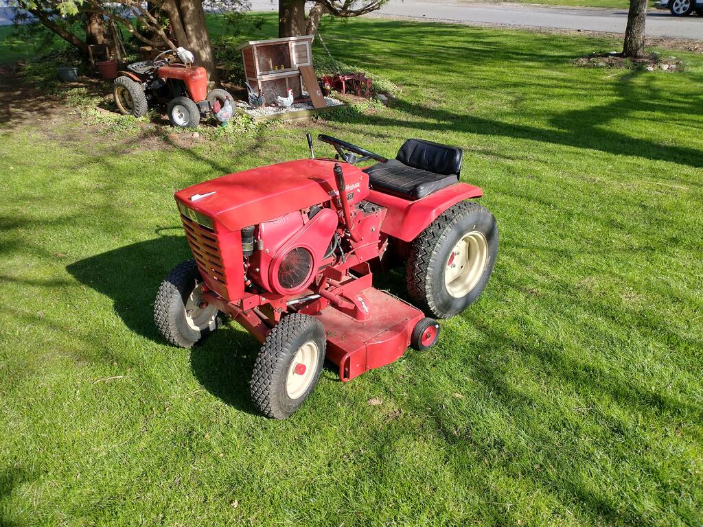

squonk 48,215 #2 Posted May 17, 2022 I don't know of any "belt on the deck" mowers that will fit under a short frame tractor. One thing to note is the difference between the mid hitch and mounting the front mule is different on a shortie and a long frame tractor. I also think say a 42"SD deck will interfere with the wheels when turning. The older gear drive decks give a great cut when the blades are in good condition. Finding a quiet one can be a challenge. I searched for years. I finally got a pretty quiet one but it still rattled until I put some brand new blades on it that I found here in the classifieds. Now I can hardly tell it's running! If you have to go with the gear drive deck and you are going to use it all the time, I suggest looking for some parts decks to stockpile parts. The gears and the jack shaft bearing and stantions are wear items. If you're going to work on one of these decks, get lots of rags This is how my lawn looks after a fresh GD cut. 4 1 1 Share this post Link to post Share on other sites

squonk 48,215 #4 Posted May 17, 2022 (edited) 34 minutes ago, clueless said: Mike you know which model deck is on Little Red? It's been a long time Chris. I had more than one deck on it too. I know at one time there was an RM 324 on it. Shoot a pic of it if you can. That's an RM-363 in the 1075 in my pic. Edited May 17, 2022 by squonk 1 1 Share this post Link to post Share on other sites
