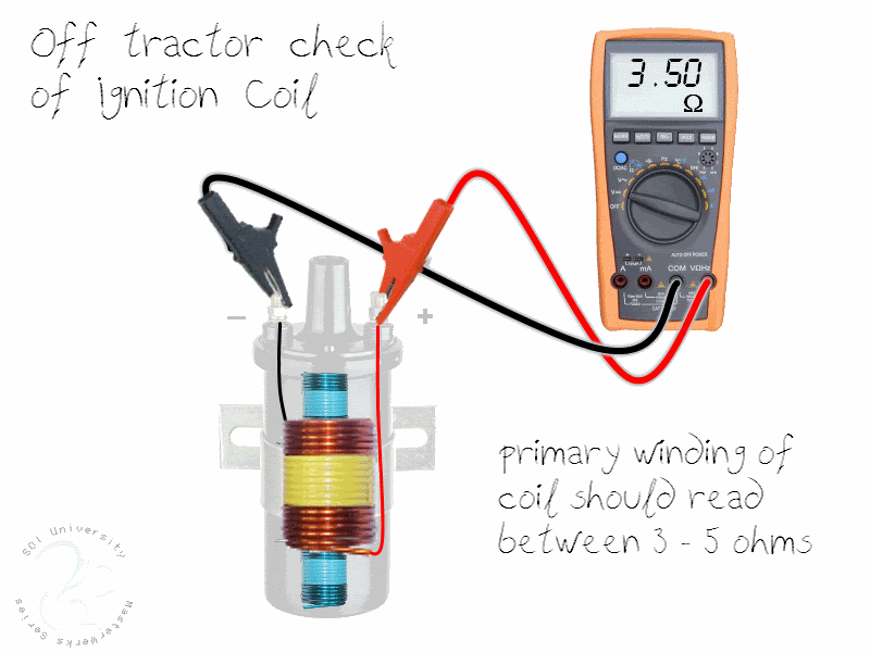

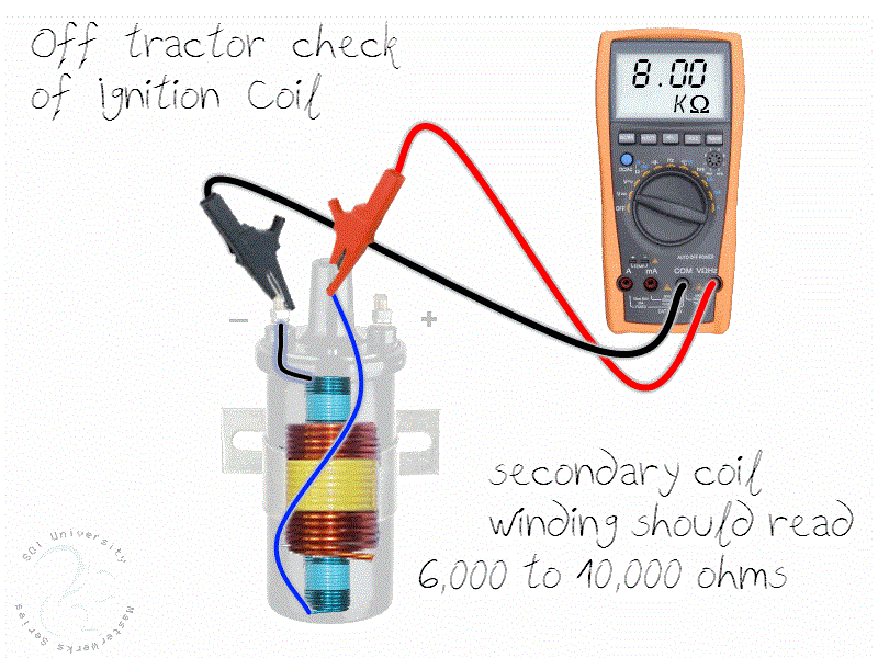

953 nut 68,157 #4 Posted May 15, 2022 48 minutes ago, MGW said: I think my coil went out Presuming your has a battery ignition system here is the test for a coil. 1 Share this post Link to post Share on other sites
