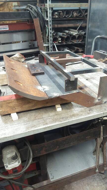

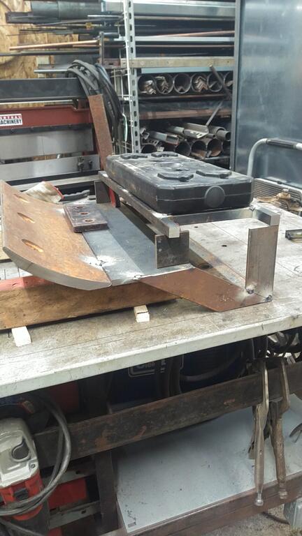

JPWH 6,544 #1 Posted May 14, 2022 I have been grinding an edge on the scrape blade I was given. It has been slow progress but getting there. I grind a while then let it cool down. While it is cooling I have been cutting metal and tacking the pieces together. This is what I have so far. 7 3 Share this post Link to post Share on other sites
sjoemie himself 3,106 #2 Posted May 14, 2022 Looking good so far. I'll be keeping an eye on this build. For my understanding.. this doesn't have any moving parts? I mean like a side to side movement of the blade? Also what is the purpose of cutting sod like this? Is it to harvest sod to replant it or to clear a piece of land from sod so that it can be tilled and turned into a garden? 3 1 Share this post Link to post Share on other sites
JPWH 6,544 #3 Posted May 14, 2022 50 minutes ago, sjoemie himself said: For my understanding.. this doesn't have any moving parts? I mean like a side to side movement of the blade? Also what is the purpose of cutting sod like this? There is no moving parts. I need to remove sod from one area and replant to another location. I also need to remove some sod, change the grade, then replace the sod to new grade. 3 1 Share this post Link to post Share on other sites

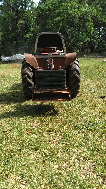

JPWH 6,544 #13 Posted May 14, 2022 1 hour ago, WHX?? said: What tractor are you going to use it on Hank? 953 with 3 pt would be my guess. Thinking controlling the depth would be critical? You have a good guess Jim. I have a built in depth control with the skid plate. What I don't know yet is if the hydraulics will or if I will need to use weight. I'm building it to go either way 4 Share this post Link to post Share on other sites

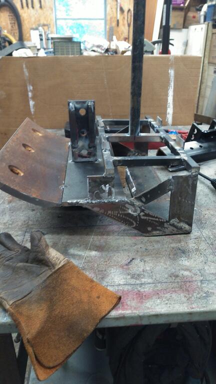

JPWH 6,544 #15 Posted May 14, 2022 I just have a few more welds to make. We have St. Augustine grass and I have dug some up by hand but now I want to remove more than I'm interested in doing by hand. If I get home in time this afternoon I will find out if it will work or not. 5 Share this post Link to post Share on other sites

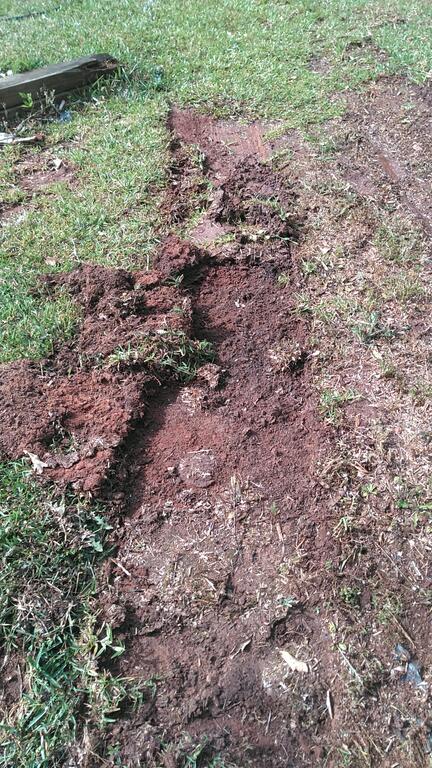

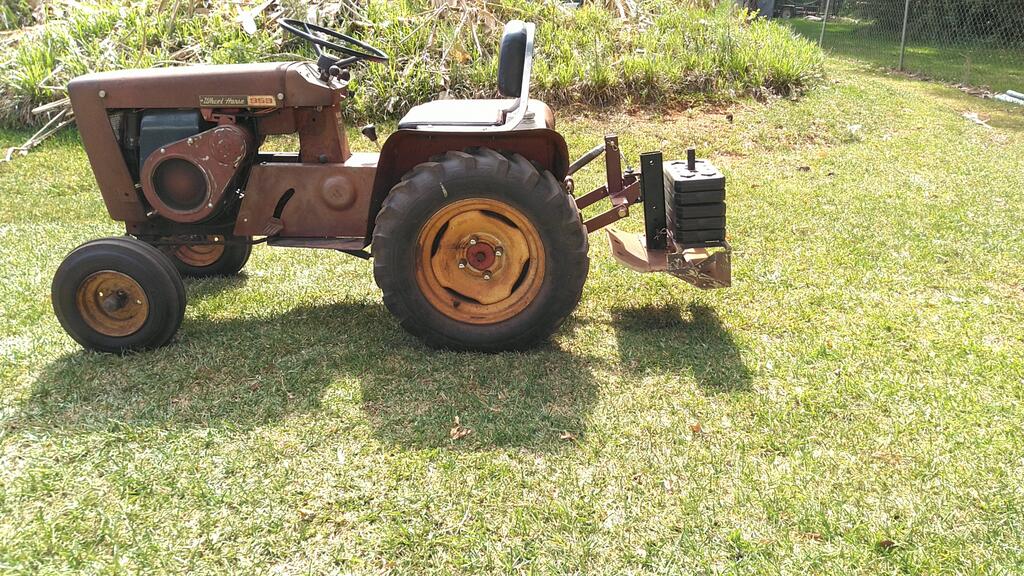

JPWH 6,544 #16 Posted May 14, 2022 Finished the Sod Cutter today all but paint. I did try it. Not so good in dry red clay. I broke out the sprinkler and after about 30 min. Still too dry but good results. 6 Share this post Link to post Share on other sites
JPWH 6,544 #17 Posted May 17, 2022 The test run did pretty well but when I tried to use it after watering the area good it did not work well in the thick grass. I tried adjusting the top link to increase the blade angle. It did better but reduced the depth of the cut too much. I took it to the table in the exam room and after analyzing the design I have decided to do some reconstructive surgery. Plan B to start soon. 3 Share this post Link to post Share on other sites

JPWH 6,544 #20 Posted May 21, 2022 After rebuilding the cylinder the pump started leaking. Not real bad but leaks down when loaded. I ordered another pump so I can have a spare while I tear this one down and rebuild it. I removed the cutting blade and cut it down to 2" wide from 3 1/2" wide and reinstalled it with the cutting edge angled down. I tested it and it does try to cut as it should but the red clay is too dry and hard. Rain is coming so I will be able to test it with more favorable conditions. 5 Share this post Link to post Share on other sites
