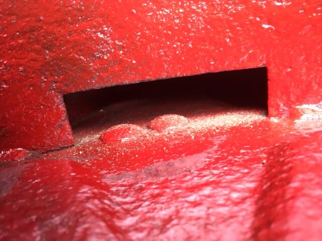

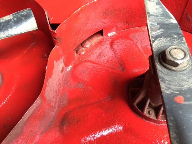

Bill Winn 157 #1 Posted May 13, 2022 I just finished repairing my 05-42MR01 mower deck. I repaired the stress cracks and welded reinforcement plates over those areas. While I was cleaning off the underside I noticed that there are two large voids, one on either side, and they were FULL of crud and corruption. It seems like a great way for the deck to collect debris and hold moisture thereby causing rust and rot. Does anyone know what these voids are for and why there are slots/ vents that leave them exposed? Bill Share this post Link to post Share on other sites
WHX?? 57,795 #2 Posted May 13, 2022 Are those carriage bolts there? The slot might be so as to get them in and out. 1 1 Share this post Link to post Share on other sites
Bill Winn 157 #3 Posted May 13, 2022 6 minutes ago, WHX?? said: Are those carriage bolts there? The slot might be so as to get them in and out. Okay, duh, I guess I over looked that for sure. I bet you're right. I might then say that there's a planning error in the design. lol Share this post Link to post Share on other sites
8ntruck 9,216 #4 Posted May 13, 2022 Assembly ease was probably the overriding design decision factor. They probably didn't expect them to last this long.... 2 Share this post Link to post Share on other sites
