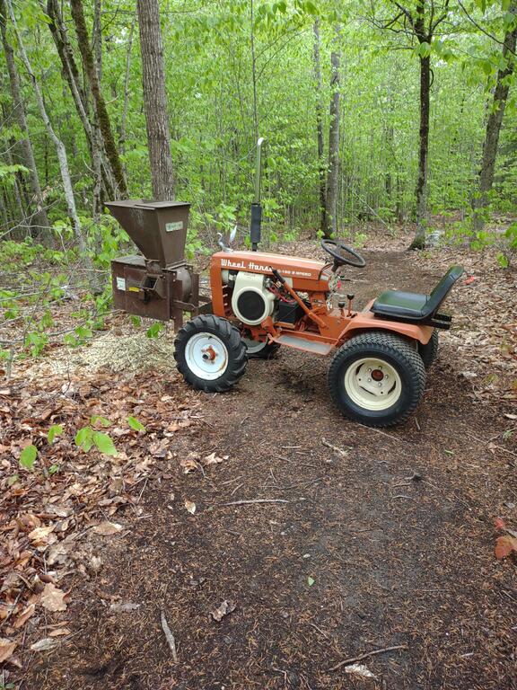

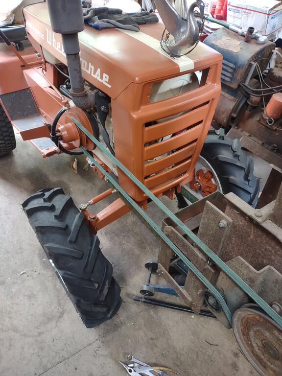

ebinmaine 76,150 #39 Posted May 15, 2022 Well folks I started addressing this beast again today. I tightened up one of the LH mounting bolts and replaced the other. Lifted the front of the machine a little with the floor jack and adjusted the belt tensioner pulley as tight as I could get it with my own lifting strength. @JoeM I think it was you mentioned about an inch of deflection in this belt. It's an 86" belt so there's 43" minus pulley diameters for flex. It's a pretty fair 1" I'd say. Took it out for a shakedown. Definitely better operating. I'll get some time on it and see how the belt wears. Ignore, wrong name: @Joe M 4 Share this post Link to post Share on other sites
JoeM 9,334 #40 Posted May 15, 2022 sure looks like it should run okay. 2 Share this post Link to post Share on other sites

ebinmaine 76,150 #42 Posted May 15, 2022 1 hour ago, JoeM said: sure looks like it should run okay. Thanks. Them big tires make a Huge difference in capability of movement through the forest. The belt is... Better. I tightened it up for all I could lift. Deflection is certainly less. I won't know if I've solved it til I get some run time. Share this post Link to post Share on other sites
