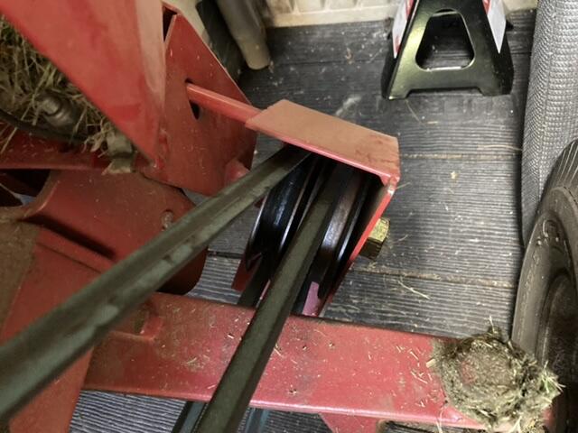

Craig-906 28 #1 Posted May 11, 2022 I have a 312-8 w/42" deck that really only allows me to mow in first gear. The lawn isn't overgrown. When I try to mow in 2nd gear the deck slows right down to where you can see the spindles slow down and hear it, while the engine doesn't bog. I have replaced the belts on the deck, and the pto to power the deck (its on the inside pully), drive belt will be next to be replaced. The attach-o-matic is real tight, so its not slipping there. Is there an adjustment on the deck I do not see? Blades are sharpened. I'm at a loss, seem to point to either poor tension on the deck itself, or wrong brand/type of belts (tractor supply v belts (husky). What am I missing? Share this post Link to post Share on other sites
Darb1964 1,174 #2 Posted May 11, 2022 Check your mule drive for worn out parts and that the spacers are there. Share this post Link to post Share on other sites

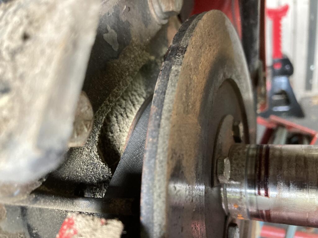

Craig-906 28 #4 Posted May 11, 2022 3 hours ago, Darb1964 said: Check your mule drive for worn out parts and that the spacers are there. Seems ok? Share this post Link to post Share on other sites

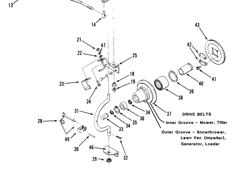

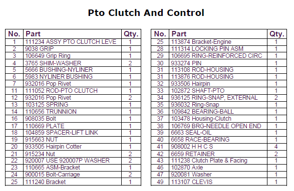

8ntruck 9,338 #9 Posted May 12, 2022 34 or 35. There is a snap ring on both sides of #36 ball bearing. If the external one is loose, broken, or missing, #31 won't be pushing on the pulley to engage the clutch. Share this post Link to post Share on other sites
Handy Don 17,562 #10 Posted May 12, 2022 Two trains of thought going at the same time. @8ntruck is asking you to make sure that when you engage the PTO, the pulley/bell/clutch are all pushing toward the engine with the proper force and, therefore, driving the PTO belt properly. That is what my suggestion for heat was about as well. If the bell is turning but not with sufficient force, it will slip (and get hot from the friction) where it is being pressed against the engine and not deliver power to the deck. The most common causes of insufficient tension are a poorly adjusted rod (#31), trunnion (#13 and #14), or a failed snap ring (#34 or #35). Is the PTO turning at the same speed as the engine, even when the deck is bogging down? Share this post Link to post Share on other sites
8ntruck 9,338 #11 Posted May 12, 2022 I just realized that I did not give the back story on my advice to check that 'C' clip. I guess it was last spring and the 42" RD deck was bogging down in taller grass - just like @Craig-906 is describing. The treunion (#14 in the diagram) on the PTO rod was already threaded all the way onto the adjustment threads, leading me to think the clutch lining was worn out. While installing the new clutch lining, I discovered the outside 'C' clip out of place on the stub shaft. Installing a new 'C' clip restored proper PTO operation, without installing the new clutch lining. 2 Share this post Link to post Share on other sites
Darb1964 1,174 #12 Posted May 14, 2022 On 5/11/2022 at 12:37 PM, Craig-906 said: Seems ok? Hard to tell but it does look like it may be rubbing on the bottom guide pulley. It's possible to over tighten the nut especially if the spacer is missing. Many years ago I had that problem, heats up and expands as you cut. Took me a while to figure it out. 1 Share this post Link to post Share on other sites

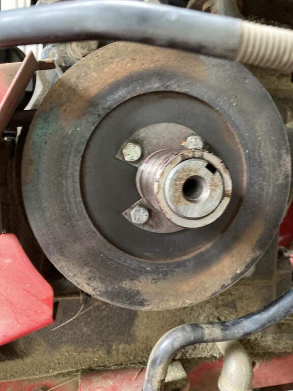

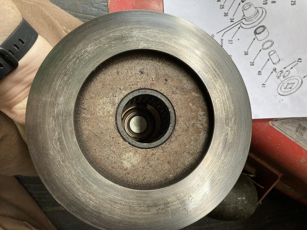

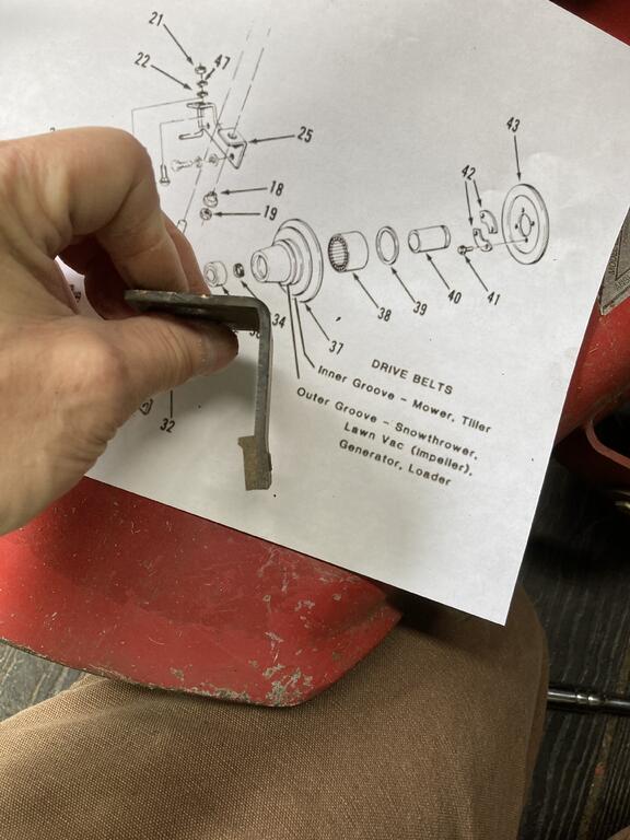

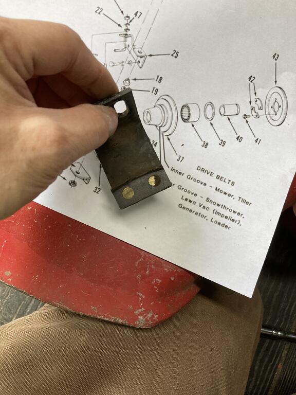

Craig-906 28 #13 Posted May 26, 2022 So I finally had time to look at this and take it apart. Worn PTO brake. Clutch housing, seems all parts are present. Is the clutch plate worn out? 1 Share this post Link to post Share on other sites

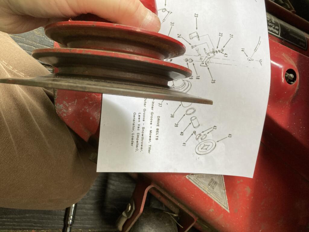

8ntruck 9,338 #14 Posted May 27, 2022 The clutch lining looks OK. What is it, about 1/8" thick? Is the clutch lining plate flat? Is the clutch surface of the PTO bell flat? This can be checked with a straight edge. On the stub shaft in the palm of your hand in the pictures have a C clips on both sides of the bearing it goes through seated properly in their grooves? Any slop in the linkage between the PTO and the PTO clutch lever? 1 Share this post Link to post Share on other sites
Handy Don 17,562 #15 Posted May 27, 2022 7 hours ago, Craig-906 said: Clutch housing, seems all parts are present. Is the clutch plate worn out? The engine-side disk is far from worn out, there is plenty of material. From its wear pattern, however, it seems much more like it is meshing poorly with the PTO side disk in only a few places--less than half of its surface. Clearly, it is not able to transmit full force to the deck this way. As noted above, are both of these plates flat? It looks to me like the engine-side plate is not flat. Is the PTO engagement linkage really putting enough pressure on the clutch? See above suggestions. I would also make sure to sand off that engine side disk to remove any contamination or crud that is on the face, especially in the places that look worn. 1 Share this post Link to post Share on other sites
8ntruck 9,338 #16 Posted May 27, 2022 A couple more thoughts - are the four bolts holding the clutch plate all tight? Pull the clutch plate off and check to make sure the mounting surface is clean? 1 Share this post Link to post Share on other sites

Craig-906 28 #18 Posted May 27, 2022 9 hours ago, 8ntruck said: The clutch lining looks OK. What is it, about 1/8" thick? Is the clutch lining plate flat? Is the clutch surface of the PTO bell flat? This can be checked with a straight edge. On the stub shaft in the palm of your hand in the pictures have a C clips on both sides of the bearing it goes through seated properly in their grooves? Any slop in the linkage between the PTO and the PTO clutch lever? A good 1/8th on it. I'll check both for even plane. Both c clips are seated and not broken. Share this post Link to post Share on other sites
Craig-906 28 #19 Posted May 27, 2022 8 hours ago, Handy Don said: As noted above, are both of these plates flat? It looks to me like the engine-side plate is not flat. Is the PTO engagement linkage really putting enough pressure on the clutch? See above suggestions. I would also make sure to sand off that engine side disk to remove any contamination or crud that is on the face, especially in the places that look worn. Going to check plane on both sides. The trunnion is about as tight as I can make it without bending the linkage when engaged. I'll sane the engine side disk and see how it goes. Share this post Link to post Share on other sites
Craig-906 28 #20 Posted May 27, 2022 6 hours ago, 8ntruck said: A couple more thoughts - are the four bolts holding the clutch plate all tight? Pull the clutch plate off and check to make sure the mounting surface is clean? I will check these when I check the plane. Share this post Link to post Share on other sites
