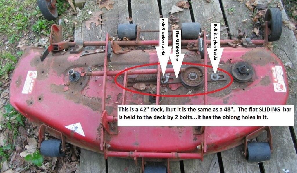

daveoman1966 3,884 #10 Posted May 11, 2022 (1) Is the deck mounted properly? See the fork in tthis schematic...that is critical. (2) Proper tension on the PTO belt to deck...should deflect about 1/2" to 3/4" midway of PTO to Front Mule drive. (3) Check the FLOATING deck flat bar with the idler pulley on it...This flat bar MUST FOLAT..(42 & 48 deck are same). 1 Share this post Link to post Share on other sites
